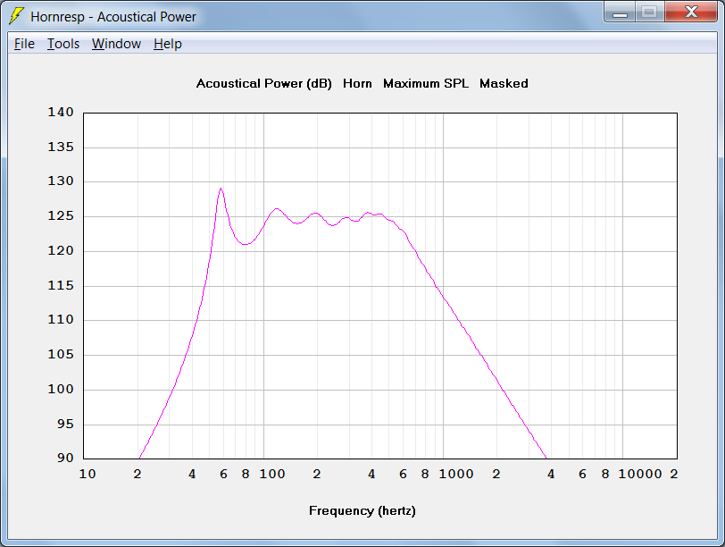

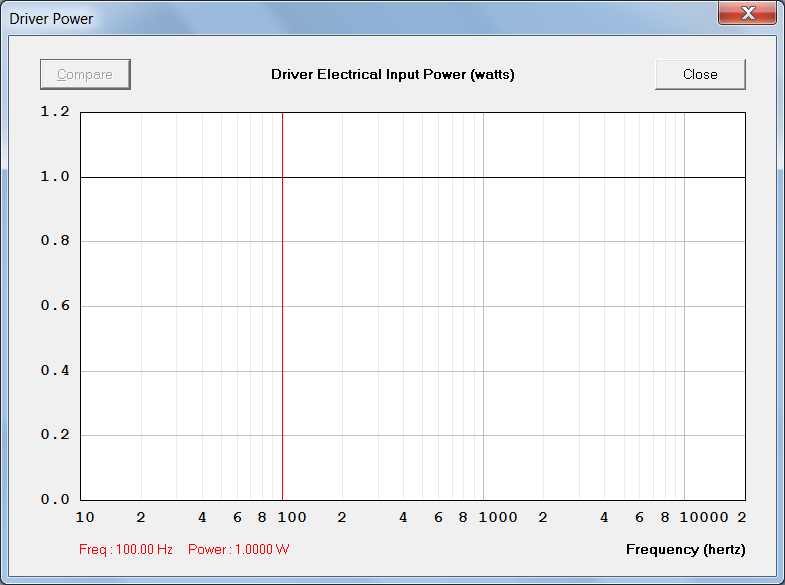

If however you looked at the model using constant power rather than constant voltage, the resulting SPL response will definitely not be flat.
For the default record:
Attachment 1 shows the constant voltage (2.83V) response.
Attachment 2 shows the constant power (1W) response.
Attachment 3 shows the constant current (1A) response.
due to the varying impedance through the passband, the calculated wattage will also vary across the passband.
Because a constant power source is being used, the wattage stays the same regardless of the varying impedance, as shown in Attachment 4. The input current and voltage will however vary.
I = (P / Z) ^ 0.5 amps
V = (P * Z) ^ 0.5 volts
Where P is constant and Z is varying.
Hornresp's models default to modeling with a constant voltage source, "Eg". I'm not aware of an option that allows one to model with a constant power source.
As indicated in Post #12482, the Maximum SPL tool can be used to specify a constant power source. A constant current source can be specified instead if required, as shown in Attachment 3.

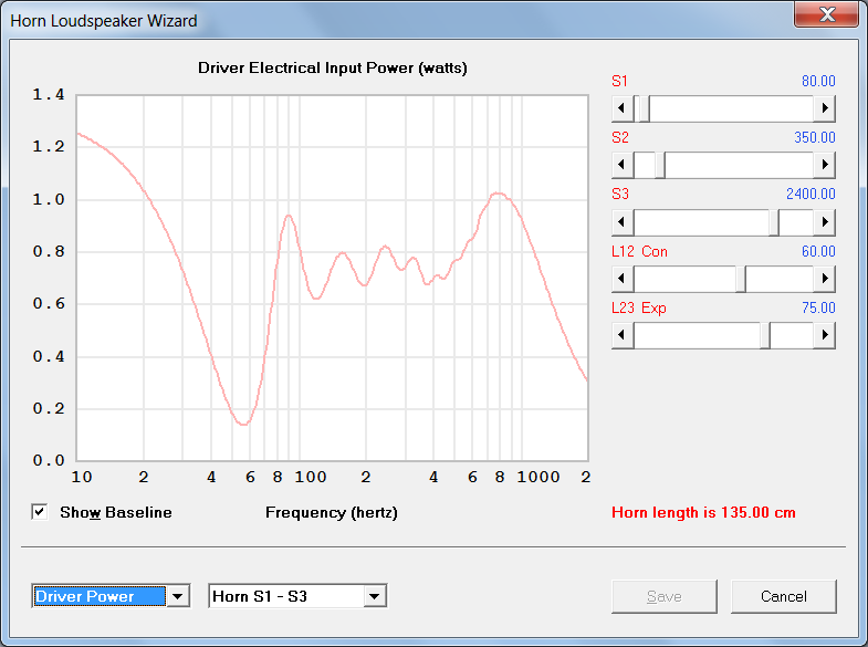

A driver electrical input power chart has been added to the Loudspeaker Wizard. In a multiple driver system the power delivered to each driver is shown, rather than the total power delivered to all drivers. Attachment 1 refers.

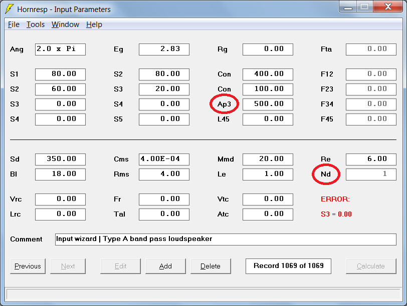

An unintended consequence of fixing Bug 1 in Post #12452 was that it became possible to select the Loudspeaker Wizard from the default record, leading to a fatal error when the Wizard was closed. Attachments 2 and 3 refer. The Loudspeaker Wizard can no longer be selected from the default record.

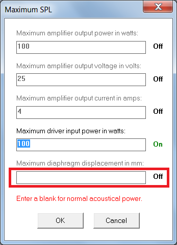

The value of an input field in the Maximum SPL tool that did not have the focus became invisible when the parameter was switched from On to Off. Attachment 4 refers. This is no longer the case. The field is disabled but the existing value now remains visible.

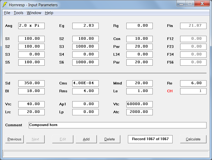

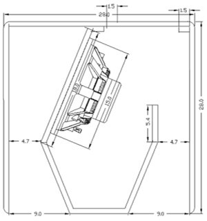

You could perhaps try modelling the design as a compound horn.
Attachment 1:
Use Vrc and Lrc to specify the blue chamber.
Use Vtc and Atc to specify the green chamber (exclude driver volume).
Use segments 1 and 2 to specify the purple port.
Use segment 4 to specify the red port.
Because two sides of the ports are sloping and two (the top and bottom) are parallel, segments 2 and 4 should have Par (parabolic) flares.
Attachments 2 and 3 show an example of the basic design (not to scale).

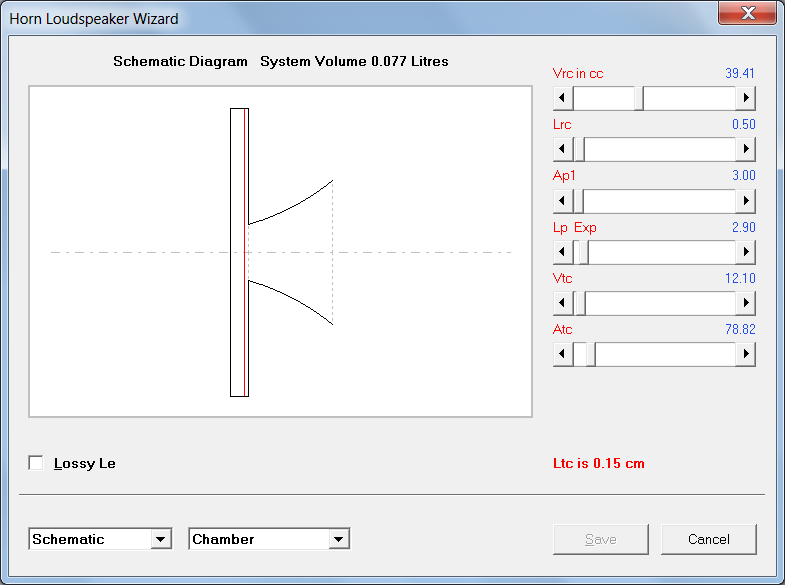

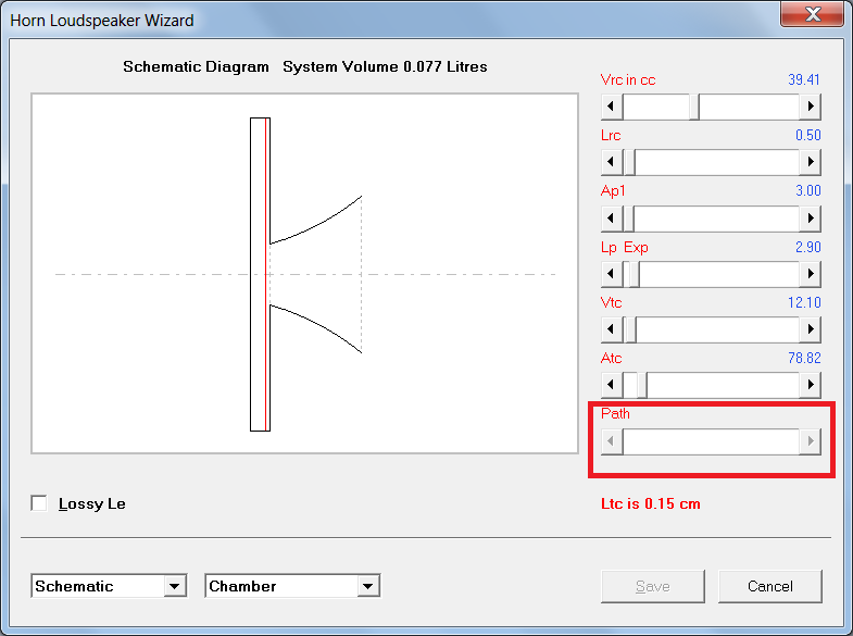

In some cases the Path slider was being included in the Loudspeaker Wizard even when there was just a single sound output. The Path slider is now only included when there are multiple sound outputs. Attachments 1 and 2 refer.
BUG FIX
The Ap3 label was not being removed when the loudspeaker type was changed from BPA to Nd. This has now been fixed. Attachments 3 and 4 refer.
