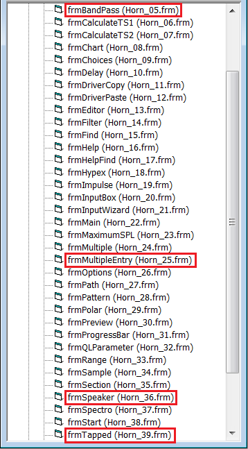

If you are referring to the loudspeaker wizards, then Hornresp uses four different forms - the names are highlighted in the attachment.
The filter wizard also has its own form - frmFilter (Horn_14.frm).

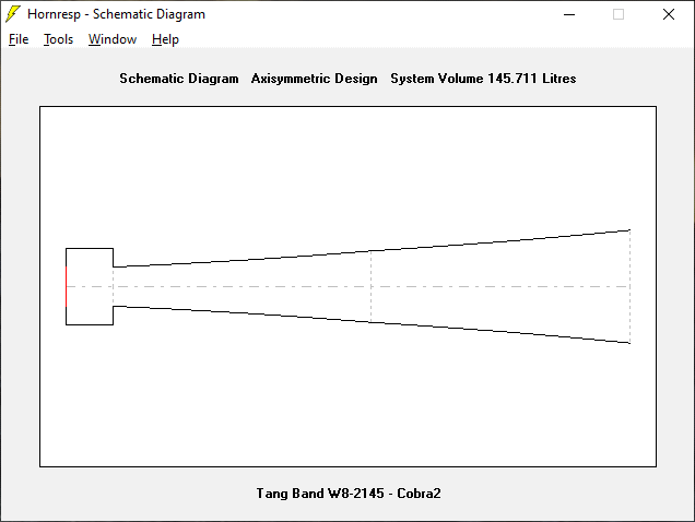

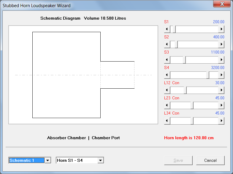

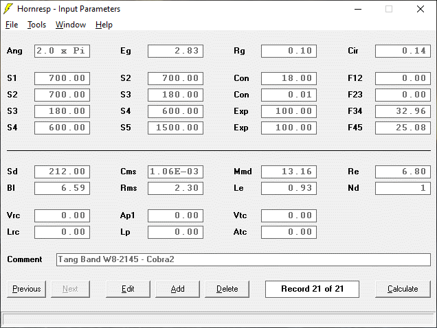

Hello,
I just started playing with Hornresp and I find it a great and powerful simulation software, congratulations David, very well done !
I tried simulating the Cobra2 BL horn cabinet, but it has a chamber with an additional absorber chamber with a small vent.
Here are some more pics.
Does anyone have an idea how to simulate this additional absorber chamber ?
So far I've incorporated the volume of the absorber chamber in the normal chamber.
Danny

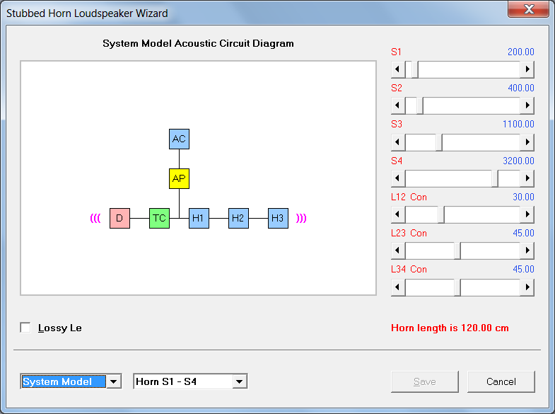

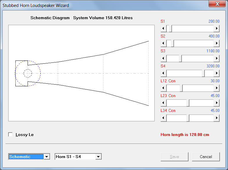

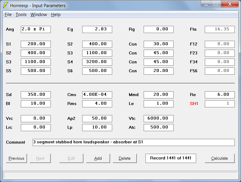

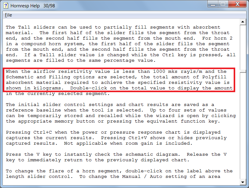

Hi Danny,
The attached design should get you reasonably close (not to scale).
Read the Stubbed Horn section in the Help file for further details.
(Stubbed horn systems can be specified using the Input Wizard).
Kind regards,
David

Thanks David !
That's very helpful, you really have made a powerful program !
I already had moved the chamber to the params Vtc and Atc,
but the Stubbed Horn was a bridge too far, although I see now that "absorber chamber" is mentioned in the help section of Stubbed Horns.
But it's nice to have some screenshots 🙂

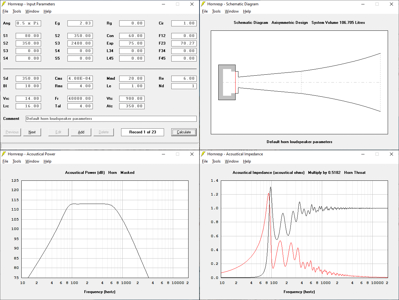

One proposal for the GUI of Hornresp:
it would be great to have multiple Hornresp windows open at the same time like in the example below.
now I find myself constantly switching between the windows.
