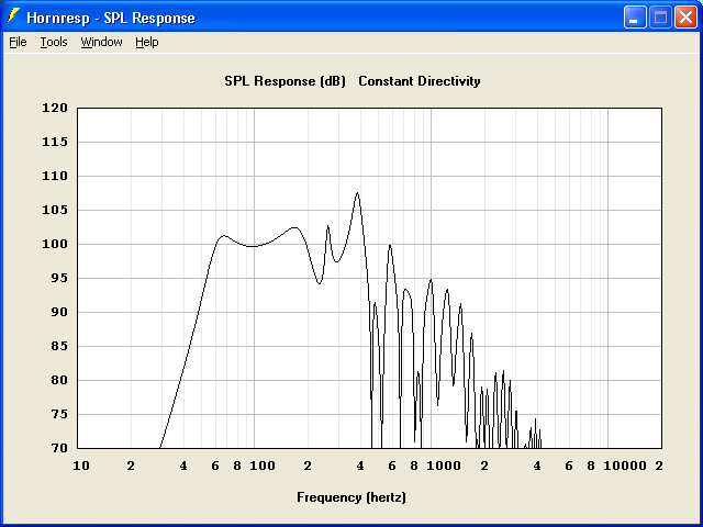

Attachment 1 shows the Hornresp power response prediction for the William Cowan 60 hertz tapped horn with Eighteen Sound 10W400 driver, radiating into 2 Pi space.

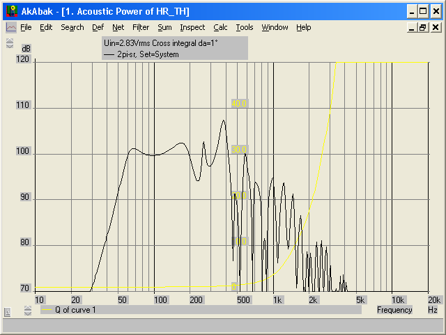

Attachment 2 shows the AkAbak power response prediction for the same system, radiating into 2 Pi space.

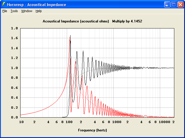

Attachment 3 compares the power response data exported from Hornresp with that exported from AkAbak. The results are not precisely the same because of slight differences in the values of the frequencies sampled by the two programs. I can’t see how the model results could be interpreted as being "quite different", though 🙂.

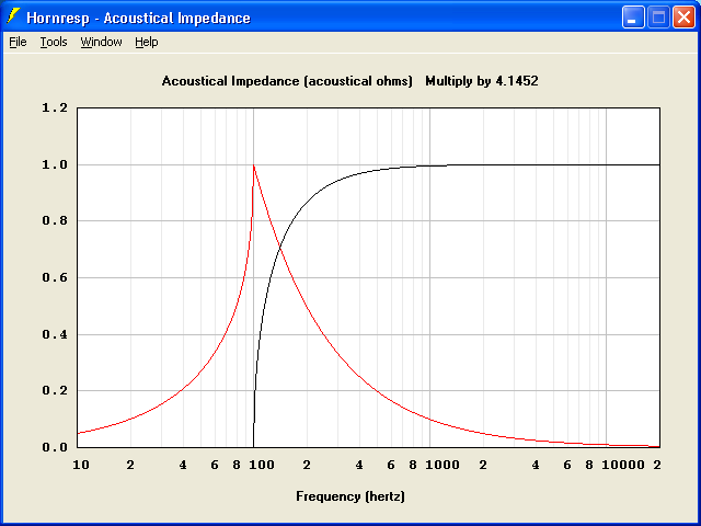

AkAbak uses a plane wavefront model in all cases, meaning that results can become less accurate once Cir exceeds 1.
Just to explain a bit further.

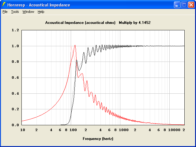

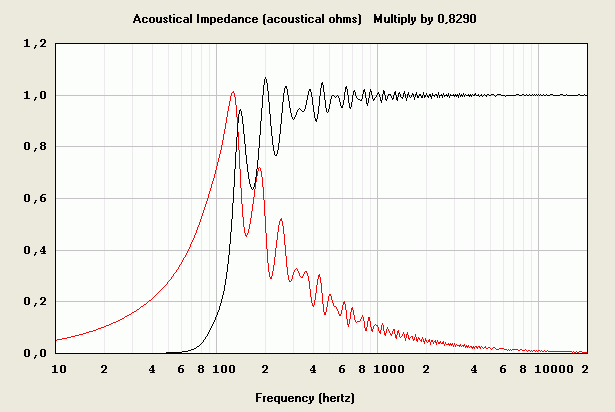

The following example illustrates the difference between the throat acoustical impedance results produced using a plane wavefront model, and those produced using an isophase wavefront model, for a large-mouth 100 hertz exponential horn.
Attachment 1 shows the plane wavefront model results, identical to those produced by AkAbak, compared to the results for an equivalent infinite horn.
Attachment 2 shows the isophase wavefront model results, as produced by Hornresp, compared to the results for an equivalent infinite horn.
Attachment 3 shows the results for the infinite 100 hertz exponential horn, separately.
For a constant flare, as the horn becomes longer and the mouth becomes larger, the throat acoustical impedance results should tend asymptotically towards the infinite case. This happens with the Hornresp isophase model but not with the AkAbak plane wavefront model.

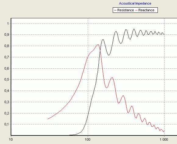

I don't have the data for the horns David posted, but here's a comparison of the throat impedance of a large exponential horn in an infinite baffle (CIR=2), simulated both in Hornresp and in BEM. Again, Hornresp is quite close, and David is right about the fact that the throat impedance gets smoother as the mouth size is increased beyond CIR=1.
Hi Bjørn,
Many thanks for this. I used a somewhat more extreme example than you did, just so that the trend towards the infinite case could be clearly seen. The relevant Hornresp parameter values are Ang = 2,0 x Pi, S1 = 10,00, S2 = 75335,04 and L12 (Exp) = 244,38, giving F12 = 100,00 hertz, Cir = 4,00 and AT = 1,87 degrees.
While a Cir value of 4 is unlikely to be used in practice, the example serves to illustrate the considerable difference between plane and isophase wavefront models when applied to horns with large mouth Fta values. It is certainly necessary to use an isophase model for Le Cléac'h, spherical wave and tractrix horns, to obtain reasonably accurate results.
It is interesting that with the BEM simulation results, the resistive component of the normalised throat impedance appears to tend towards a value just above 0,9 rather than to 1, at the higher frequencies.
