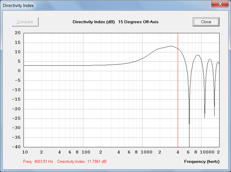

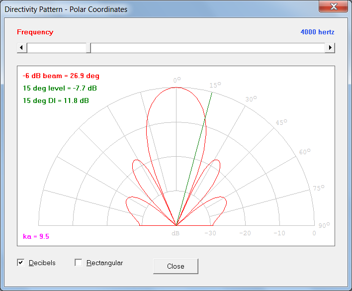

The Directivity Pattern can now show off-axis directivity index values, not just the on-axis value. Attachment 1 refers.
CHANGE 2

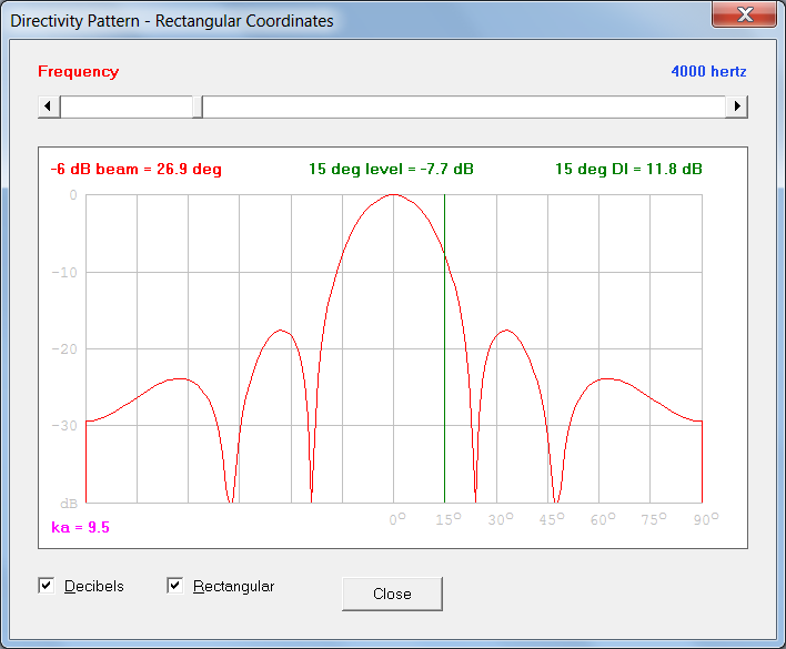

The Directivity Pattern can now be displayed using either polar or rectangular coordinates. Attachment 2 refers.

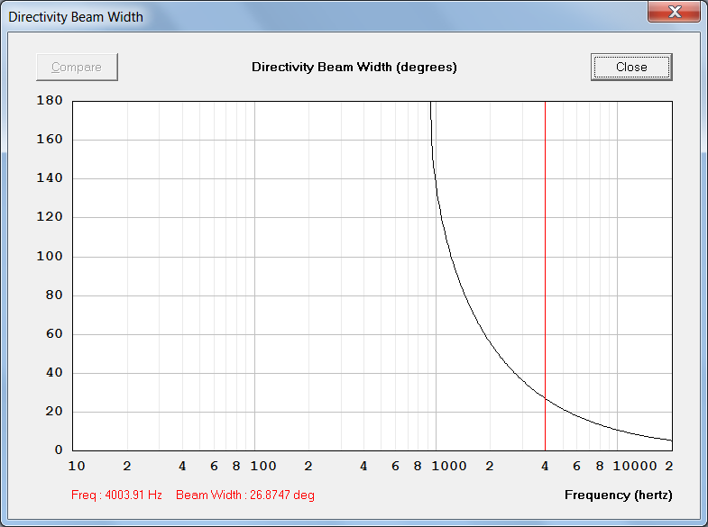

The Directivity Beam Width chart is now generated as a secondary chart rather than as an additional main chart. Attachment 3 refers.

A Directivity Index chart has been added as a secondary chart. Attachment 4 refers.

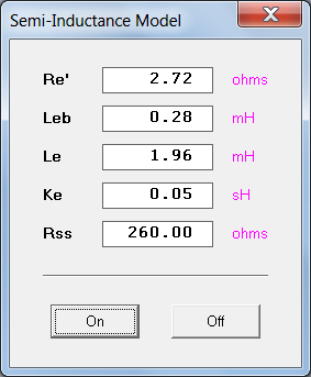

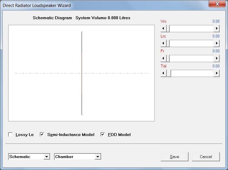

Semi-inductance and frequency-dependent damping (FDD) models have been added.
Double-click the Le text box in edit mode to select the semi-inductance model. A green Le label indicates that the semi-inductance model has been selected.
Double-click the Cms label in edit mode to select the FDD model. A green Cms label indicates that the FDD model has been selected.
My thanks to 'bolserst' for his help during the development and testing of the two new models. Attachments 5, 6 and 7 refer.

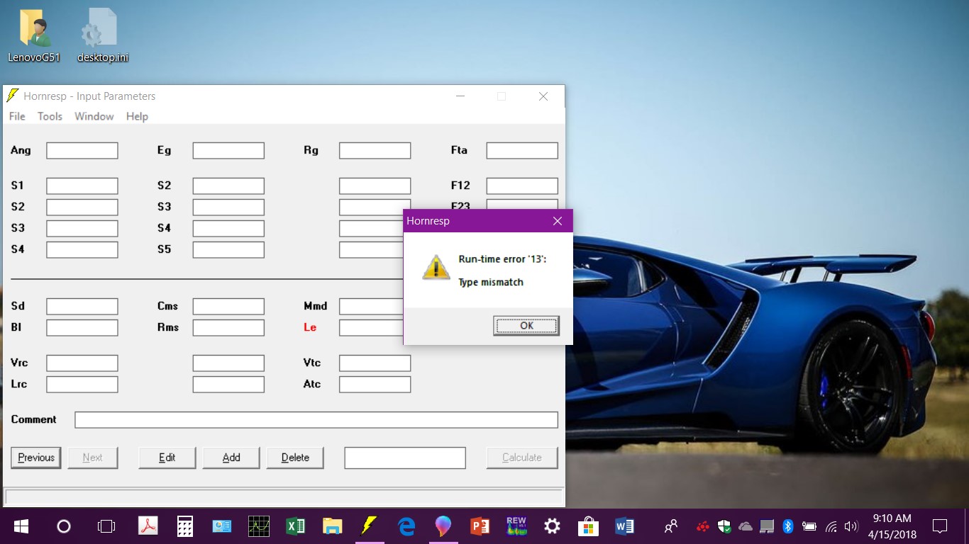

LMAO! I'll try reloading HR on the laptop to see if that cures the problem.
Hi BP1Fanatic,
Try deleting the existing Hornresp.dat file from your laptop before running Hornresp. Indications are that the data file has been corrupted.
Alternatively, try copying your existing desktop Hornresp.dat file to your laptop (overwriting the existing laptop file).
Kind regards,
David

Double clicking on Le showed the following values in the Semi-Inductance Model window: RE', Leb, Le and Ke all filled in, but the Rss field empty. Clicking the Off button said "Rss must be a number between 0,00 and 99999,99."
After entering a zero in Rss field all went well.
This is just FYI. If it is meaningful then you may want to code in that default.
