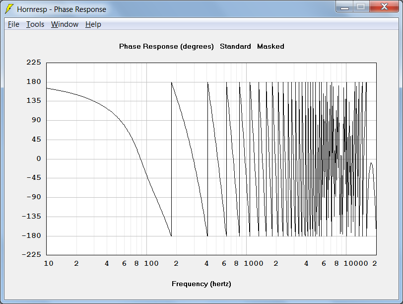

Hi Everyone,
CHANGE
Phase is now shown wrapped exactly between -180 and +180 degrees.
BUG FIX
The phase wrapping point sampling bug reported in Post #8124 has now been fixed.
My thanks to TNT for helping to make Hornresp a better product.
Kind regards,
David

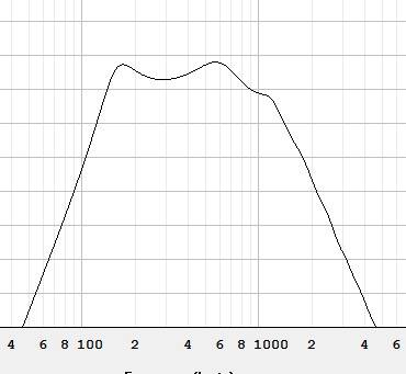

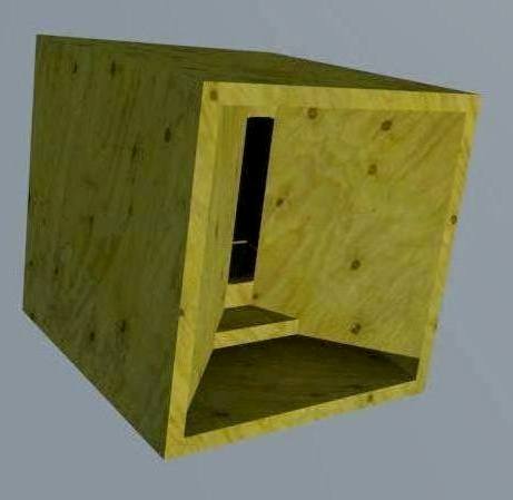

There's David ...
The port is inside the horn.
As you can see in the chart, it was simulated in your software. This is the response of two speakers

There's David ...
Hi M1Audio,
Thanks for the feedback. Would it be possible to post a screenprint of the Hornresp input parameters window for your design? It would be interesting to see how you modelled the system.
Kind regards,
David

This box was not simulated by me. The way to configure the Hornresp to be able to simulate this design is precisely the mystery that I look for that somebody let me clarify here.

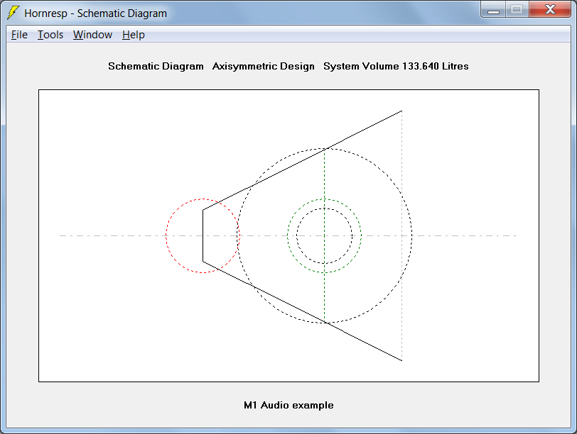

Hi M1 Audio,
From the appearance of the cabinet, perhaps it was modelled as a "Horn-Loaded Vented-Box Enclosure With Port Exit Located Inside Horn Mouth", using the tapped horn option, as described in the Hornresp Help file?
The attached schematic shows such a tapped horn design. The horn is specified using three segments, the length of the first segment being 0.1 cm. The red dashed circle represents the front side of the driver diaphragm, facing into the horn. The green dashed circle shows the rear side of the driver diaphragm, facing into the rear chamber specified using Vrc and Lrc. The large black dashed circle is the rear chamber, and the small black dashed circle is the port tube from the rear chamber into the horn, specified using Ap and Lpt.
It would of course be better simply to ask the person who posted the design in the first place, but I guess it has not been possible to do this :).
Kind regards,
David

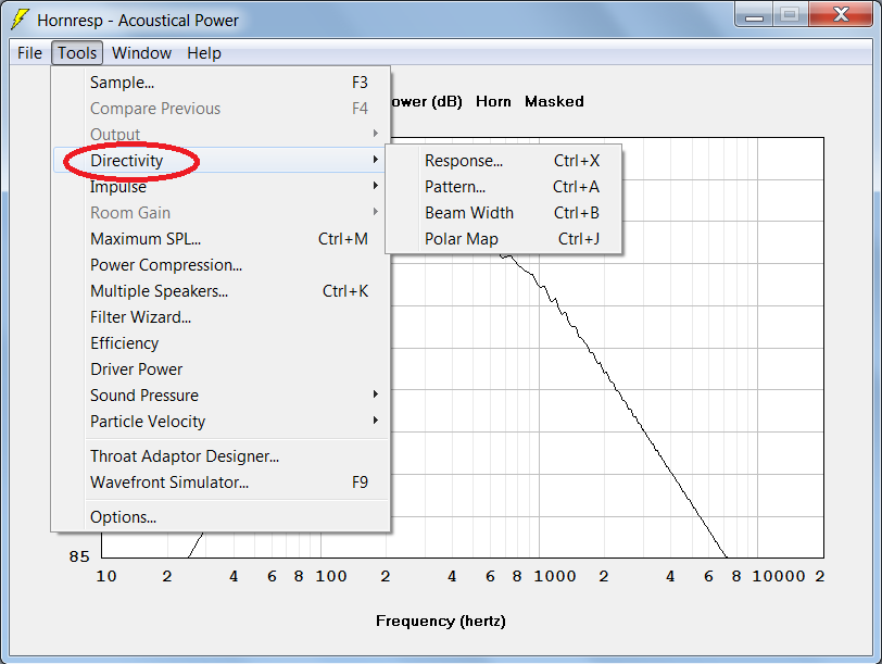

Did you already tought about introduce simulation for Directivity Indeces in the hornresp?
Hi LORDSANSUI,
Hornresp has four Directivity tools - they can be used with a direct radiating single driver, a finite single-segment non-negative flare horn with no throat adaptor, or a port. Maximum coverage angle is +/- 90 degrees.
See the Help file sections on:
Directivity Response
Directivity Pattern
Directivity Beam Width
Directivity Polar Map
Kind regards,
David

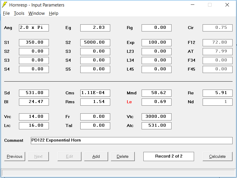

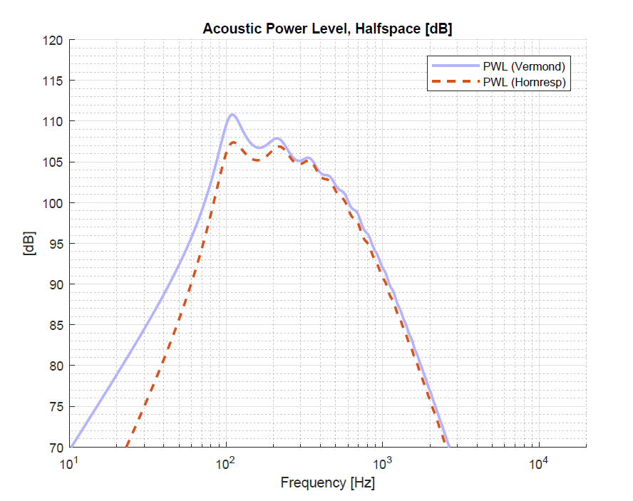

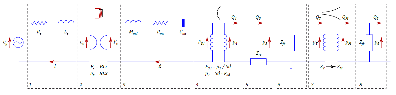

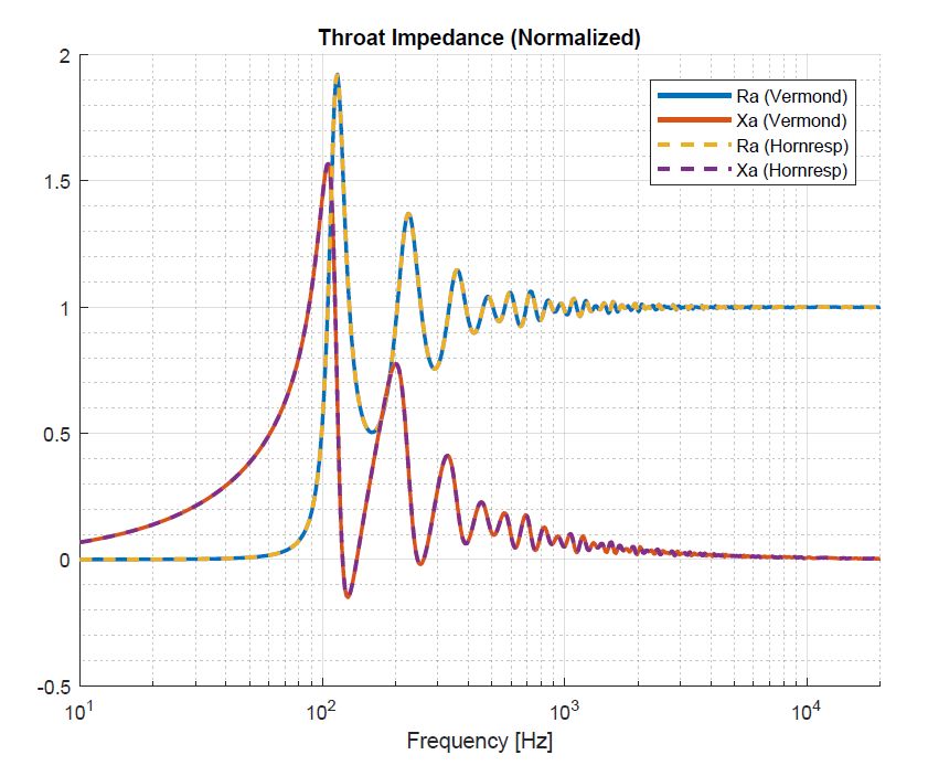

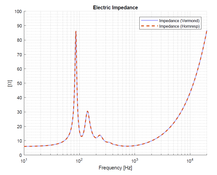

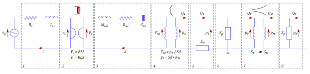

Dear Mr. McBean,
With the help of 'Acoustics', written by Leo L. Beranek and Tim Mellow, I've modeled a front-loaded horn. I have calculated the frequency response using transmission matrices. The diagram is shown in 'electric_equivalent_circuit.png'. When I calculate the throat impedance (Horn transfer matrix combined with the acoustic radiation of the piston (mouth area) in an infinite baffle), the results exactly match with Hornresp. So does the electric impedance of the total circuit. That's why I'm thinking the circuit and calculations are not that wrong. However, the acoustical power plot I can not reproduce, see the attachments.
I'm using the following equations:
W = p8^2 / Zfr
Wref = 2pi r^2 pref^2 / (rho*c) with (r = 1)
PWL = 10log10(W/Wref)
p8 can be found in the electric_equivalent_circuit.png.
Maybe you can shine your light on the above equations and maybe find an error in my calculations?

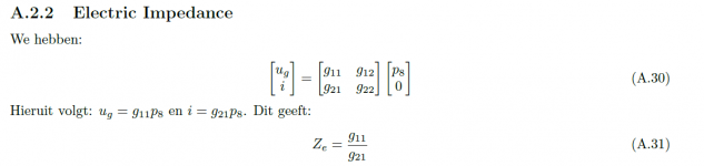

Edit 3/18/2018, 9:23PM:
Maybe the calculation of p8 can still be wrong, since this variable is cancelled out with the calculation of the electric impedance, see attachment. Maybe the assumption that the front and rear chamber are modeled as pure compliance's is not correct?
Hi Vermond,
The screenprint of your Hornresp input parameters window shows the Le label in red, which indicates that the Lossy Le option has been activated. The Lossy Le option needs to be turned off. The W = |(p8/Zfr)|^2 * Ra equation suggested by Bolserst is the one to use. If the results still don't match then it seems that there may be an error in the calculation of p8, as you have assumed. With the "resonances masked" option selected, Hornresp models the front and rear chambers as pure compliances.
Kind regards,
David
