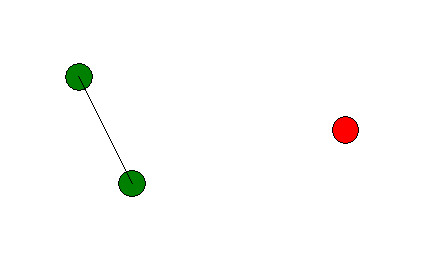

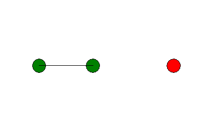

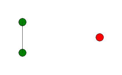

The power response predictions for distance-separated combined outputs are now more accurate. The phase response and impulse response results for individual and combined outputs are also now more accurate.
I overlooked including perhaps the most significant change, at least as far as the user is concerned. When considering combined outputs, the path length input parameter now refers to the separation distance between the two outputs, not the difference in the path lengths from the two outputs to the reference listening point. All values are now positive, whereas previously it was possible to specify either a positive or a negative value.
This means for example, that for a bass-reflex loudspeaker having the driver at the top of the enclosure front panel and the port at the bottom, the path length value is now the distance from the centre point of the direct radiating driver diaphragm to the centre point of the port outlet. In the past, a zero path length (difference) would have been specified for such a system if the distances from the two outputs to the listener were the same.
In the three schematics attached, the green circles represent the two outputs, the red circle is the listening point, and the straight line connecting the two green circles is the path length value specified by the user. For co-located sources, the path length value is zero.

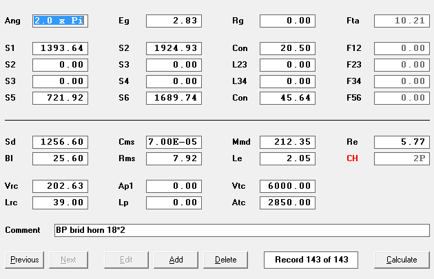

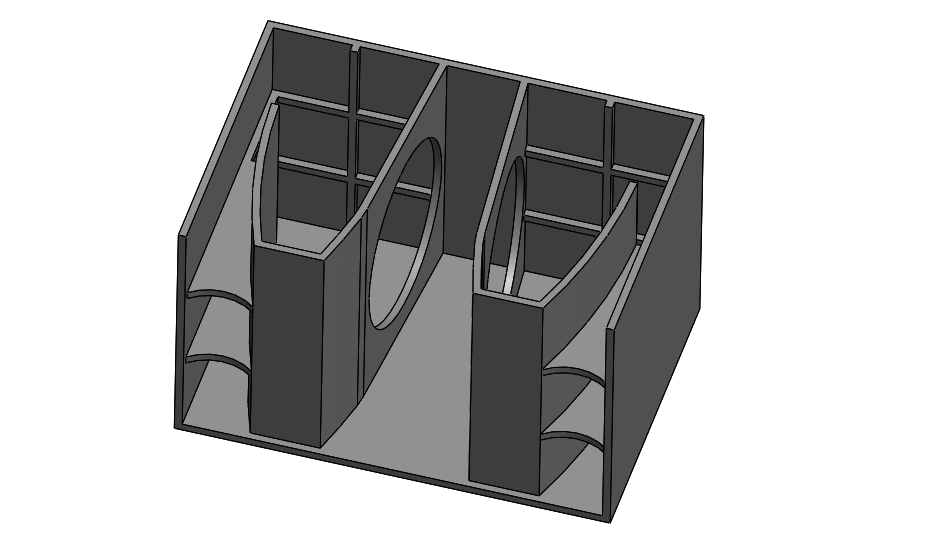

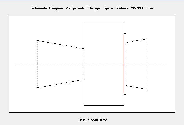

Hello david
I'm not sure about this cabinet. What do I need to use the On the window hornresp.Especially the part is horn Speaker Pages.I'm not sure what value to use.

Hi Piyapong38,
While not a perfect match, the Hornresp Compound Horn (CH) simulation model seems to be the most suitable one to use, as it is the arrangement option that most closely specifies the design layout of the cabinet shown. When you say "not sure what value to use", it is not clear to me what parameter you are referring to. Also, I don't understand what you mean by "the On the window hornresp" and "the part is horn Speaker Pages".

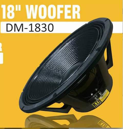

This speaker
