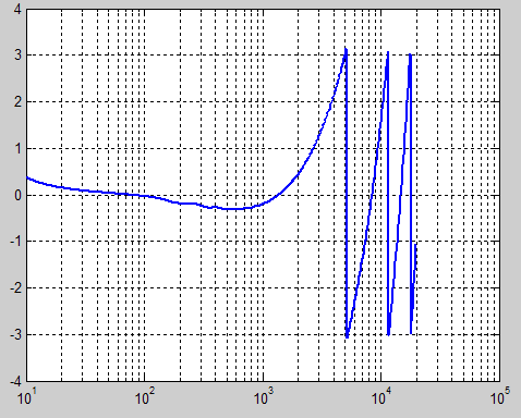

Hello David,
Thanks, the analysis of the phase curve is now easier withe the 45 degrees tics marks.
One thing I noticed thoughis that, the test of the phase polarity I used to insert in the phase unwrapping seems now inefficient.
Please give a look to the attached graph. You'll see that on a very wide interval of frequency the phase is near of -180degrees or +180degrees. In such case, normally the polarity check introduce a 180 degrees shift in order to have the phase evolving around 0 degree.
Best regards from Paris, France
Jean-Michel Le Cléac'h

Hi Jean-Michel,
Remember, I am using:
for I = 1 : Nfreq;
PUNW(I) = PUNW(I) - Dphase * FREQ(I);
end
rather than:
for I = 1 : Nfreq;
PUNW(I) = PUNW(I) - Dphase * (FREQ(I) - FREQ(1));
end
Could this be the reason for the "inefficiency", perhaps?
Also, could you please post a screenprint of the input parameters you used to produce the phase response shown in your graph.
Did you use the default delay calculated by the program, or a different value entered with the Delay tool?
Kind regards,
David

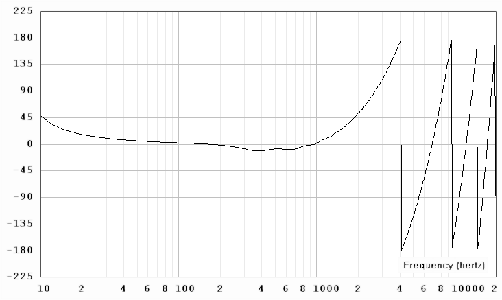

Hello David,
The last phase curve was the one obtained when running Hornresp on that example:
http://www.diyaudio.com/forums/attachment.php?s=&postid=1826078&stamp=1242139718
The "polarity check" in Matlab language is as such:
S1 = 0.0; S2=0.0;
for I = Imag1 : Imag2;
S1=S1+(PUNW(I)^2); S2=S2+(abs(PUNW(I))-2.3562)^2;
end
if S2>S1;
for I = 1 : Nfreq;
PUNW(I) = PHASE(I)- Dphase*FREQ(I);
PUNW(I)=PUNW(I)-2*pi*fix(0.5+(PUNW(I)/2/pi));
end
else
for I = 1 : Nfreq;
PUNW(I) = pi+( PHASE(I)- Dphase*FREQ(I));
end
end
All angle values in those lines of code are in radians (even the value 2.3562 which is 3/4 Pi radians and should be replaced by 270 if your own Visual Basic code uses degrees for angle values .
It only should be performed one time only (for the default "modified phase curve"), then when using the "added delay tool" it should not be done anymore.
You'll find in attached file the same phase curve as obtained using my Matlab code.

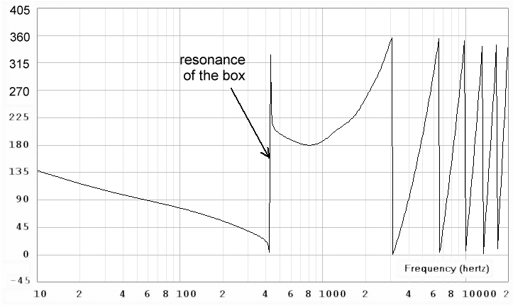

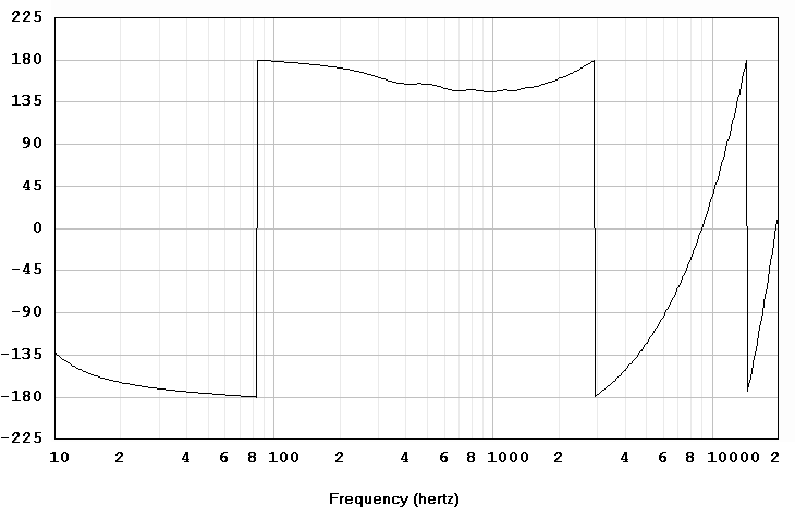

Hi David
In product 2300-090709 I still get almost 0 degree phase shift at 10Hz for a small sealed box that rolls off well above 10Hz, or in a plain front loaded horn also rolling off well above 10Hz.
I think phase is still wrong, at least polarity reversed.

Hi Jean-Michel,
Would you care to comment on Eva's statement below?
As you know, I am no expert when it comes to "corrected" phase 🙂.
Thanks.
Kind regards,
David
Eva said:In product 2300-090709 I still get almost 0 degree phase shift at 10Hz for a small sealed box that rolls off well above 10Hz, or in a plain front loaded horn also rolling off well above 10Hz. I think phase is still wrong, at least polarity reversed.
Thanks.
Kind regards,
David
Hello David,
For closed box simulated by Hornresp the phase at frequency lower than the cut-off is OK (raises over +180degrees when frequency decreases, for f<10Hz) but this requires that internal resonances inside the box are masked or damped using a thick layer of damping material (example given TAL = 10cm). In the case damping is inefficient to damp the internal resonance of the box, then we may see on the response curve one or several thin deep hole(s) . In that case the mean group delay inside the useful bandwith is much affetced by the resonance and even the definition of the frequency limits of the useful bandwith are questionable. The solution is to mask the internal resonances of the box or to use a thicker damping inside the box.
