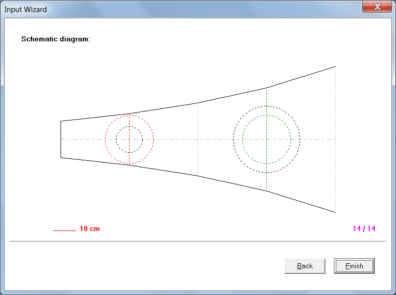

Hornresp Update 4000-161108
Hi Everyone,
CHANGE 1
The last page of the Input Wizard tool now shows a schematic diagram of the specified loudspeaker system - see Attachment 1. Also, the red progress line has been removed and the percentage completed indicator has been replaced by an indicator showing the number of pages completed out of the total number of applicable pages - see Attachment 2. Pressing the Home key returns to the first page of the Input Wizard.
CHANGE 2
Pressing and holding down the S key while viewing the main form now instantly displays the schematic diagram. Releasing the S key immediately returns to the previously displayed chart or input parameters window.
Kind regards,
David

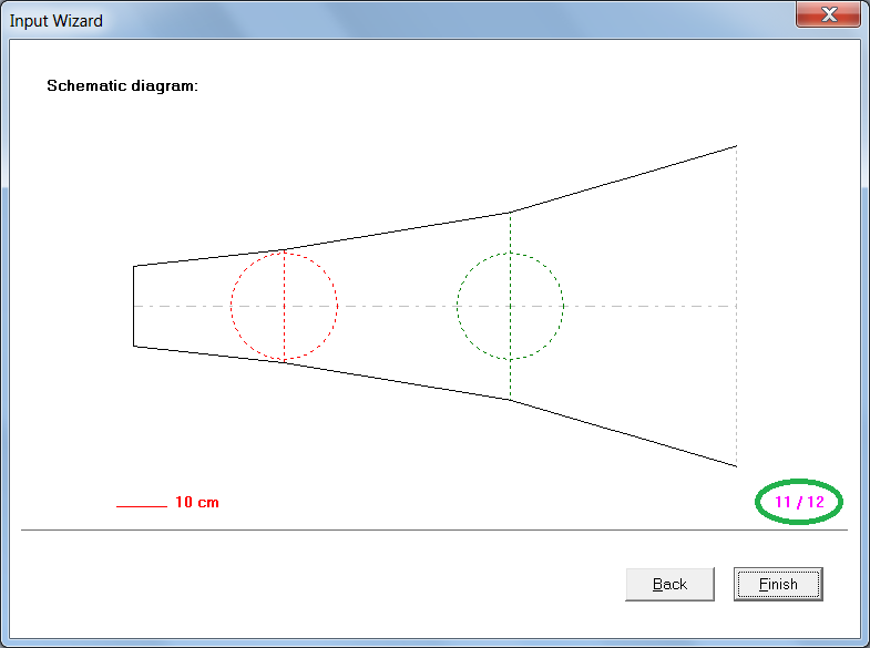

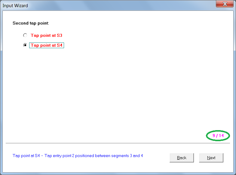

Hornresp Update 4000-161110
Hi Everyone,
BUG FIX
The Input Wizard page counter was not showing the correct total number of pages for a three segment tapped horn - see Attachment 1. This has now been fixed - see Attachment 2.
Kind regards,
David
