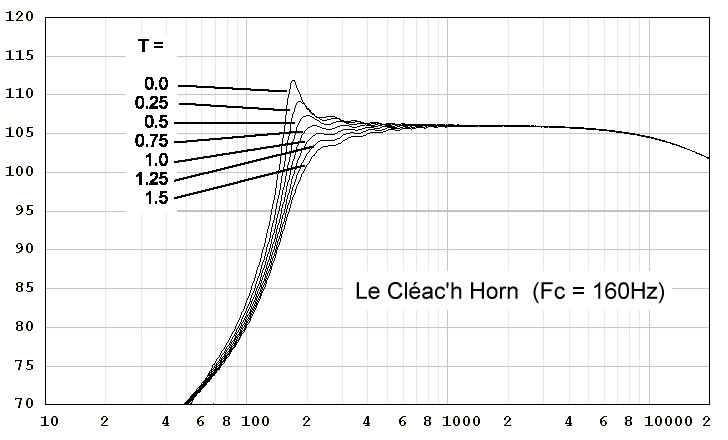

Hello David,
Thanks a lot for all the work you do to give a solution - when possible- to such requests as mines.
The constant velocity diaphragm will be very useful to compare horns without the influence of the driver.
Here attached the response of Le Cléac'h horns having the same cut-off frequency (Fc = 160Hz) and different T values (from 0 to 1.5)
Best regards from Paris, France
Jean-Michel Le Cléac'h

Hi Jean-Michel,
It looks good. The results are as expected 🙂.
Kind regards,
David

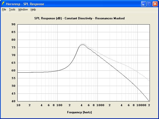

Hi Jean-Michel,
Further to the above, the attached screenprint shows the constant directivity power response of a TD2001 driver and Le Cléac’h horn (320Hz, T = 0,8) with a constant diaphragm acceleration of 1000 cm/sec2. The equivalent on-axis pressure response is shown in grey.
Based on these results, I am not sure that there would be much to be gained by including a constant acceleration option in the production version of Hornresp. Do you agree?
Kind regards,
David

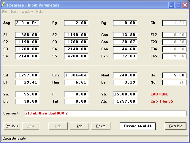

Segment F45 has a Cir = 1.01, so in the Wizard, check the 'Cir' specify box, input 1.0, then 'calculate' to have it recalculate L45, F45 to 22.17, 99.23.
BTW, for my records, what brand, model driver is this?
GM
GM
Thanks GM,
I am trying to understand what u say.
The driver is chinese made T & T.
Popular model in Phillipines.

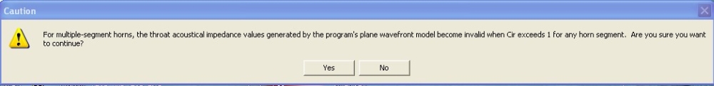

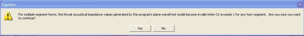

mhtplsh said:warning message for the above post HR input.
Let me know my mistake.
Hi mhtplsh,
Please note that the message you are seeing is an advisory one only. Hornresp still works okay for multiple segment horns with Cir > 1, it's just that the results become less accurate as Cir increases above 1.
Kind regards,
David

Hello David,
Acceleration being the derivative of velocity it is quite normal to obtain that 10dB slope. It was expected.
As I don't have any measurement of the power response of the TAD TD2001 on a Le Cléac'h horn, what interest me is to compare my frequency reponse curves measured by me at various angle from the axis, with the simulated response (HR directivity tool).
If the set of curve evolves differently with the off axis angle then probably we can say that the discrepancy between the response curves measured off axis and the ones simulated by Hornresp is due to a certain distribution of the pressure field at the driver throat.
Now if they are similar we must probably ask us why the simulation done using acceleration is better...
Ref: paragraph 3.2.1 in Mark Dodd's paper
(to calculate the on axis and off axis response he applied a j omega factor to the response in constant velocity...)
http://www2.kef.com/resources/whitepapers/uniq.pdf

Hello David,
Your graph shows a 20dB/decade slope not a 10dB/decade slope as I wrote eroneously.
