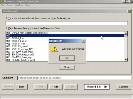

Error in Version 19.00
Hi David,
I had a problem in Version 19.00-08041: after adding a speaker the program created an additional entry "002" that gave a "Subscript out of range" error everytime I tried to open it, and when clicking OK in the error window Hornresp shut down.
I could not remove this entry in version 19, but was able to get rid of it by going back to version 18.30 which opened the empty entry, and allowed me to delete it. After reinstalling version 19.00 all seems fine.
Just thought you should know, thanks for Version 19.
Hi David,
Re: Error in Version 19.00
Hi Oliver,
Many thanks for the feedback. I suspect that you may have had two copies of Hornresp running at the same time, at some stage 🙂. Editing, adding or deleting records using one copy of Hornresp while another one is also open, will generate the problem you have experienced. Could you please let me know if you had two copies of Hornresp running, sharing a common data file.
In any event, it is strongly recommended that only one copy of Hornresp be run at a time, and as mentioned in a previous post, under no circumstances should an earlier version of the program be used after the data file has been opened by a more recent version.
Incidentally I have just released a minor upgrade which fixes two subtle user interface bugs that I found yesterday. Product Number 1900-080418 refers.
Thanks again for the excellent feedback.
Kind regards,
David
Hi David,
You are correct, I have had two copies of Hornresp running at the same time before. It is interesting, that I have not experienced any problems like this earlier. I quite frequently have had one window open to see e.g.: the input parameters or the SPL curve while working in another. Well, got to stop doing that, it's easy enough to work around.
I have been amazed how forgiving your software is in comparison to many others out there. Thanks for the steady stream of updates.

Re: Re: Error in Version 19.00
Hi Oliver,
Many thanks for the confirmation. I have now included a cautionary note in the Readme.txt file supplied as part of the download package, warning users not to edit, add or delete records while running multiple copies of Hornresp.
Please note that it is quite okay to run multiple copies, provided that they all have the same version number. The important thing is not to edit, add or delete any records while the multiple copies are running.
Thanks again for the very useful feedback.
Kind regards,
David
