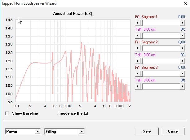

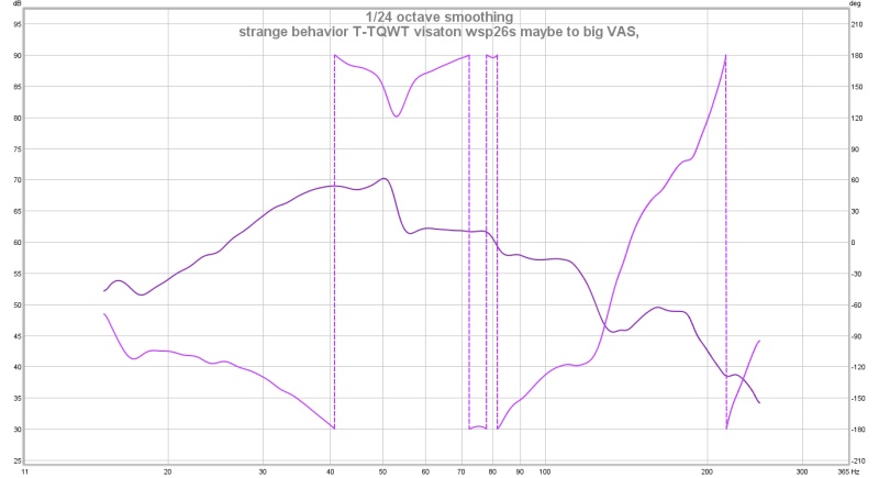

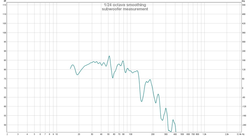

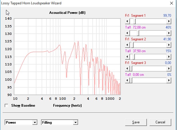

I have try to get a strange thing out of a T-TQWT, it looks like there is a shift around 52 Hz, something I do also see in hornresp but when try to make this oke with damping I get not what I want.
can somebody tell me why this happens, is the vistaon with his high VAS a cause?, it will give a bump but with sim in hornresp I can get it alright except in real I can not.
You can see on the hornresp plots one with and one without damping, you can also seen that hornresp is quite precise.
The bump around the 52 Hz is also quite present in the room giving boom.
thanks.
kees

Room Dimensions?

SWAG: You are measuring the interaction between the sub and the room.

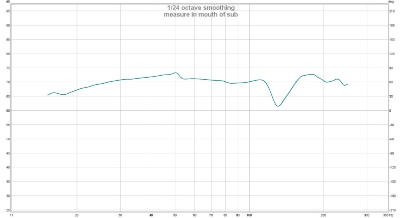

Tomorrow when rain is over I go try outside, there is no room so I can see if it still happen.
I did see when measure very close to mouth it was a lot better. And yes I have a quite strange room, full of things and a wood stove who resonate happenly.
Close to the mouth it do measure quite good, so you have proberly right.
regards

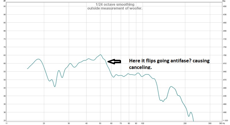

I did a outside measurement, no room to spoil everything, still the same except some change, I gess the pipe on back of the speaker has or standing waves or fase flips causing canceling, I get nog change but go put reflectors in the corners for as it are standing waves.
strange thing, and yes hornresp predict it right however when stuffing it says it is oke, but I can stuff my complete matras in it it do not help.
Ohh yes the peaky reaction around 20 hz and lower is wind.
regards

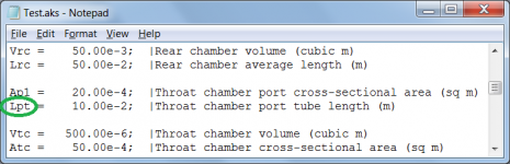

Hornresp Update 3940-151130
Hi Everyone,
Exported AkAbak scripts were showing the variable name Lpt for the length of a throat chamber port or throat adaptor (see Attachment 1). The correct variable name is Lp.
This has now been fixed (see Attachment 2). Simulation results remain the same.
