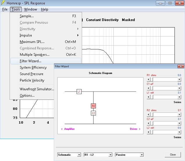

Apart from that minor detail, i can't find the Filter Wizard in v32 ?

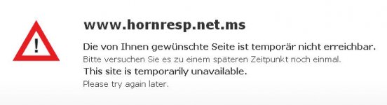

Hi Thawach,i still use the old classic version. david i cant download the new version.
Please update your link to: hornresp by David McBean
Did you read my post #3331? 🙂.
It can be accessed from the SPL Response window using the Tools > Filter Wizard menu command.

go to www.hornreps.net (without ".ms" at the end)i still use the old classic version. david i cant download the new version.
oh, i was too slow 🙂 already answered 🙂

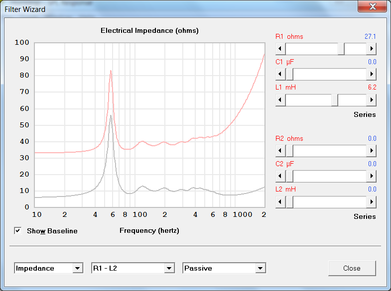

Hornresp Update 3200-130418
Hi Everyone,
CHANGE 1
The Filter Wizard baseline charts are now reset each time the wizard is opened. This means that the initial baseline charts are the same as the charts in the main windows.
My thanks to littlemike for raising this point.
CHANGE 2
Pressing the F5 function key when working on a passive filter design will reset all the passive filter sliders to the default value of zero, and the four filter branches to "series" configuration.
CHANGE 3
An electrical impedance chart has been added. It shows the magnitude of the input impedance for a passive filter connected to a speaker.
My thanks to Sabbelbacke for the suggestions that prompted changes 2 and 3.
* The Hornresp.exe file properties show Version 20.00. This will be fixed in the next release, as indicated in my post #3356.
Kind regards,
David
