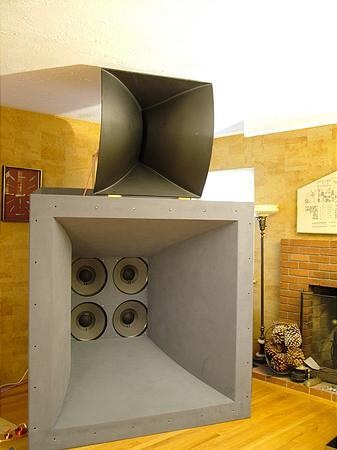

Correct, so the mouth doesn't always get chopped off, i.e. the Altec 200 series theater horns and other manufacturer's variations cut off the small end and use multiple drivers with the right set of specs to arguably get the least compromised overall performing truncation. Admittedly, such horns if not corner loaded can intrude a bit too much into a typical HIFI/HT though:

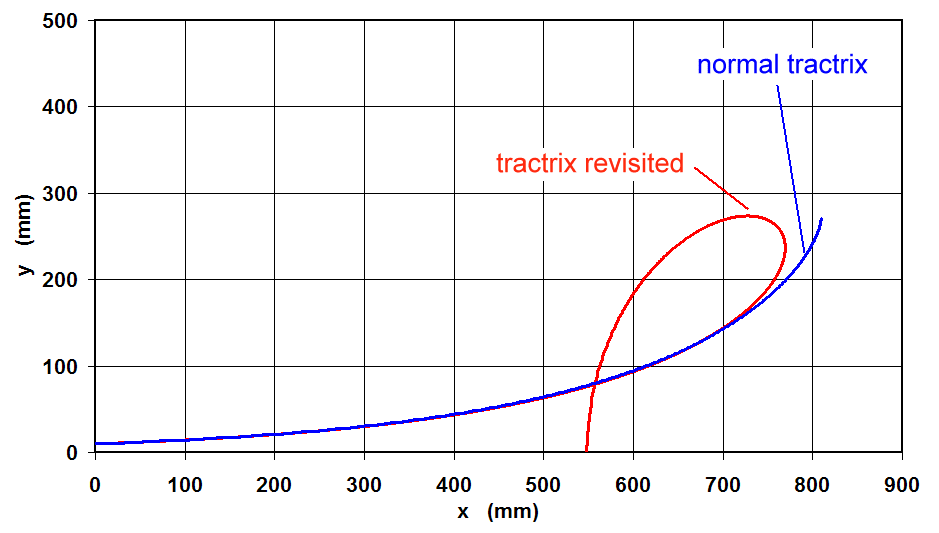

Hello,
When the young Voigt in the 20s used to "rework" the exponential horn on the basis of curved wavefront (at the time he could only manage with spherical wavefront due to the lack of computer). He calculated a set of point for several wavefronts and report their coordiantes on a sheet of paper. He used for the calculation, an exponential expansion of the area of the wavefronts as at the time this was the commonest solution of the Webster's equation used.
For any reason, he stopped the calculation when the slope of the profile seemed to become nearly orthogonal to the axis and on the view of that set of points a draftman who was working with Voigt said: this is a "tractrix curve" and for sure a tractrix curve was a good aproximation for the real curve passing through that limited set of points.
You'll find at the end an excerpt of the complete story as told by Bruce Edgar
Now, with the help of computers we can draw the real curve that Voigt should have obtain on the basis of an exponential expansion of spherical wavefronts.
I did the calulation and you'll find in attached file the comparison between the tractrix profile and the recalculated curve.
Only that last curve can lead to infinite or quasiinfinite horns.
The tractrix profile which stops at 90° of the axis has to be considered as a truncated horn.

could you expand on this comment by considering the Tractrix horn?

Actually, it's listed on the Lansing Heritage website as a Jim Lansing/Westrex/Ampex theater horn depending on the label stuck to it. Regardless, we must have a frame of reference to decide from which end [or both] to truncate from, so while you’re right referenced to an 'infinite' expansion it seems an impractical one, at least for the purposes of this thread topic.
Not really, Keele wasn't around when I learned that the pioneers of audio had long since concluded before I was born that a 1 WL mouth area of the desired LF response was the practical limit that the horn in the picture represents. Didn't know he even existed until folks started referring to his work decades later on the joelist and still haven't gotten around to reading any of his published work. Ditto BK's thoughts on horn theory. Thanks for the link though!
When someone on the joelist referenced Keele's thoughts on mouth size, I just assumed he subtracted out the mouth end correction which at a glance seems a reasonable thing to do, but my own experiments had already concluded that the 1 WL rule was fine for mid-bass, lower mids horns out to ~600 Hz, so was probably overkill for bass horns, though haven’t actually done any experimenting with < 70 Hz 1 WL mouth areas.
Since you don’t seem to agree with the < 1 WL reference to define being truncated from the mouth, where do you think it should be?

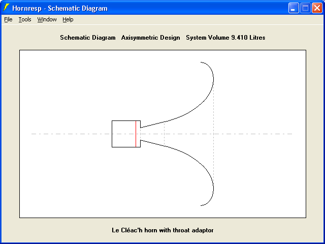

I am now working on a LeCleac'h horn for a 1" compression driver. Group delay, acoustical impedance and polar map are useful. Spl response is not so useful though :grumpy:
May I suggest a few improvements? I have not read through all 224 pages, so forgive me if this has already been suggested.
I would like to be able to model the phase plug as the first section, the exit of the driver as the second section, an angle adapter as the third section (a spline perhaps as suggested by LeCleac'h himself) and finally the LeCleach horn as the fourth section.
Also entry and exit angles for each section would be useful.
Hi more10,
The way that Hornresp has evolved, massive changes would be required to implement the functionality you are seeking. Sorry, but it is not going to happen. The best that you can do is to specify a chamber and throat adaptor using parameters Vtc, Atc, Ap1 and Lpt - see attached screenprint.
To check the throat adaptor half-angle, double-click on the Ap1 input box in edit mode and then press the Calculate button to display the Fta value.
The horn throat entry half-angle is given by AT on the main input screen.
In the example shown, the throat adaptor half-angle has been made equal to the horn throat entry half-angle.
Kind regards,
