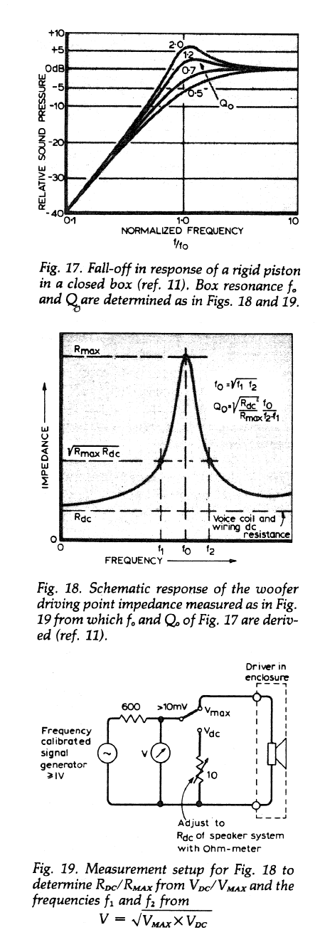

Hornresp missing T/S parameters
Yeah, they've left out the ones needed to calculate them, though with patience could keep trying different combos till they all lined up close enough or go really simple with a pre-T/S Q0 (attached) using the impedance plot to get a ~Qts to start with, assuming of course that the impedance plot is accurate enough.
