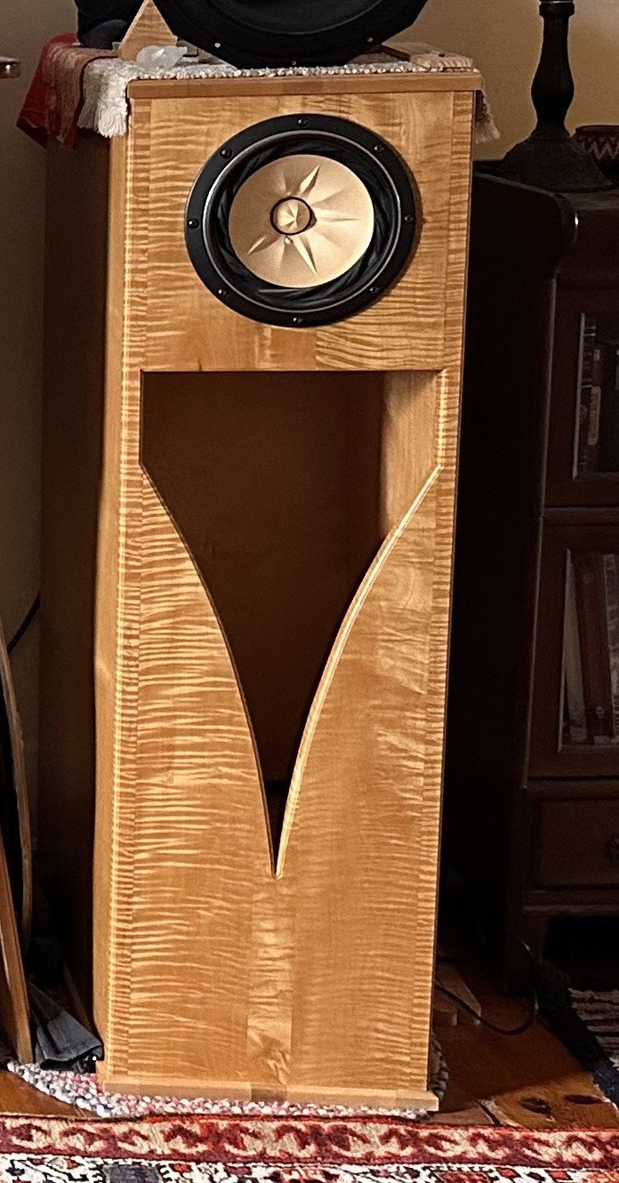

Thanks for the follow up @stv , Please see the pdf below. I know this design (shown in the photo) works, I have heard 2 different sets of them, and they are lovely. AI seems to have been quite competent at reading the drawing and providing quite detailed insights to the horn path length and geometry, throat placement, size and shape. -At least to my uneducated self. It proposed reducing the shoulder from a 4" height to a 1", lowering the convergence point of the mouth to the base of the interior cabinet floor and optimizing the mouth shape from a hybris parabolic/exponential curve to the tractrix curve shown on the PDF. Before I actually start the build I'd love to model these changes if at all possible. My plan was to hopefully have someone who knows Hornresp run the data and see how they might be contstrained or optimized further if possible. The driver will be a Fostex FE208ez (unless there is a better suggestion?). I will have the crossover designed for this driver and config. AI seems to have been quite competent at reading the drawing and providing quite detailed insights to the horn path length and geometry, throat placement, size and shape. -At least to my uneducated self. It proposed reducing the shoulder from a 4" height to a 1", lowering the convergence point of the mouth to the base of the interior cabinet floor and optimizing the mouth shape from a hybris parabolic/exponential curve to the tractrix curve shown on the PDF. Before I actually start the build I'd love to model these changes if at all possible.

This is more a transmission line (quarter wavelength resonator) than a true horn.
Seems a bit old fashioned to me with the driver at the start of the line.
Restricted "karlsonator" opening of the "horn" turns it to act more like a mass loaded quarter wave resonator.

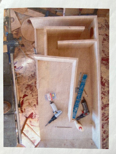

Really? Interesting, sounds just like Bill...I didn't get the chance to get to know him before he died, but we are close with his wife and live in the same village. (My summer project will be restoring his original prototype bass horn. It's in a barn nearby.) I haven't really started my search but these are meant (but not required) to have his AH! cast aluminium horns mounted as well. It will be tough to find a pair, but I also have the ability (with his wife's blessing) to recast an original set if needed.
The drawings I have of his are missing the front elevation locating the mouth, and I can directly measure the set in the photograph, but then I went down the optimization route. I also had a hunch his precision measurements to the /64th" were not accidental, and discovered (uncovered) that the volumterics are all golden ratio and pi driven.

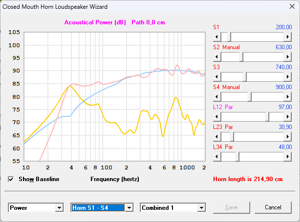

I tried to unwrap your "horn" shape - it seems to have some narrowing after the first segment!

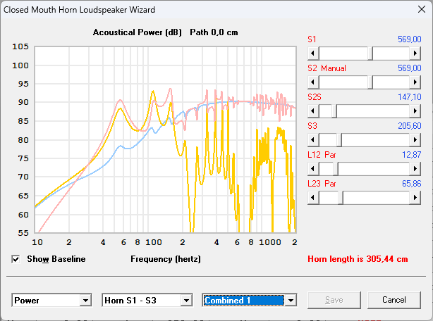

I used the advanced center line method and then simplified the result to model it in hornresp:
This is the resulting response simulation:
red: combined response
blue: driver output
yellow: port output
the port output will most probably be slightly less ragged in the upper range because of the line bends, the karlsonator port and eventual lining.
I guess you can improve the horn development of the first segments.
and please keep in mind: this simulation is so simplified that it won't accurately predict your very complex proposed enclosure!
But it does show that there will be some severe peaks and dips in the lower range that are inherent to a transmission line with the driver at the very start of the line.
These dips and peaks will still be there, even with the bends, karlsonator port and lining.
(And: AI has not the slightest clou about acoustic simulation and more advanced speaker enclosures. It's still too young for that but not young enough to openly admit it)

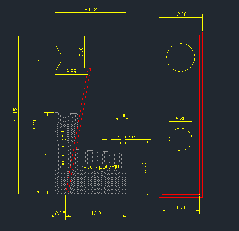

I would build an offset port tapered TL, very similar size as you proposed.

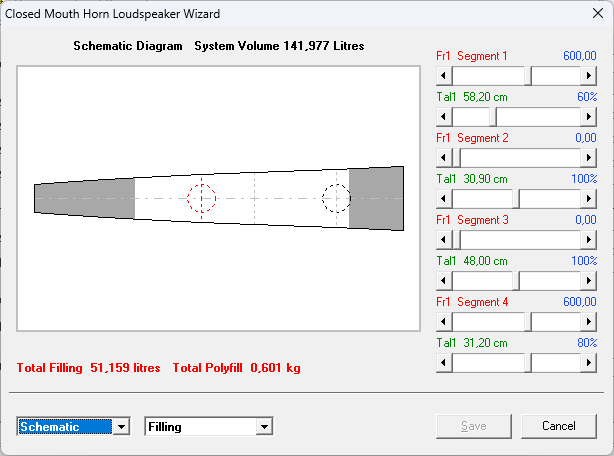

hornresp schematic with filling (wool/polyfill ~10kg/m3 shown in grey shading):
very rough drawing following the hornresp model above and your enclosure dimensions:
simulated response (red combined, blue driver, yellow port):

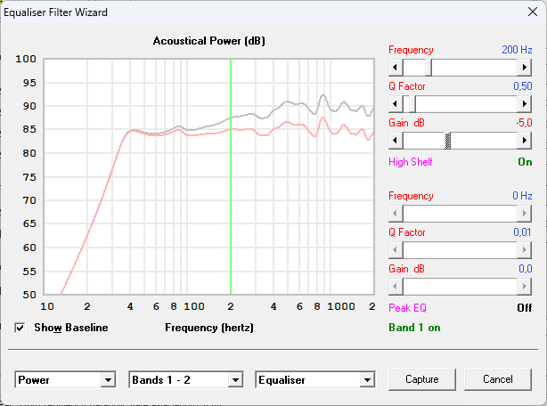

and with a very simple high shelf filter for a more even response:
we could still optimize the port, just in case you have access to a 3d printing facility!
