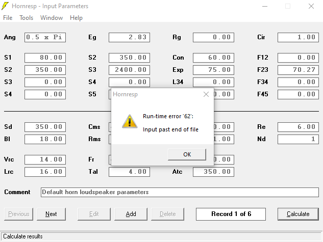

Hey good people. I need some help. I recently downloaded the latest version of hornresp and installed it. Since that "update" I've been getting the -runtime error 62- when opening some of my designs. It's very frustrating and I really hope I haven't lost my designs. I've attached a screenshot.
Please help

Tried this, it still won't open my previous records. That error is popping up for specific recent records 😢
Do you know what version the recent records where created in? If they are boxplot records, maybe try Brian's thread. HR is trying to read entries that do not exist in that record. HR has been pretty backward-compatible with itself. "Corrupted" could be true, but you may be able to inspect enough of the (copy of) Hornresp.dat to see your entries and recreate the inputs. Absent-that, it will take someone more used to doing the sort of editing that David had good reason to discourage. If it is only the 6 records in your .dat file and they are not double-top-secret, maybe post it and maybe someone can poke-around to recover it. I would also try using the Editor to move the offending records (w/o opening them) between/to another test .dat file, etc.
