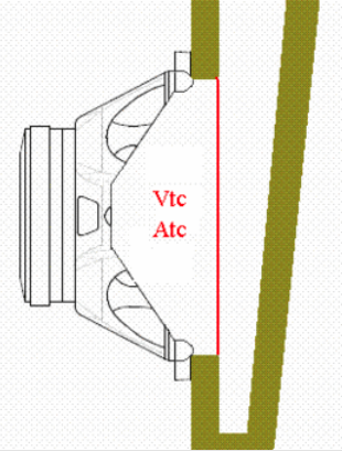

Question of the Day - Vtc/Atc
I have been looking over many of the fine tapped horn designs on this great website and I have noticed something in many of the designs I can't make sense of. It seems most of the designs that were done more than a few years ago used Vtc/Atc in the HR calculations. But starting about 3 years ago, many designers stopped using the Vtc/Atc in the simulations.

Some are using the Vtc/Atc and also doing "cone correction" to account for the volume in the cone.What is the reasons for not using the Vtc/Atc anymore? Was there an evolution in tapped horn design that made these factors unnecessary?
In a TH with the cone opening the full size of the Sd, the change in cross sectional area with or without allowing for Vtc/Atc is not all that great (when using about a 3/1compression ratio) and makes little difference in the results.
Vtc/Atc makes much more difference in mid/high offset horn designs (like the Synergy/Unity) where the enclosed area in the Vtc/Atc makes an acoustical band pass.
Juggling the enclosed area vs. the exit area and port length can make a large difference in upper response, a big deal when the crossover is 600-2500 Hz, but not much concern for sub use, where the crossover point is generally under 200 Hz, and TH response is generally only a few octaves of relatively flat response.

Vtc/Atc is a big deal in traditional horn designs, so naturally, early tapped alignments were designed as ~ compound constant or expanding TL [front and back loaded TL or horn] after the early ‘50s Jensen Transflex tapped TL [TP], but a TP/TH in theory shouldn’t be used above its tap point, so in the scheme of things not normally of any real benefit since Atc is typically > Sd, making the ‘trapped’ air in Vtc too small percentage wise WRT pipe/horn net Vb to have any audible impact on its performance.
