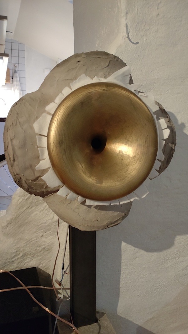

Hi,I have now lived and listen a lot to these the past days. I still very much enjoy them and I'm certainly glad I built them. But all isnt/wasnt completely dandy - is it ever
Yes- there was harshness in the midrange. So the old CD / wg problem? I dont know. Its like a shsss bright guurlgle on choir and massed strings - impossible to live with. I think it can what is circled in the "bugger" attachement - it could be energy transfer in both any direction... its surely is in the cover region.... For the Hornflower, I fixed 2/3 of it by some very simple measures and I have one or two left up my sleeve.
- The cavity between the horn and the flower - filled it up with fleece - better.
- Made a roll of fleece which on one of the long sides, I cut small leafs - these kind of prolonged the round-over of the wg towards the flower - better still.
- The hard brutal PLA/Concrete/Steele meeting between the flower and the WG in the area of the throat - I used felt to to form a gasket which the WG now rest mostly on to decouple them from each other - that made 2/3. Very nice thank you.
I will make some more investigations around this - I isolated it by playing a foul passage and did it with only LP or HP section. It was the HP for sure. But there seem to be a combination of mechanical interaction and diffraction that was the reason.
Remaining things:
- The tube inside the flower which the CD / WG sit in will be dressed with the same felt mat on both inner and outer sides i.e. facing the bass drivers and the CD/WG (the latter could be made better than my quick fixe above).
- Rolls on the four tops of the flower to mitigate diffraction by absorbing HF thus hindering it reaching the 4 eye-brows and at the same time support some covering of the backside for some improved WAF.
- I will make the petal leafs a bit more ordered and permanent. Color and style is under consideration...
I'm enjoying them immensely and they are a real hit - super duper. As I write this I listen to Aja and I hear a lot of how it was played - especially in the bass actually - thet bassist plays many more notes than I knew - quick little wonderful arpeggios that I haven't even spot in my HPs :-D
I will get back on my main takeaways from this bild + one aspect that will never be possible fix (but it's ok...).

Hi!
I made a few actions to mitigate ringing and circular resonances in my WGs... all described in the thread.
My prints are solid / 100% infill. You can hear my knock test in the post about the cutting of the WG. Mine are mounted in a way that I can not easily remove them so I will have to wait to try your test. I feel quite confident that my WGs are quite dead and dont contributes negatively to what I hear.
- Thick layer of soft "play-doe" around the throat.
- Filled backside (the rollback) with that milky stuff that hardens like jelly
- A 2mm cut in the WG from throat to mouth to mitigate bell resonances - filled with silicone
- 8 pcs of 2 cm cuts along the rim in the rollback'd part - filled with silicone
- "Soft" connection between driver and WG
- 3 part fins in the throat - this I recommend!
- Hairy mat around the edge to mitigate difraction

Aha - that fleece is actually felt and it is set around like a scarf - it was initially to fill the void between the WG and the concrete housing but it happened to double as diffraction catcher... now still do fill duty but diffraction job is now the duty of Chewbacka...

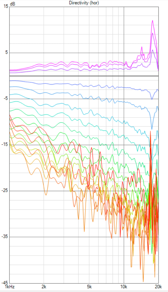

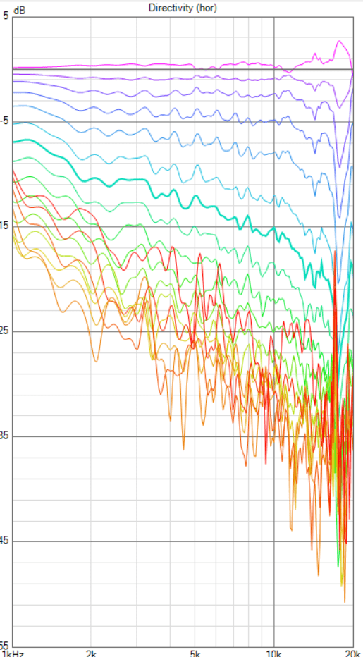

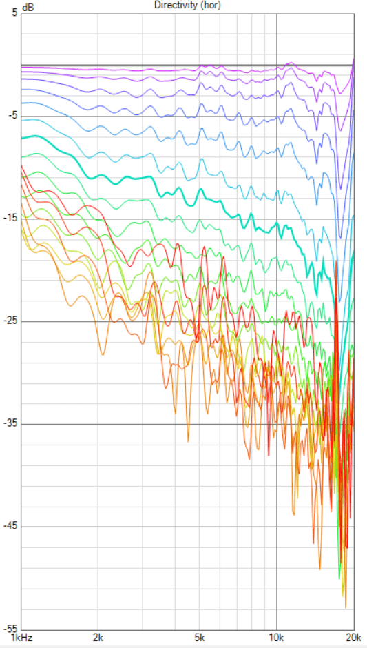

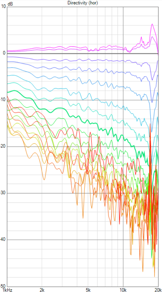

Normalized polars:Perhaps I took wrong measurements, perhaps I didn't zoom close enough, perhaps it is below noise floor or something, or the issues is such that it averages out for mic but not for ear.
if I remember these are taken without any treatment on the waveguide, just the naked print. Well, since BEM simulation of the waveguide does not show any of the ripple seen in off-axis lines, say between 2kHz and 10kHz, they must be either error associated with measurement rig, or perhaps noise from the implementation, from the print (or something else).
I could assume at least some of it is from the waveguide resonating, which seems to be audible. It is about +/- 0.5db ripple in the graph, so there is some kind of datapoint for magnitude. The ripple does not slide with frequency as angle changes but seems to be mostly the same on any (frontal direction) so it might be from measurement rig, although magnitude changes so parhaps it isn't. Anyway, just speculating about it before more data. After all it's a home measurement so possibility for error is relatively high.
+/-0.5db ripple can be had with ~-30db secondary sound mixed in with direct sound.
edit. here is the polar graph normalized to 0, 10, 20 and 30 deg.
I would try to take a multitone distortion measurement with the "finger technique". Just guessing, but perhaps the resonances of the waveguide itself are not so strong to be obvious in the FR but can modulate the radiated sound enough so that it becomes audible (?).Perhaps I took wrong measurements, perhaps I didn't zoom close enough, perhaps it is below noise floor or something, or the issues is such that it averages out for mic but not for ear. I should try mic measurement with the finger technique, as there is confirmed audible difference perhaps it is possible to now see it on some graphs as well, to get better understanding on magnitude of things.
