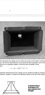

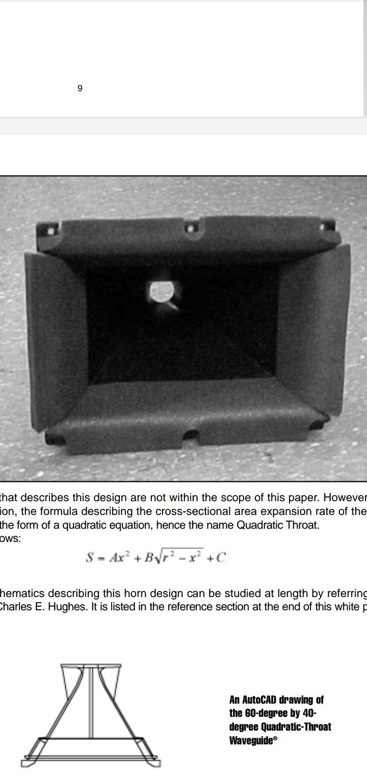

Sometimes slap on is just the right recipe. But it is still a slap on 😀
And of course there is always the option of soft termination. AKA "Mad Dog" termination (foam at the mouth). Many ways to do that and the results are certainly audible.
