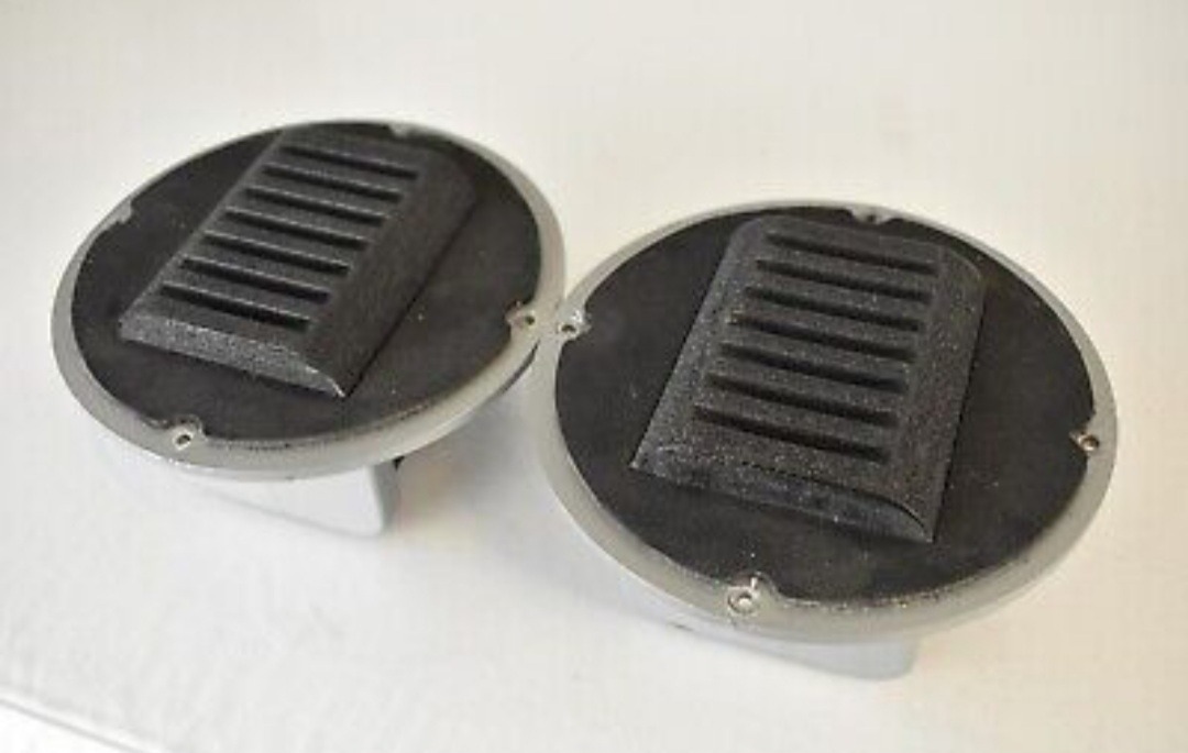

Here's a basic general idea ... Something like these. However it seems like the top and bottom are not necessarily needing to have much, since the vertical dispersion is limited anyway. And I have no clue if i should build a lens to coincide with the factory one.

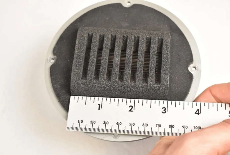

I can very quickly draw up something like that, but I'm still not clear if the front black part (the lens you mention) is removable or we need to try and integrate with it? You need to be specific about what you want, then someone can create a 3D model and you can have it produced. A good start would probably be getting a set of digital callipers because a ruler is not precise enough.
1900hz half wavelength is ~9cm so your waveguide should be at least 9cm wide at the mouth. A good rollover is a circular shape that is tangent with the angle it needs to pick up. Some waveguides use non-circular shapes and this affects the dispersion pattern but it's a good starting point.

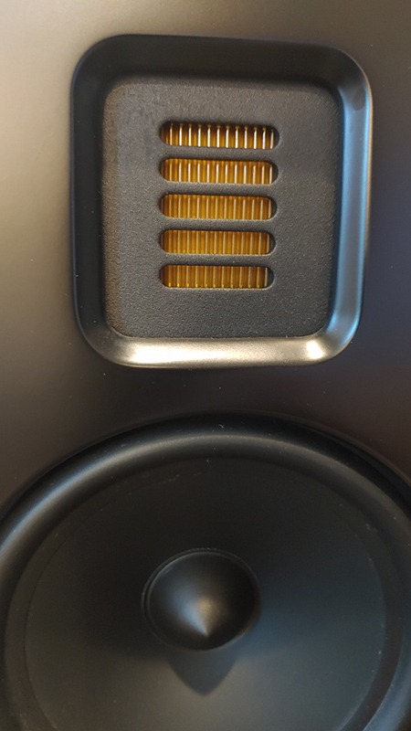

My goal is to see if a horn would possibly allow them to cross safely lower than 2400hz, have even better dispersion, and address any possible issues with FR.
Same experience over here, lovely tweeters. I have two pairs of these and they are very good when properly used but they can sound absolutely awfull when crossed too low, distortion goes sky rocket high below 2500Hz, even with a large waveguide attached I would not use them that low.
Have you measured them on various axes? They allready have a waveguide and measure pretty constant in directivity from 3000Hz on up.
Try mountng them on a wide baffle, that give some boost at the lower end. Also countersunking them in felt helps a bit.

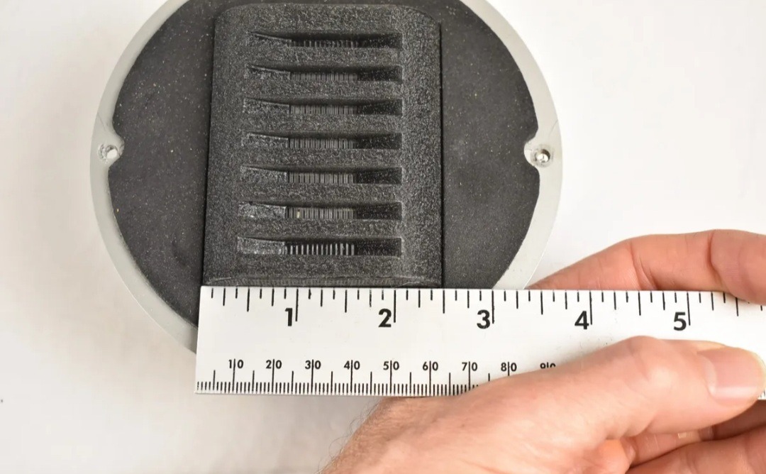

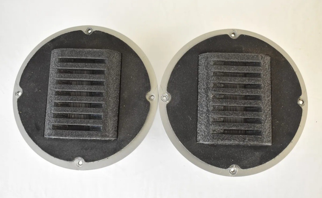

I'll start by explaining the factory flange and lens set up...
I do not see how it comes apart. However it SEEMS like the front aluminum lens probably secures the diaphragm in place.
I had assumed it would stay in place, and the angle shown in purple here would be continued for the horn mouth. Unless it's not a good angle for that. I will get the angle measured today.
I wasn't sure just where the waveguide would attach, relative to the face. Meaning on the blue line, or the red line.
As far as the faceplate. Unless the front aluminum lens is not integral in holding the diaphragm on, I can't see how it can be in the way.
But if needed I can trim the faceplate sides away, and also trim the plastic to allow something different than I must be picturing.

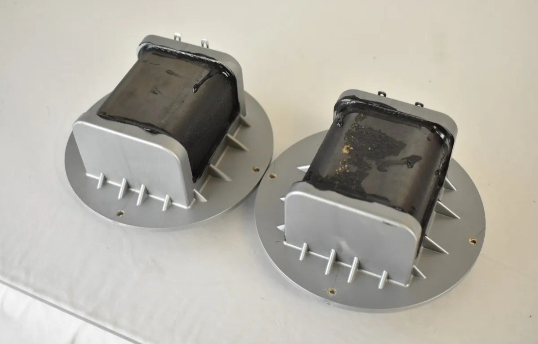

you can remove the plastic completely it is only there for mounting and for sealing the top and the bottom but that can be done with a piece of wood or other material as well. The tweeter is build out of one piece of metal tube (actually a square profile with roundovers) with cutouts on the front. There is no face panel, it's an integral part of the tube. The diaphragme is actually glued to the front. The (alnico I thought) magnet is inside, the whole tube is part of the magnet system.

you can remove the plastic completely it is only there for mounting and for sealing the top and the bottom but that can be done with a piece of wood or other material as well. The tweeter is build out of one piece of metal tube with cutouts on the front. There is no face panel, it's an integral part of the tube. The diaphragme is actually glued to the front. The (alnico I thought) magnet is inside, the whole tube is part of the magnet system.

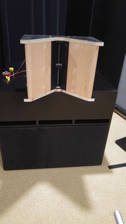

IF I made a trial waveguide, it would connect to the baffle at the yellow lines. This makes a seamless transition.
If I extended the sides, and/or the top and bottom, then those extended edges would meet flush at the baffle face.
What are you trying to say other than this?
To make only the inside part of the yellow to show through the face of the baffle is simple. After cutting the exact size rectangle, you simply chamfer the backside with a roundover bit that matches the AMTs roundover. Slides to the front and stops. Secure it there.
Then only this shows through the baffle...
I have only flush mounted the flanges. Not the entire unit. Other than the Beyma lens or Joseph Crowe approach, these two are the only ways I can imagine flush mounting them...
I couldn't draw it very well, but the example on the right is open on the top, back to the AMTs top edge. So a "V" shape cut out on top of the speaker.
I had apparently assumed incorrectly that a Joseph Crowe style horn would allow me to cross the AMT even lower. And I had assumed it would semi "horn load" the AMT. Making it more efficient.
Again wrong ...
So upon getting great advice from Sjef, I am now looking at mounting them on a wide baffle. But in a smooth manner, and much, much prettier.
I just need to know which way in my crude drawing would be a better option. May need to play with some cardboard mock ups.
