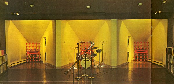

Here is some info on Sensurround
I use three of the horns in mono below 50 cycles across the front wall with the mouths venting to the floor. They are loaded with 18" drivers and have slightly modified throats and backchambers (using different drivers in them) along with being throughly braced to lower the enclosure noise. Mine are the MGA model M's

Lastly, some comments from the Sensurround introduction about the sensurround horns, though I maintain that in the case of Magnetars room size they are lacking relevance, as the horns (IMNSHO) operate ultimatly purely as monopole pressure source in the room under discussion (which is of course of little consequence at ant extent):
"Reduction of the horn mouth area was accomplished by consideration of the fact that if the horn is located in a corner, the walls and floor of the theatre form boundaries, and restrict angle into which the horn radiates. If the area into which the horn operates is small, the mouth of the horn can be reduced. With a small mouth, some attenuation occurs just above cutoff and there exists some fluctuation in frequency response. Since continuous tones were not being reproduced in this system, the un-eveness in response was not considered important."
Of course, uneven response in the frequency domain usally also implies timedomain problems, though I would assert that at frequencies as low as those discussed and in a room as small as discussed neither distortion nor timedomain behaviour is of much relevance. In fact I would argue that the room dimesions are too small to allow any significant directivity to be developed by a horn system, arguably a statement open to disagreement and based solely on experiences using Hornloaded PA systems in very small rooms (eg. practice-cellar rooms similar in size to what is being discussed here).
It will remain to be seen what the equivalent Woofer conficuration in corner mounted, equalised sealed enclosures of equal volume to the horns would provide in the 15 - 50Hz range, when compared to the existing horns in the same room and how large, if any advantage would remain for the horns and what the respective acoustic outputs would look like.

Kuei Yang Wang said:For genuine "high fidelity" I'd probably recommend a central stack of a few Shearer Horns, to get enough mouth surface and hight for good pattern control at low frequencies.
Funny you should mention the Shearer horns. I once had two of these units operating in my home. Even with the suboptimal "thrown together" set up I used - they are unique in my experience.
There is *nothing* that competes with 4m^2 of driver surface area and, make no mistake about this, I'm not talking about loudness or extension (the way I used them they fell off at around 50Hz - I used a Velodyne sub for the bottom octave.) There was an ease that I've not heard before or since. You have to hear it to know - you can't imagine it. They had faults, but this quality more than made up for them.
I'm not sure about all of the Shearer based units, but mine, made by RCA, had no rear chamber - they were designed to run open backed, mounted in a huge baffle or wall. They weighed around 200kg each and were extremely well braced.
Even these huge horns, however, I do not consider ideal. I sold them when I lost my storage space for them with the thought that someday when I have the space again, I'll build straight horns(!) of a similar size.
