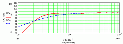

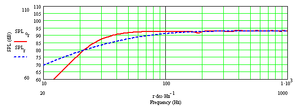

OK, I had a few minutes.
Swiping the approximate dimensions for the 2.5 cabinet from the commonsenseaudio site, and modifying them a little bit, I slapped the AN 10in driver into it, placed the driver and port as I normally would (as I don't know their location in the originals anyway), and sized the port following my usual proceedure. Result is attached. As I usually do, the LF is rolled off to compensate for room-gain. If you want ~ max flat, use a 2in long vent instead. To roll it off still more, use a 6in vent. However, I reckon the driver will still need either a notch filter, a zobel, or toe-ing in to kill the rise in the midrange. As the cabinet is fairly wide, I suspect that no BSC network will be needed, especially if positioned near a rear wall.
For reference the internal dimensions of the cabinet simmed are:
37in tall
13.5in wide
10.5in deep
7in Zdriver
33in Zport. Port is 3in diameter, 4in long.
0.25lbs ft^3 stuffing from the top 15in down.
Should work pretty nicely & have plenty of grunt down low. Impedence is mild, so amplifier load should be pretty easy, and port velocity is low, so there should be no problems with port noise.
37in tall
13.5in wide
10.5in deep
7in Zdriver
Hi Scott, yes they look good on the sim. 3 cub ft is about where I would start with such a driver. The Wharfedale Super 10 RSDDs in 2 cub ft with 3.5" dia duct were a bit squeeze boxy.
