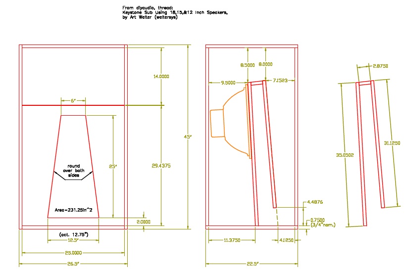

Using my Keystone tapped horn using two Eminence Lab 12, or one Eminence 4015LF, or a BC18SW115 as an example, the 15, with the least compression ratio, and hence less throat velocity, had by far more distortion than the other two driver choices. It’s cone was not stiff enough for high power and low distortion.

At the narrow end, the Keystone throat is about 69 square inches, the compression ratio in the center of the expansion is 2.5/1 for an 18" IIRC.

Based off 69 square inches with squared edges, the boundary layer thickening per velocity would start to detune the throat at ~30m/s and be completely turbulent at ~38m/s. (that's calculated with a very smooth surface, sheet PVC, if the wood is rough that number would head south a bit)
revboden,Based off 69 square inches with squared edges, the boundary layer thickening per velocity would start to detune the throat at ~30m/s and be completely turbulent at ~38m/s. (that's calculated with a very smooth surface, sheet PVC, if the wood is rough that number would head south a bit)
My figure of 69 square inches at the narrow end of the throat was incorrect, it is actually 71.875 square inches there, 78.125 mid cone, and 84.375 at the bottom of the 18" speaker.

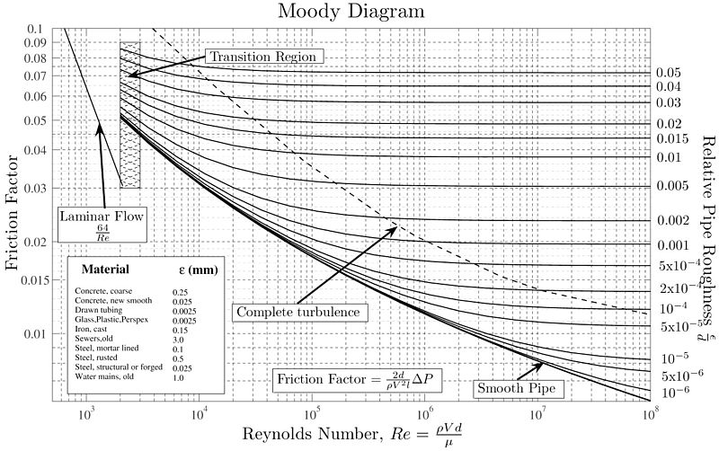

It's basically about displacement thickness. As air moves over a surface the boundary layer gets thicker with velocity so the effective size of a port or horn shrinks in cross-section while the length stays the same. For a port this will tune the port lower because it has less area vs length. As the horn gets larger it would have a higher volume to surface ratio so it would be less and less effected as the sound moved down the length.
In a completely turbulent state the particle flow is chaotic and the effects would be very hard to predict. my guess: It would sound muddled, like sound trying to get through randomly changing densities of fill.

I suck at explaining things this complex... I'll try to find a good description. This may take a while. I'll also try to come up with some simplified equations.
