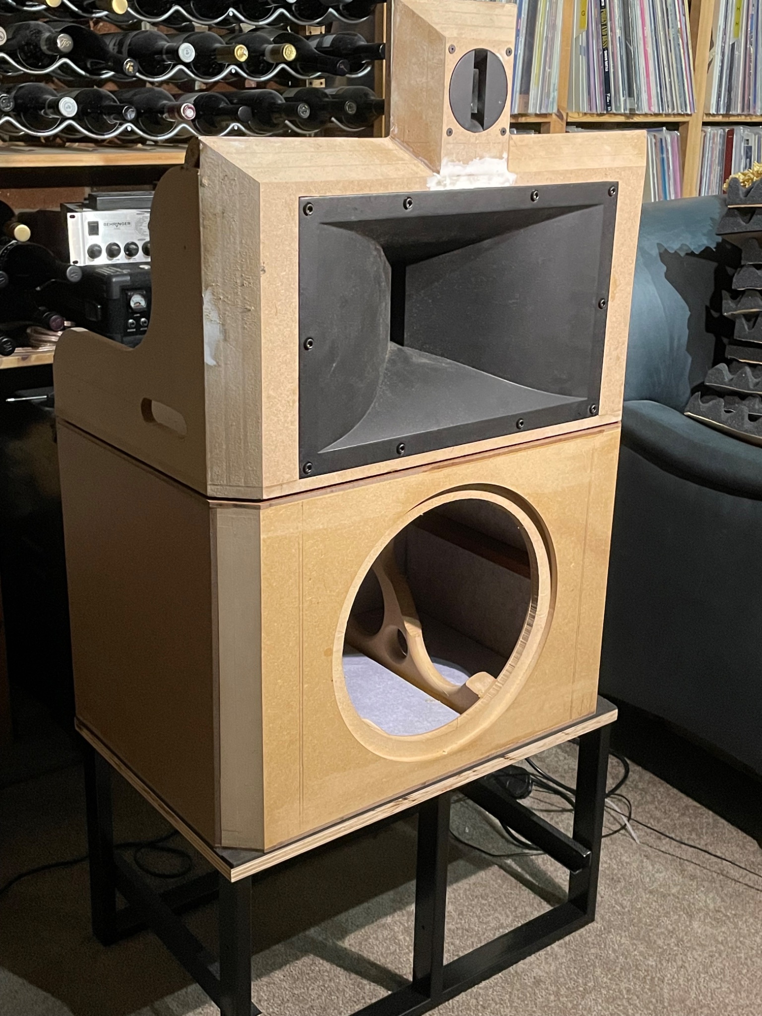

I am building a pair of horn 3-way speakers for a buddy. I have zero experience with horns but decades of diy experience with cone and dome speakers. I assumed the usual diligence with control of edge diffraction and surface reflection by building the mid-range horn loaded JBL 2452H and super tweeter JBL 077 into a suitable frame with chamfered and rounded edges. The crossover between mid and super tweeter is active dsp at 6.4 kHz, Bessel 24 dB/Octave. The drivers are accurately time/phase aligned.
Here is the issue. A single speaker measures and sounds fine. However testing the stereo pair at the listening position with pink noise, lateral head movement produces clearly audible rapid phase cancellations and re-inforcements. I determined the main culprit is the mid-range horn loaded JBL 2452H by muting the super tweeters. Each mid-range performs adequately on its own without the phase swings but not together. In effect, comb-filtering to a degree I never experienced with any conventional cone/dome combination.
I am tending to the conclusion that horn loudspeakers, whilst able to perform adequately as a single mono speaker system, will not image accurately as a stereo pair.

Have you precision aligned the mic for this? Don't feel that it will be so bad listening, but you will get cancellations measuring them this way with only a small difference in distance.
It should be easy to do with a swinging boom and RTA.

Most probably the pink noise effect when moving your head has to do with the acoustics in your room.
Horn speakers have great image potential, as many members can testify. Maybe not in a bad acoustic environment, but that goes for every type of speaker.

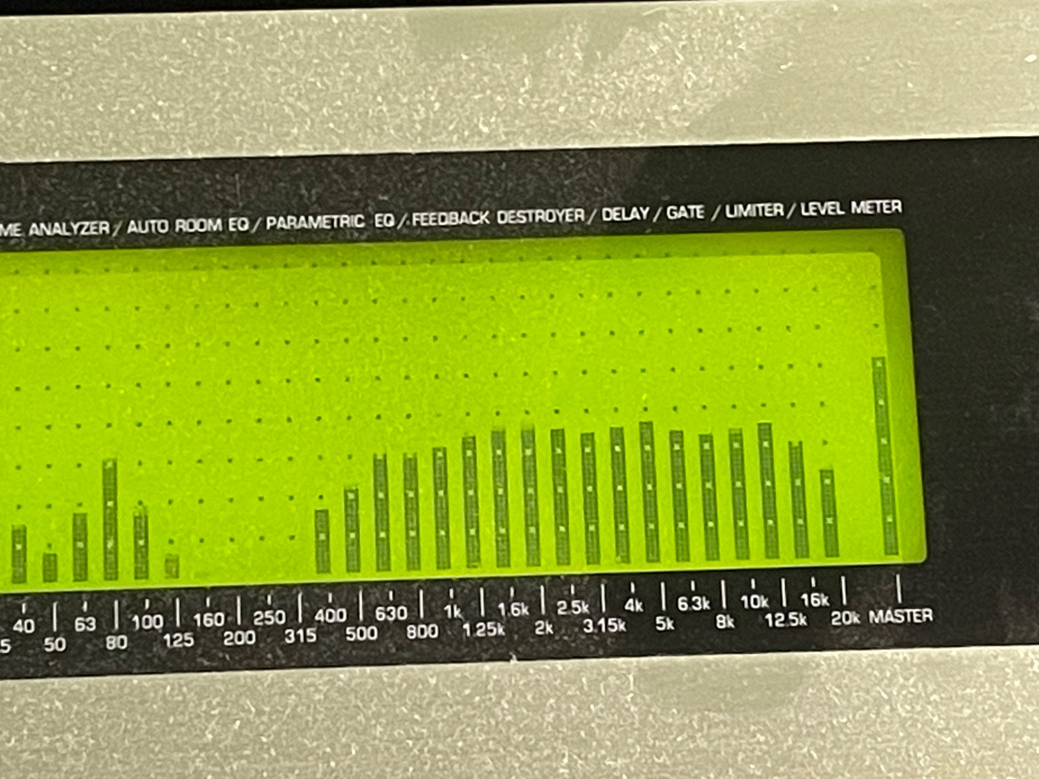

I use exactly this technique. I have a DBX RTA measurement microphone and a number of RTA. From my photos you can see the super tweeter must be delayed relative to the mid-range to bring them into time alignment. The reverse null technique gives an almost perfect agreement with the physical distance offset of the 2 driver voice coils.
Perfect in phase isn't always best. At this point I would begin guessing. I see that there could be much potential for directivity variation in your mid and tweeter region which might affect imaging with comb filtering. The only way to be sure would be to do polar measurements in various planes.

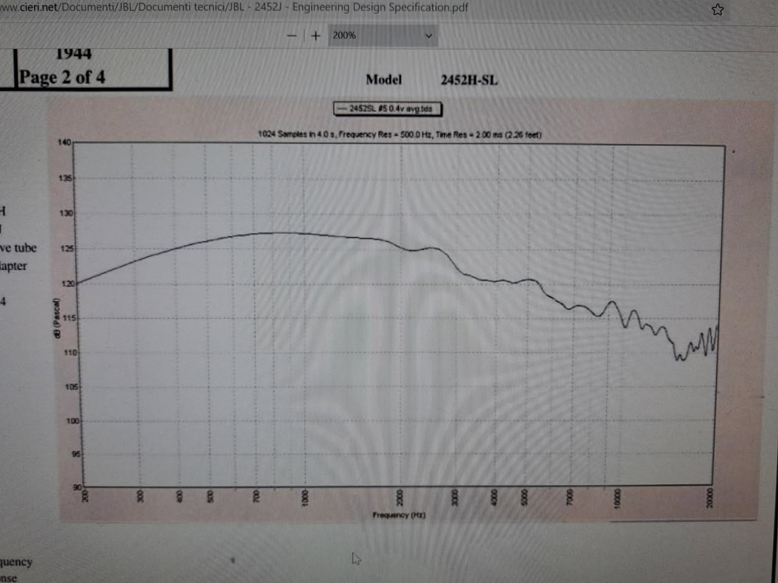

I found this FR for the JBL 2452H which agrees with what I measure on axis at 1m. It is 7-8 dB down at 4 kHz. Even at my crossover point of 4.2 kHz, it is stretching to reach the 077. Fortunately the 077 has a shelf up below 4 kHz which compensates for the mid-range fall. They sum quite nicely at 1m on listening axis, without any EQ.

It should, the lateral movement varies the path length distance between the speakers, which always causes that effect.
The same phase cancellations and re-inforcements (comb filtering) would occur with any two speakers with correlated (mono) pink noise.
Most peoples hearing will be most sensitive to the comb filtering in the upper midrange (2-6kHz) covered by the mid horns.

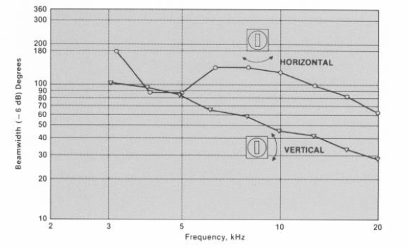

The slot tweeters have wider horizontal dispersion than the mid horns, at 6.4kHz almost 140 degrees, (wider than many dome tweeters) so you hear more side wall reflections, "filling in" the peaks and dips.
The mid horn has much higher and more defined directivity in the upper midrange than most domes.

I find the opposite, an "accurate image" is more likely with more defined coverage patterns that avoid wall reflections.
Differences in stereo program and room reflection details are more apparent.
That said, the mid horn diffraction slot is located several wavelengths behind the high frequency slot.
The different points of acoustic origin will result in a wonky (inconsistent, comb-filtered) off-axis horizontal pattern in the crossover overlap region, a problem not shared by a typical cone/dome arrangement. The Bessel has the widest, most gradual crossover region compared to LR or BW filters, increasing the width of the "problem region".
That response is a 2" plane wave tube measurement, note that SPL at 200Hz is equal to 4kHz.
It should not agree with the measurement on your horn.
The 2452's upper on-axis roll-off on a bi-radial horn should start ~7kHz, similar to this graph:

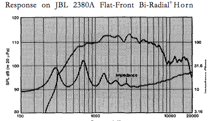

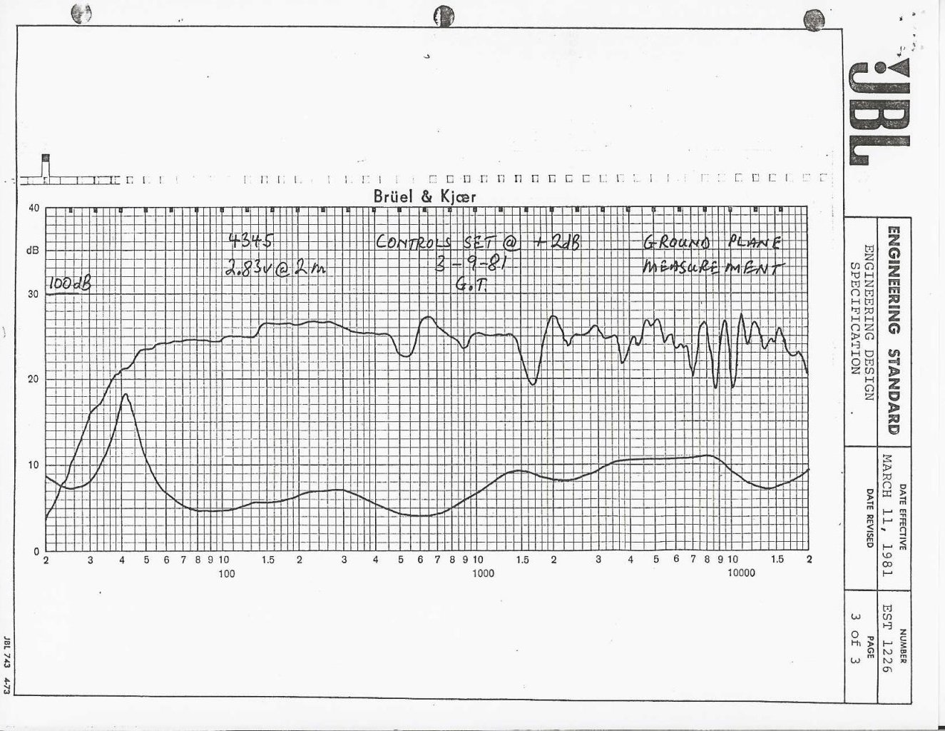

So you are using the 2380 without CD compensation. As previously stated you should be using the 2380 without EQ as your reference plot. This is the effect of path length differences in a 4345 between the 2405 and the mid-horn. You can see the comb filtering around the 10K crossover point.

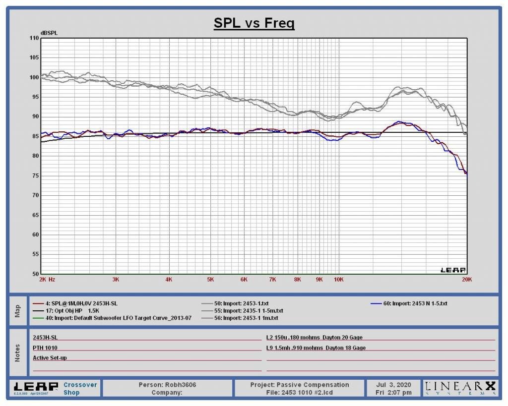

Well yeah of course they do. That's the mass roll off point. You are using a CD horn. That is the expected response. The on axis response follows the drivers response. An exponential will EQ the on axis response based on the increase in directivity as frequency rises. Two different animals. You can easily EQ the 2452 by attenuating the midrange response. You should really have some attenuation.
