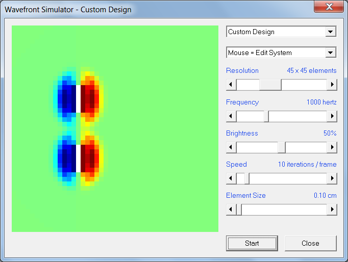

Can I simulate several drivers placed at certain distances, each with same or different frequencies in hornresp's wavefront sim?
It would be interesting to see how different placements alter the wavefront etc.
Sorry if question has been covered, I have not searched for hours, there is just so much hornresp info out there that I am overwhelmed.
You can simulate multiple drivers with the same frequency.
It is also possible to specify different time delays for each driver. See the Wavefront Simulator section in the Hornresp Help file for details.
