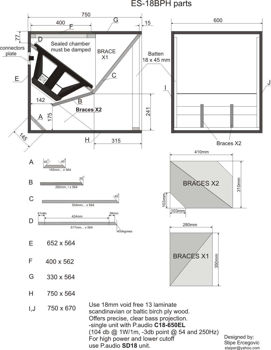

I want to make ES18BPH.
The simulation data posted as under.
Esbph 18 by Stipe
s1= 801
s2=087
con=12
s3=1400
con=28
s4=3676
con=37
vrc=79.6
lrc=54.5
fr=0
tal=0
vtc=51330
atc=2915
I want to understand how the LRC & atc is calculated.
ES18BPH
How to simulate 4 cabinets of same type to get max power output? .
