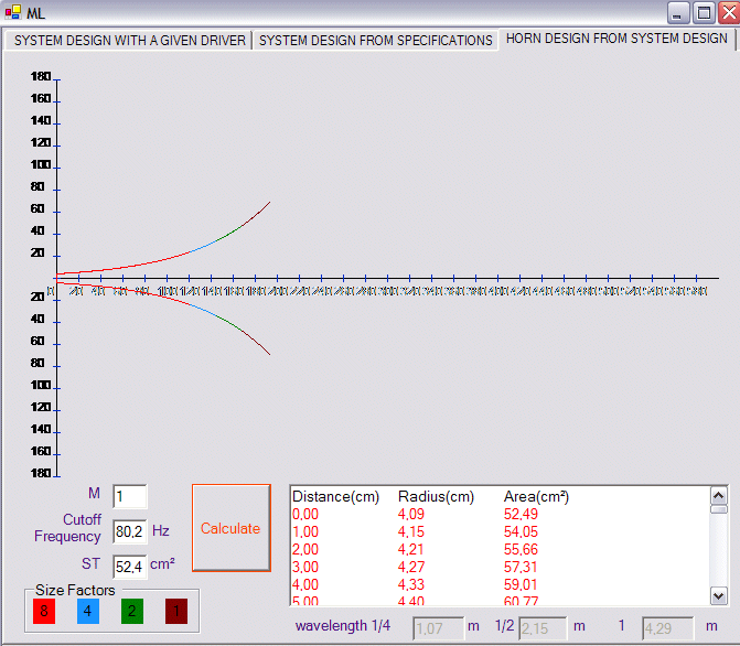

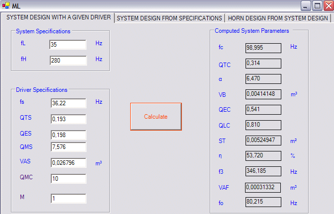

Hello,
just another horn question again 😀
I'm still busy designing a back-loaded bas horn for use in my living room. It's getting a bit confusing, because there are several ways to calculate the throat area.
I tried Leach's and Edgar's models and the equations from the BIG FUN article, but the results are different.
For example, with Edgar's method, i get a throat area of 36,78 sq. cm.
According to the BIG FUN article, i should use throat to driver ratios of 0,3 to 0,7 * sd, resulting in St=64,92 to 151,48 sq cm. Leach gives a throat area of 26,57 sq cm for a 50 Hz horn.
I already tried different values with hornresp, but i can't get a very smooth response for a BLH.
Could anyone tell me which method i should use for my BLH??

One other method to check up your results is to use the ML util found on the fullrange driver website. It applies Leach's theories to horn design and it to is quite accurate when you work within its design limits.
Mark

Look for : ML Util.zip
THis is an easy way to apply the Leach math.
Mark
