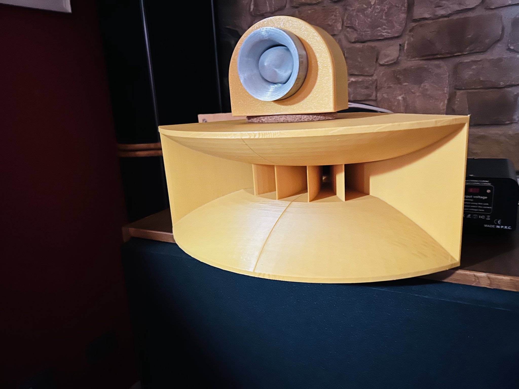

HI,
I bought a drawing of a Yuichi A-290 horn.
I know that the best solution would be to mill it in wood with a CNC, but the cost is very high..
I tried 3D printing them and they don't look bad, but I'm not sure I set good printing parameters.
Can good results be achieved with 3D printing?

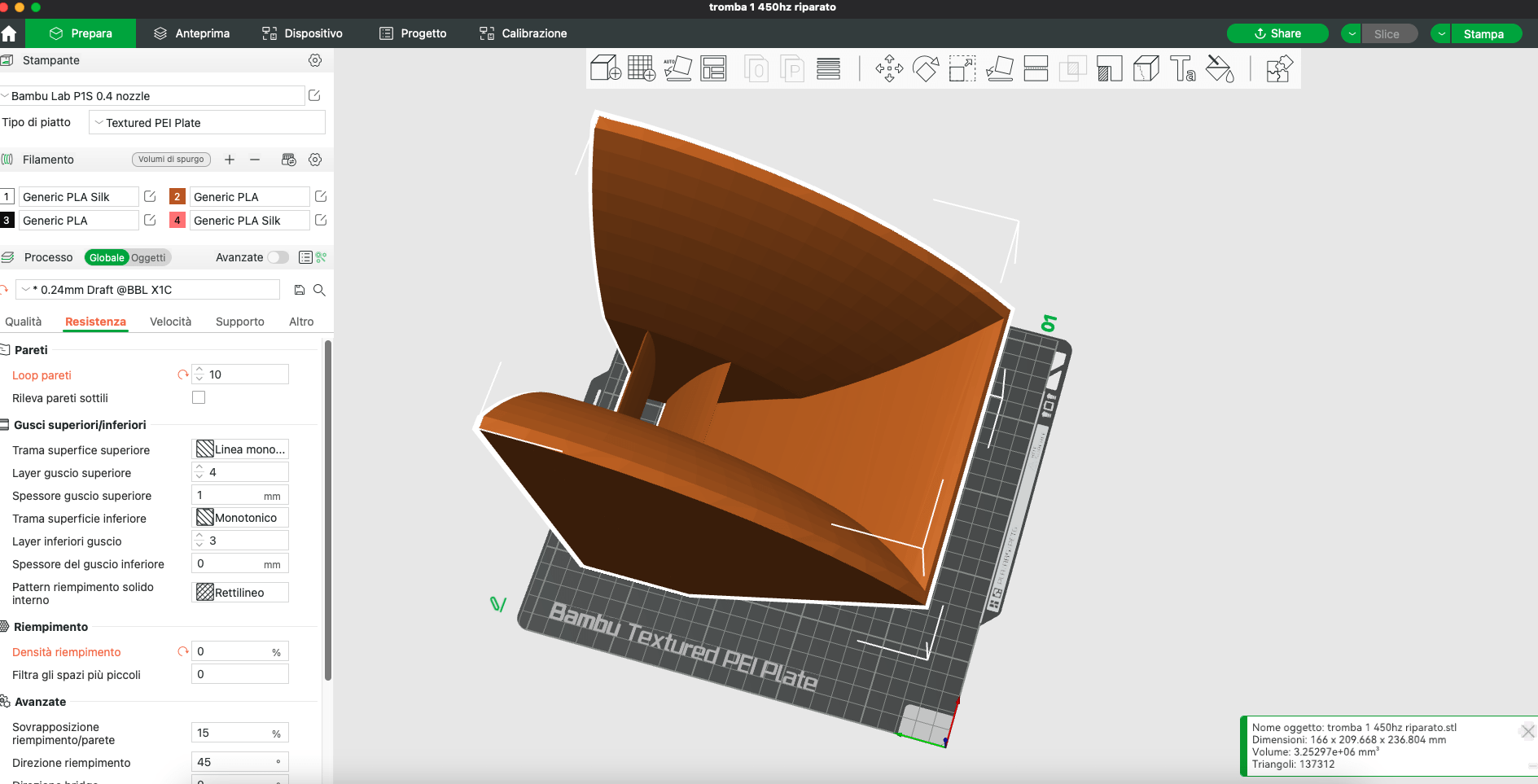

I was thinking of trying to print them again, empty inside, with 10 wall shells, and then pouring some plaster inside...
could this be a good idea?
the drivers are jbl 375 and the printer is a bambulab
Thanks and sorry for my English..

This approach shows a way to make it in wood without CNC:
https://www.araihorn.com/p/arai-290.html
Although more precise, it takes a long time to 3d print something like this. You have the right idea to print a low infill model, but I'm not sure plaster is the best filler material.
I'd go with the DIY wood approach. In the end it will also look more attractive. But it depends on your woodworking skills.
Thanks for the replies, you are very kind
I printed them months ago, but I made them with 30% infill and I think something was wrong.
I would like to try to reprint them, it should take 2 days if I use 2 3D printers, otherwise 4 days.
I had thought about chalk, a very dampening material, but if there are suggestions I will gladly accept them.
I bought the project from Joseph Crowe and in the file there are 4 different sized horns with different cuts.
I chose to print at 450Hz, which was sufficient for my 500Hz cutting.
If I were to try to make them out of wood, I would probably make them bigger.
I'll try to look at the link you sent me, although unfortunately I'm not very good at woodworking.
I searched on Aliexpress, they seem very nice, but the shipping prices are very high...

yes, it is possible to print it with 0 filling,
but I think I made the wrong size of the trumpet..
the one I printed is the 450hz,
and with my 375 driver which is 2 inches with crossover at 500,
I think it's right to print the 300hz with 50x50 troath size...
I attach the link to Joseph Crowe, where I got the project.
Is what I say correct?
Thank you
https://josephcrowe.com/products/custom-yuichi-a-290-biradial-cad-model-make-any-size
Thank you
