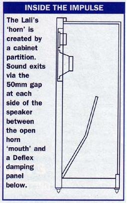

With the internal deflector in place its not firing at the floor but produces a 360 degree radiation pattern.

Yes, theoretically you "could" have true, but in the reality it works very well! Listen to the Impulse loudspeakers!
Ron has true: with (and without!) the internal deflector in place its not firing at the floor but produces a 360 degree radiation pattern. You could imagine like the hornmouth is located near the floor and opened along the 4 sides of the cabinet.
I wouldn't like to open a discourse about why is it good or not, rather I would like to concentrate for the calculating-modeling solutions. 🙂
Tyimo

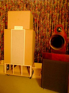

The bottom-firing horn, a technique elegantly deployed by among others Dr. Bruce Edgar in his "Monolith Horn". This is potentially a very effective approach, in that it wraps the mouth around two or more sides of the cabinet. For the bottom-firing horn, we can easily obtain a very large mouth opening by wrapping the mouth around four sides (both sides and front and rear), and mounting the horn on stands of appropriate height. We'd need stands of just enough cm height to obtain the same mouth area.
