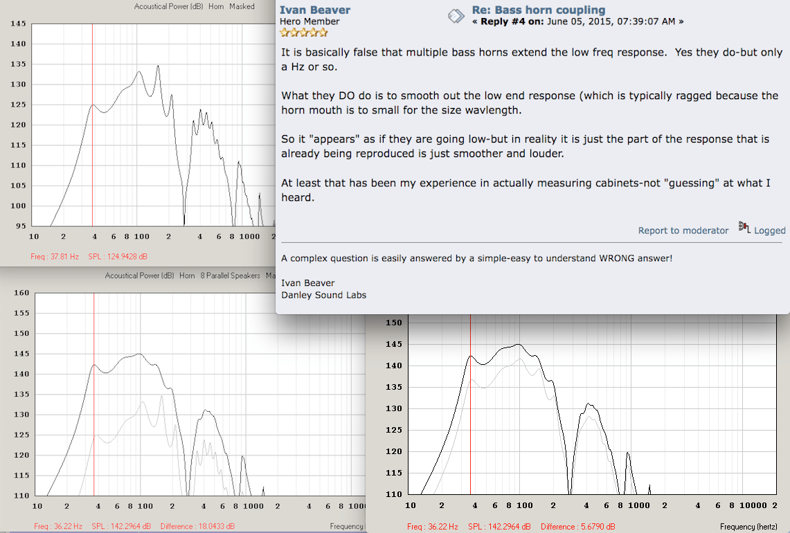

A horn array's increased mouth area increases LF efficiency, but it's Fc (cutoff frequency) is still determined by the horn path length, which is unchanged in multiples.
I don't think you will find an actual measurement with the low corner dropping more than a few Hz below the horn Fc when used in multiples.
That's actually wrong. Stacking horns increases the acoustical impedance and does indeed extend the cutoff frequency significantly, ie the Martin W-bins go ~10-13 Hz lower in a stack. It depends on the construction and principle, for example, tapped horns usually don't profit much from stacking in regards of extension but in spl per unit. If TH are stacked in a too big cluster, they can even lose performance because the horns low extension can create a phase shift with the direct radiated sound and cause a cancellation. Same on horn reflex or horn hybrid systems.
They do not have 100 dB at 100W, they have 100dB at 1 W!
Yes sorry I should have typed 100 dB sensitivity WITH 100 w RMS power handling.
I've literally built tons of FLH bass cabinets and compared hundreds in outdoor stacks and flying configurations, Martin being one manufacturer that I have had particular interest in since back in the late 1970's.
A stack of bass horns does increase the acoustical impedance, but your assertion that their cutoff frequency extends "significantly", much less ~10-13 Hz is simply not backed with actual measurements or simulations.
The array's low end increases in relative level to the upper response, and smooths response compared to a single, but the cut off frequency does not change more than a few Hz even with eight cabinets.
As an example, this simulation of a typical single undersized mouth front loaded bass horn designed for use in multiples has a low corner frequency of 37.81Hz.
The difference in the low corner going to four cabinets is hardly visible on the chart, with 8 units the cutoff has dropped by only 1.59Hz to 36.22.
As Ivan Beaver wrote: "it "appears" as if they are going low-but in reality it is just the part of the response that is already being reproduced is just smoother and louder."
Ivan has measured a lot more horns than I have before he took the job as the chief engineer measuring and installing Danley Sound Labs front loaded and tapped horns more than a decade ago.
If you expect multiple cabinets to extend the cutoff frequency significantly, you will be quite disappointed when you measure their response.
Yes, I totally agree, the depth of a sigle bin got almost the same cut off frequency as a stac,. I never disputed that and I agree the usable lower frequency of a single w-bin is closer (much closer) to a stack. But the context here is to bring the reality to someone who applies (and expects) HiFi-standards.
When you wrote that FLH cutoff frequency (Fc) drops ~10-13 Hz when used in multiples you disputed me saying it won't- you wrote "That's actually wrong".
Now you totally agree that the Fc does not drop ~10-13 Hz 🙂
Glad we could clear that up..
The reality is the EQ required for a single FLH and multiple FLH are quite different, but Fc is not much different.

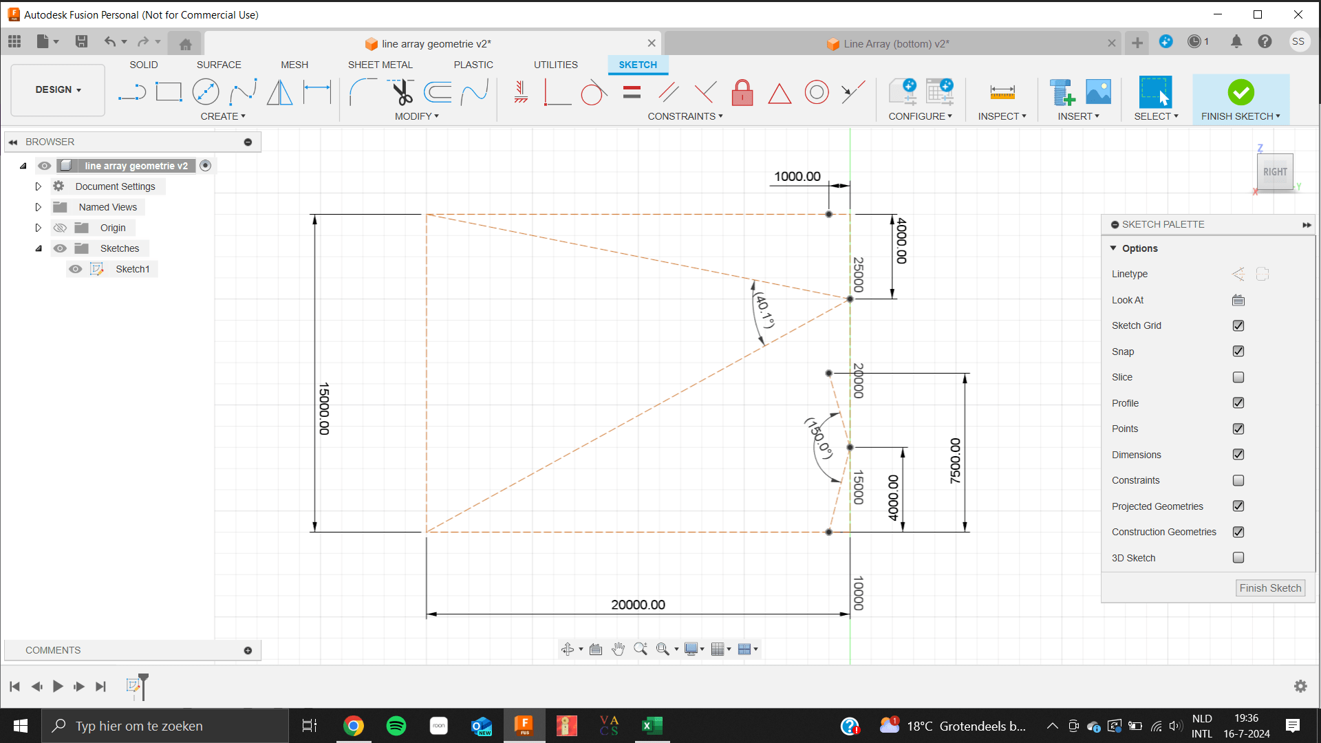

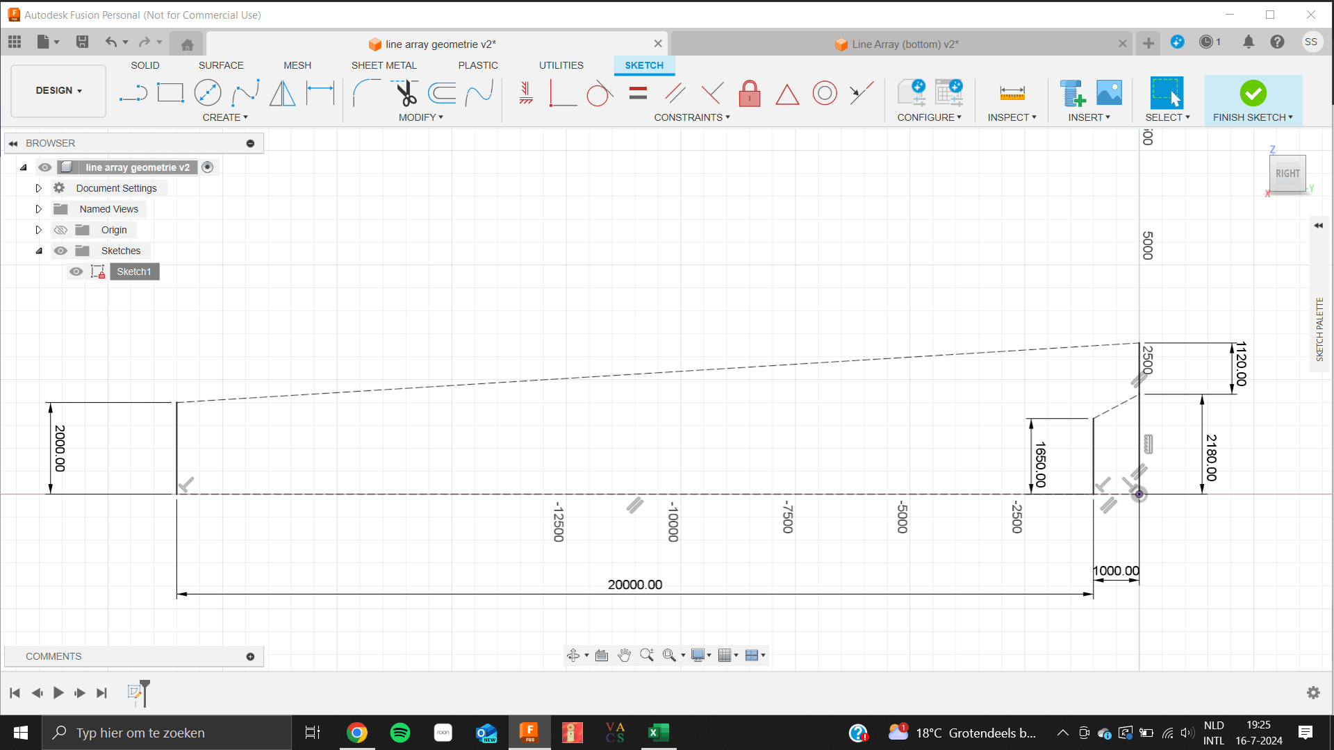

As far as I could find out it seems that adding a slight curve to the cabinet helps evening out the polar behavior of LAs? This was anyway my intend. I made up the maximum venue/area size I think I would probably take on and put it in Fusion to calculate the requered angles. The vertical dispersion would have to be 24 degrees to go from a short persone standing in front to a tall person standing in the back.
To reach the width off the venue at the back (for which the top tweeter would be responsible) the dispersion would have to be 40 degrees. Yet to reach the whole front line it would have to be 150 degrees so as wide as possible. Which is a problem. So idealy the top tweeter would have a waveguide tuned for more directivity and the bottom tweeter to be almost direct radiating and having the wave guide gently transition between the two WG geomitries over the length of the cabinet. L Acoustics deploys something like this. However to properly match the dispersion of the tweeter and midrange at the crossover this would mean either each layer of drivers would require a different XO frequency or the midrange would also have to be matched by wave guides. Both of which would make the whole a lot more complex but it's something to think about.
I'm now trying to learn about the phase behavior of LAs. But just reading about it I find it hard to understand so I'm hoping to get a better understanding by vizualising it in simulations and see what happens when I change things.

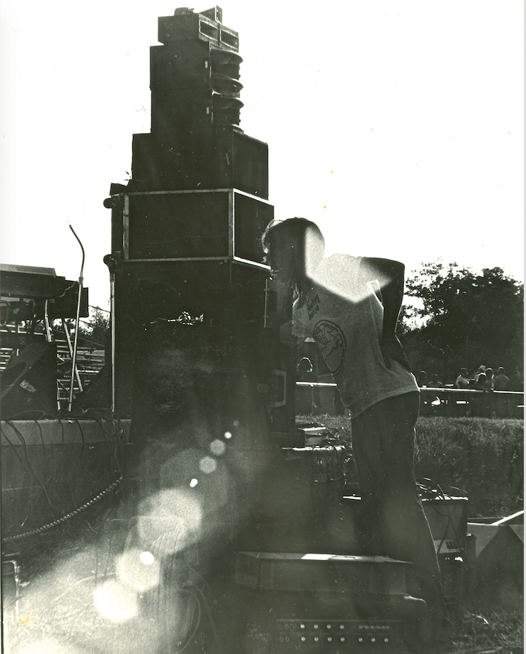

I was a bit younger when when I started building vertical arrays:
Almost a half century ago..

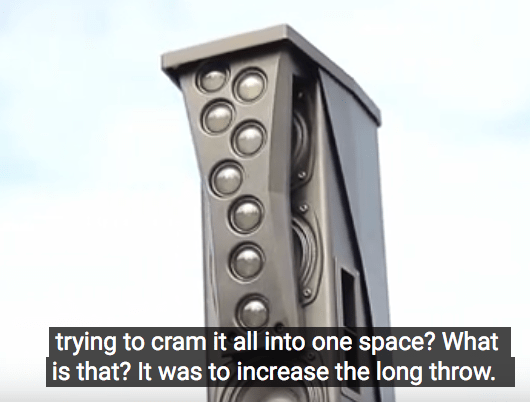

The Nexo ID84 is a more current example of good way of doing what you'd like to do:
Although Devin is a bit "Nexocentric", he puts out a lot of very good information.

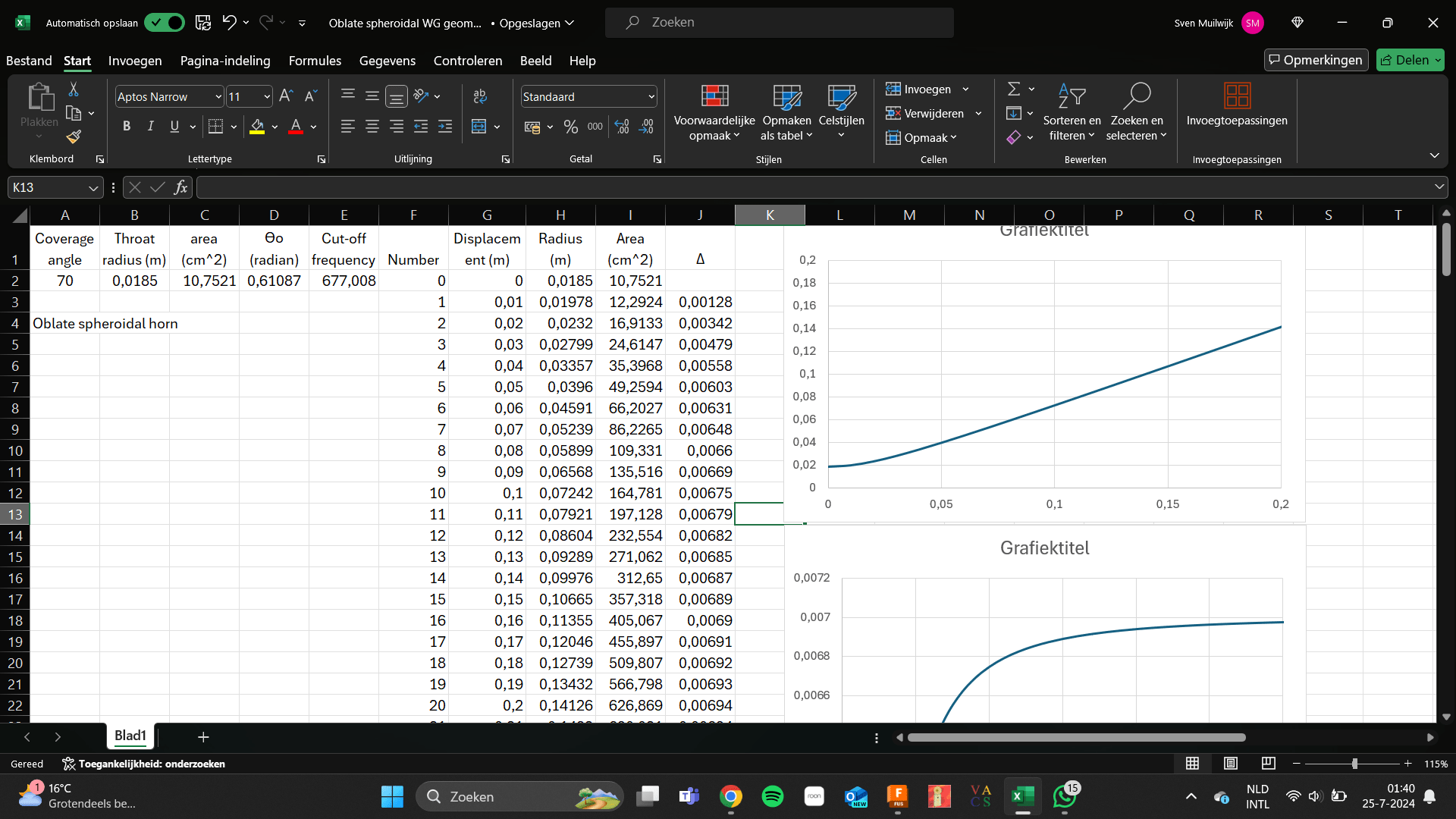

Hello there, I've been learning a bit about horns and did some first simple calculations to get an idea for the required horn dimensions. For the tweeters I've landed on a oblate spheroidal waveguide as is said to have low distortion and good, even directivity while also offering good loading. Kind of the best of both conical and exponential horns. I've made a program in excel where I can visualize a horn geometry based on given requirments. But now I'm wondering. All of the formulas that this is based on are for cillindrical waveguides yet the waveguide that I need will be rectangular. To keep the same performance from the waveguide. Do I simply stay with the section view geometry of the round horn and stretch it out? Or do I need to recalculate it to area?
The horns for the mid bass will probably be hyperbolic with T around 0,5~0,6.

Though when I was playing around with a exponential horn graph. I noticed that the bigger the throat, the shorter the horn could be. Which seemed counterintuitive to me. Shouldn't the throat be smaller to achieve better loading with a given size horn?
The shorter the horn the narrower its BW, so for a given flare frequency/factor you can 'slice' a section out of it to make a shorter horn like the pioneers did such as the Altec A7 (110 Hz 'slice' out of a 55 Hz flare with an upper cut off around 338 Hz, the originally intended driver's upper mass corner (Fhm = 2*Fs/Qts where all box design theory peters out) and similar.
