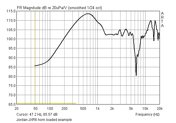

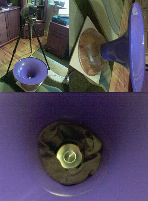

Horn loaded JXR6 seems to be promising. As expected the amplified frequencies lies on 2Fs/Qe=~500Hz. CSD is very good - better than disc like enclosure I made without taking care of vibration control.
See:
1) Disc like enclosure, ground measurement:
http://ucz.tme.szczecin.pl/~jacek/temp/Measurements/JXR6_vibration.gif
2) Horn loaded:
http://www.audiostereo.pl/zalaczniki/676751_1.gif
3) Rise time example:
http://www.audiostereo.pl/zalaczniki/675250_1.gif

jxr6 resonance at 2800 hz? 😕 was thinking to use this for front horn.. will this break up be noticeable?
Don't waste time on horn loading - phase cancellation is huge. Better take 8" or 12" bass driver from Bandor. Horn requires compression driver.
Ah ok- I have only seen the jx92s in front horns - so the smaller driver wouldnt work.. I wanted to try it in an Oris type horn or rectangular horn down to 250 hz or so, then cross over to a 15" pro speaker in a BR
Larger JX92 will be even worse. Do you have any SPL plot for Jordan+horn? It will have falling response and large dip on the mids. Whizzers are different - it's like horn in a horn. Usually such a fullrange in a front horn sounds unaturally big. I don't have Jordan but have 350Hz horn so I can check with 2" fullrange if I find one.
