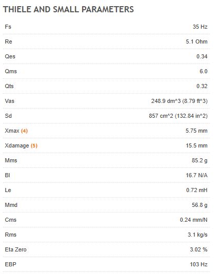

Drivers are Faital Pro 15PR400 - specs attached, (4x at hand) driven by ICE 125 DSP amplifier/XO (at hand).

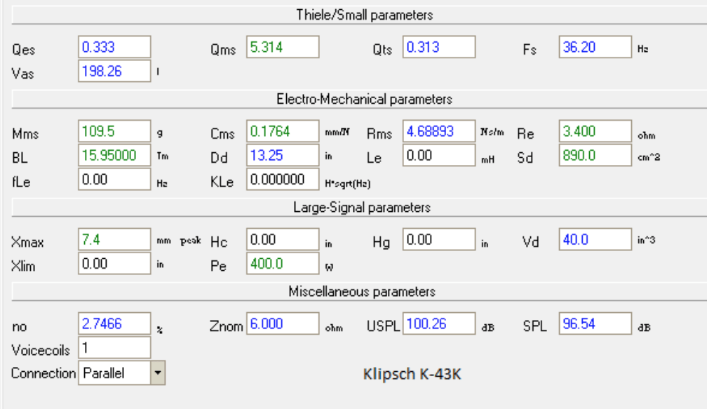

The Klipsch MWM folded horn response is +/-5dB from 42 to 500Hz.
From my experience, and any available measurements and simulations I think it would outperform all the cabinets on your "short list".
It used K-43 drivers, which have similar TS parameters to your Faital Pro 15PR400.
The cabinet is fairly easy to build.

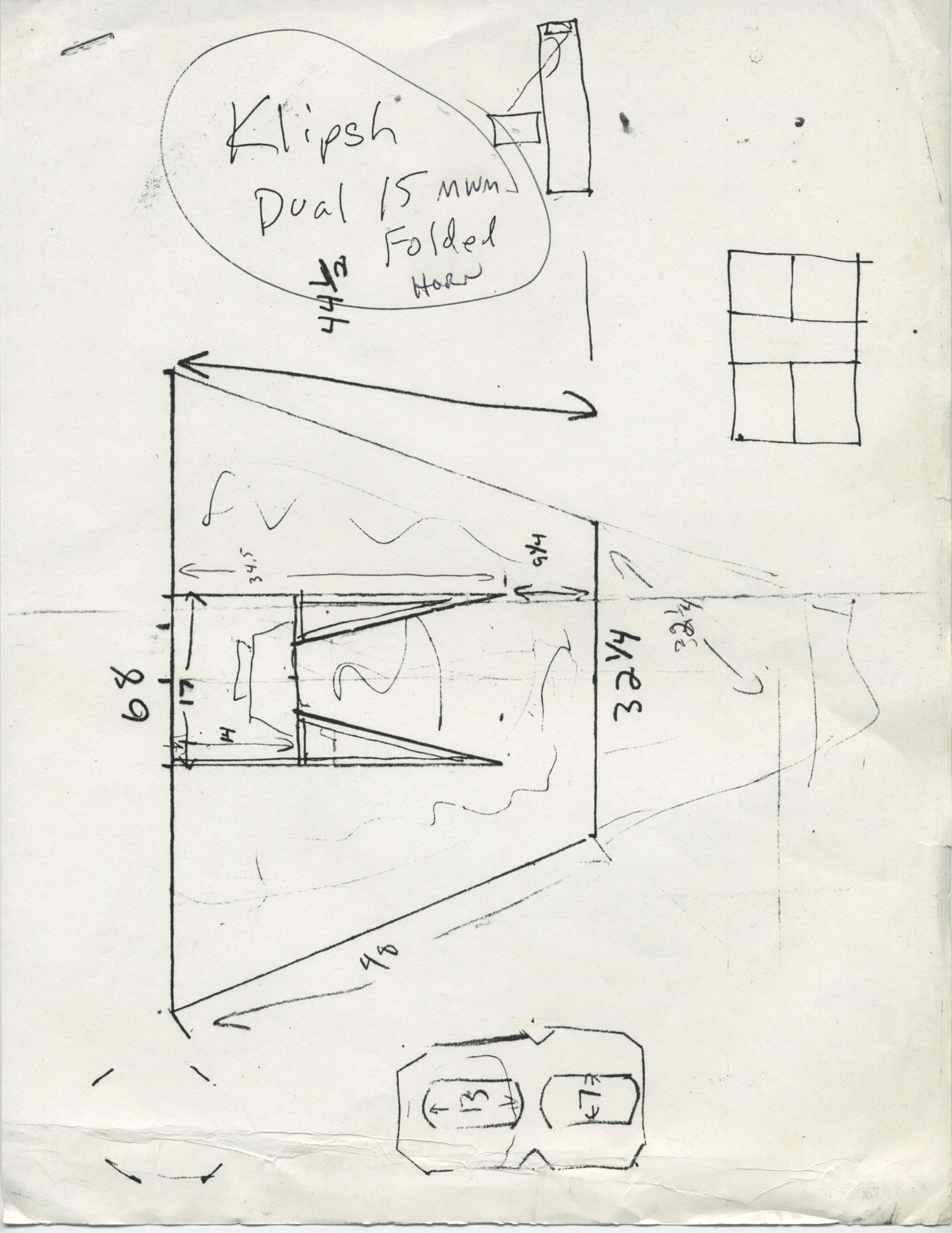

I took measurements when I rebuilt a pair that were involved in a truck accident in the mid 1980s.
3/4" plywood was used throughout. The 44.5" depth allowed two to fit in a standard 90" truck box.
The exterior height was 32.25", 30.75" interior.
The Faital Pro 15PR400 are 15.47"diameter, so would require a bit more height, or a slight recess cut in the top and bottom of the compression chamber. It's baffle cutout diameter is 14.02", increase it from the 13" noted.
If I recall correctly, the original speaker used double fiber gaskets, so 1/4"-1/2" "donut" standoff gasket will probably be needed to allow full excursion of the 15PR400, or a 1/4" depth round circle routed in the baffle.
The triangular baffle cutouts in the speaker baffle increase the compression chamber volume, connecting it to the triangular chambers either side of the initial horn flare.

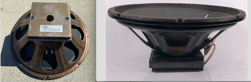

CTS became Eminence, their 15162 PART # K-33:
RE OHMS 3.39
FS HZ 34.46
LE MH .96
MMS GMS 78.59
QM 7.39
CMS mm/N .2714
QE .410 RMS NS/M 2.3037
QT .390 VAS LTRS 301.66
XMAX MM 8.20 SD SCM 889.59
BL TM 11.88
EBP 84.4
The center braces are not shown, but basically divide the cabinet in half. Half versions (the MWM 1900) were also available.

Your drivers Mms is in between the K43 and the K33 cones that I heard, the K33 being lighter than yours.
Higher Mms drivers with similar Xmax generally have stiffer cones.
If pushed hard below Fc (horn cutoff) or Fb (Frequency of box tuning) light cones deform or tear, like the K33 example below:
K33: CTS driver.png
Note the K33's extended gasket depth compared to your drivers.
At any rate, with your PWR-ICE12 you can HP the woofers so that won't happen, and EQ the response to fit your preferences.

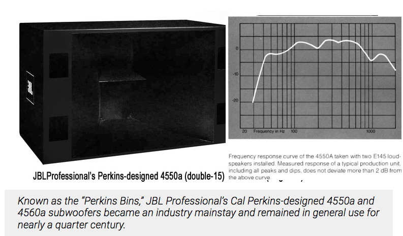

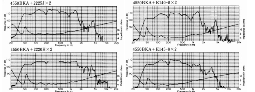

If I were considering a large 2-way horn system, my preference would be a straight horn with bass reflex porting, like Cal Perkin's 4550. The TS parameters of the JBL E145 drivers used in it are also similar to your drivers, though even less Mms than your drivers.

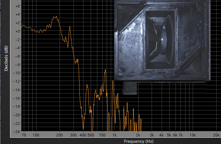

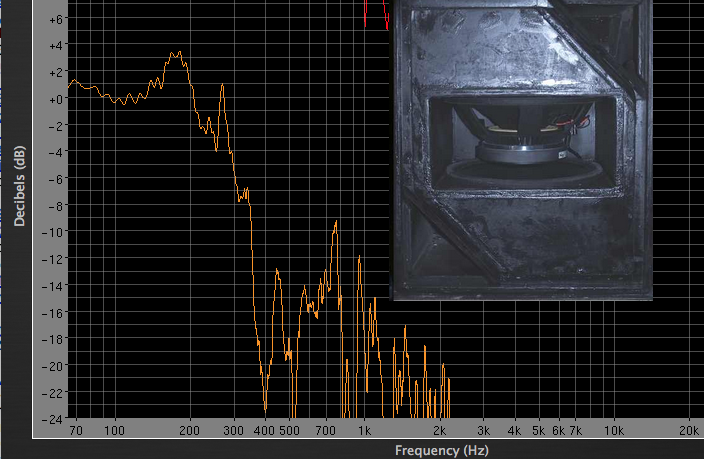

In my opinion, the compromise of bass reflex from Fb to ~100Hz where the bass horn kicks in is more than compensated by the smoother, time aligned response in the crossover region. The 4550 can sound quite good up past 600Hz, relaxing the excursion demands that are placed on the high frequency driver when crossed within an octave of Fc.
Anyway, getting the low midrange and crossover region to sound good is critical to any system, but it's a lot easier to do with straight horns than folded horns.

Are you familiar with the PPSL concept? (Push-pull, slot load) Using twin 15PR400 per side will give you some tremendous output. Will also give you a cut-off much lower than 50Hz. The only caveat to this concept is the upper frequency limit. I'm not so sure about getting as high as 350Hz in a linear fashion. Having said that, some experienced builders get fine response as high as 400Hz. It's all about the details in the construction of the plenum. The PPSL is like a 1/2 step between a direct radiator bass system, and a full blown horn system. Of course, a proper horn reins supreme, indeed, but to get satisfactory bass, will be quite large. A 50Hz cut-off with a steep slope (like bass horns are) will be missing the low bass ambient cues that make music so enjoyable. Only my 2 cents worth.
Yes.
Those builders used smaller drivers, which use smaller plenum cavities, which can push the usable upper limit above 350Hz.
The above outdoor half space ground plane response was of a cabinet using the minimum plenum volume possible with two 15" drivers, I'd consider the response much above 300Hz unusable due to the first -24dB cavity null at 400Hz.
Other than the added air mass, narrow band resonance peaks and dips the plenum causes, and reduction of even order harmonic distortion, past the near field there is virtually no difference in the response of a PPSL and a standard bass reflex with the same Fb.
Art

The bifurcated horn path of the MWM would put the bottom half too far away from the HF horn to properly integrate.
If the MWM was built as the 'full version' and stood on its side with the M/HF horn mounted to the side?. ~180cm 'high' is okay and the reduced footprint makes it an acceptable physical fit.

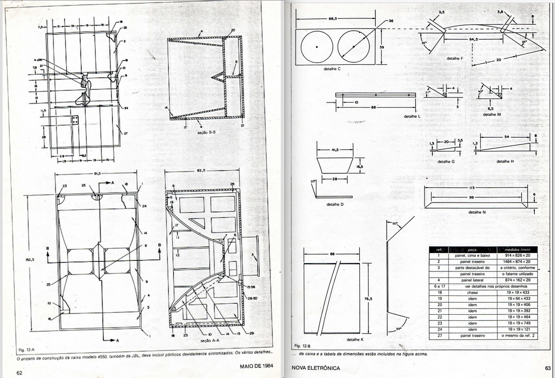

I will have a look at the Cal Perkins 4550.
Thanks to all. Much appreciated.
That would be better than the horn on top, but lateral "imaging" will be weird, drifting left to right (inside/outside) above and below the crossover range.
The side wing volume could be moved to the bottom of the cabinet, and the box made trapezoidal to better fit in room corners if desirable:
The ports could be extended to reach deeper than the original tuning above 40Hz Fb.

These Nova Eletronica 4550 plans from 1984 omit the ports used in the 4550A:
Anyway, easier to customize the 4550 to fit your desires than the MWM.

The 4550A look good to me as-is. 91cm height is okay, overall proportions are good and preferable to MWM.
I understand what you say about the straight horn being easier to integrate (and integrate better), so for overall presentation this is probably where I want to be. The depth of the cabinet lines up with the length of the M/HF horn. I dont know much about the inner workings but from the cut-out it looks likes the drivers are 'less loaded' compared with MWM, and considering previous about 15PR400, I guess this can only be a good thing.
I know it's only You Tube, but I get a good impression from what I hear - that effortless open bass is there, from what I read its properly horn loaded down to 100 Hz, BR below and with no sub required as per the brief.
JBL 375/075/4550 (youtube.com)
JBL 4550BK/2440/2360-Hartley 24”-Ampex 6446 (youtube.com)

With the 4550KBA cabinets, I like the look, the legacy and from reading around it seems people really like them. I can hear in the those you tube clips what I liked about the La Scala bass (limited as it was) and also a copy of the azura 50Hz bass horn (J shaped) - that very same thing, it's where I want to be, and on balance it seems the lowest-risk. I'll paint them (matt) black 🙂
The further your ears are vertically off axis of the 2x15", the more comb filtering (peaks and dips resulting from the difference in distance between the drivers and your ears) is audible. My preference would be the center between the top cone and the HF horn be at ear height.

Your drivers would be OK with the MWM's 7" throat width driven to Xmax, but will have less loading stress (and SPL output..) in the 4550 design when pushed near Xmax.
