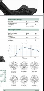

How come the RCF HF950 can have a lower cutoff than that of 400Hz at half the size of the SEOS-24? What’s the catch?
...and how does the HF @ the diffraction throat sound in real life?
I don’t know, I haven’t heard the HF950, but the measurements look pretty good and many have raved about the sound quality of Peter Morris’s PM90 that uses it.
But I suspect your question was more rhetorical - so feel free to elaborate why the smaller size of the HF950 would give rise to diffraction issues at the throat.
Yes people do rave about the PM90. I've never heard it. However looking at the actual horn that throat pinch is pretty extreme. In all my armchair exploration of CD horns this is frowned upon by the SEOS/hi-fi crowd due to "HOM" distortion or whatever. People who want 130db+ seem to have different expectations.
InOtIn, as I understand it, the 400Hz cutoff is for horn loading, not dispersion, and this is related to horn depth. Both the SEOS and the HF950 are about 8" deep IIRC. I wouldn't think the HF950 can hold its horizontal pattern below maybe 1.2kHz, with it's width being under 12 inches. The PM90 is not much wider so it is probably omni at the crossover.

This isn't true. The conical doesn't have a cutoff frequency as such. It is noted for where it lets go at the mouth.How come the RCF HF950 can have a lower cutoff than that of 400Hz at half the size of the SEOS-24? What’s the catch?
I wouldn't call that loading down to 400. Just some liberties taken when doing the marketing. Take a look at the spec sheet curve.

So the HF950 is comparable to the same size SEOS-12 when it comes to holding directivity, which makes sense based on physics.

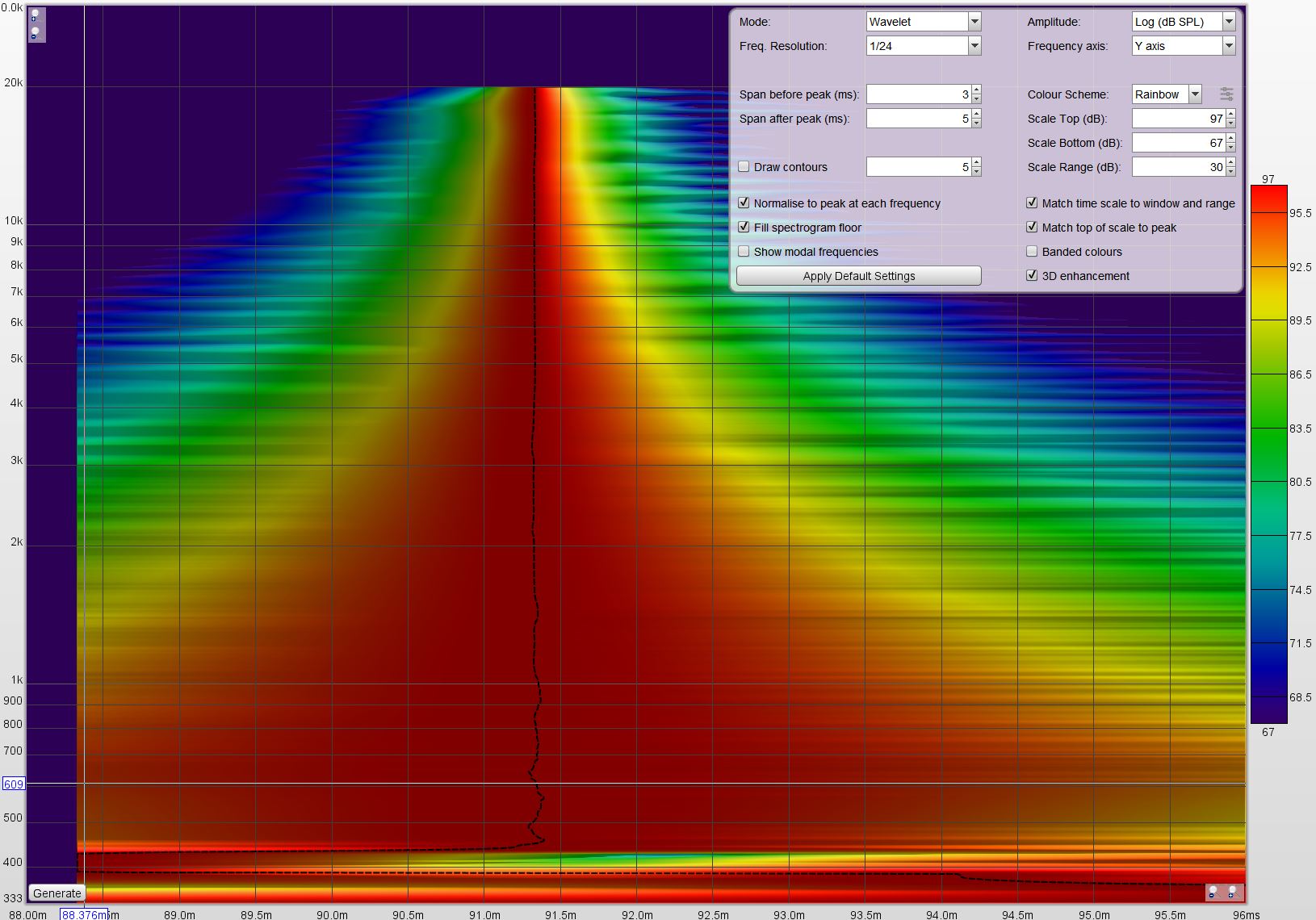

Hi all, I know this thread is about finding the best pattern control down low, but i thought some still might like to see some shameless on axis tuning of the 4594he on a XT1464.
I'm trying to see if I can measure horn reflections back into the throat...don't even really know what measurements to look at for that...been studying spectros and impulses as a start.
Anyway, in trying to do that today, I ended up with the following close range tuning.
Highpassed at 650Hz, 96dB/oct, and crossed to VHF section at 6300, same order.
