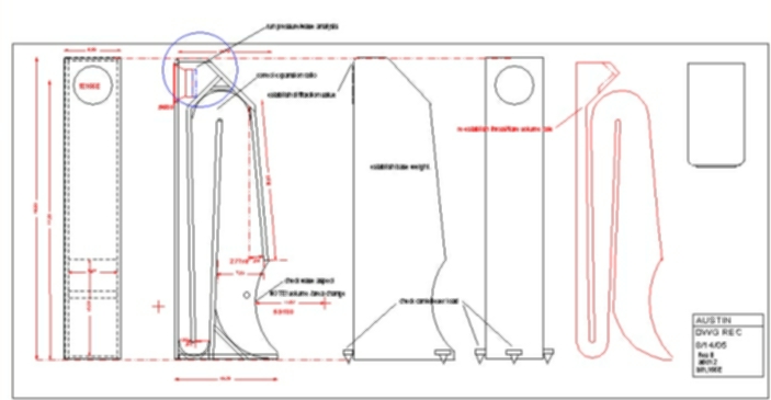

Personally, I would not use any sound damping material in the folds or path length. Consider a 1/2" thick Styrofoam disk glued to the back of the magnet, the same size as the magnet. Also, search for Planet10's FE103a mods for some more ideas. All these things can be done after the horn is built.
Too bad your not starting with the FE166e, you could have built Ron Clarke's latest design. The Austin

Kitty litter..........I just happen to have 2 kitty's.........I wonder if they'd mind? I guess if I scoop and sift first, or do I use 'brand new'...? No really, that's a good idea. (man, I can see those cats scrambling out of those horns when I fire up a little Bach or Haydn!!!)
That 'Austin' is a different-looking conbobulation. Between me and my young crew, I'm sure we'll experiment and try several designs.
