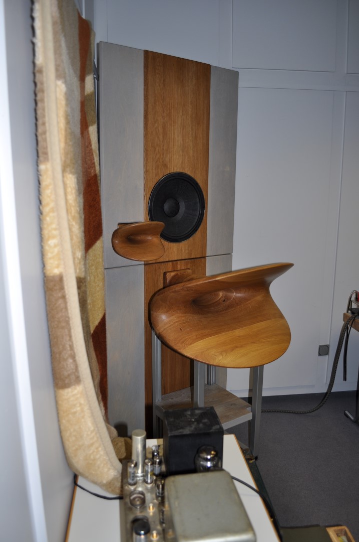

When i wen thru my HF horn period i used tractrix, Le' Cleche is sort of an evolution on that. The mid & top Horns at this ETF is an example:
833988d1586898843-horn-design-help-etf_2013_070_large-jpg
Danley’s synergys are kind of boring (& conical), but solve the big issue of the (relatively) huge issues with C-C and the timing issues usually only solvable with DSP XOs.

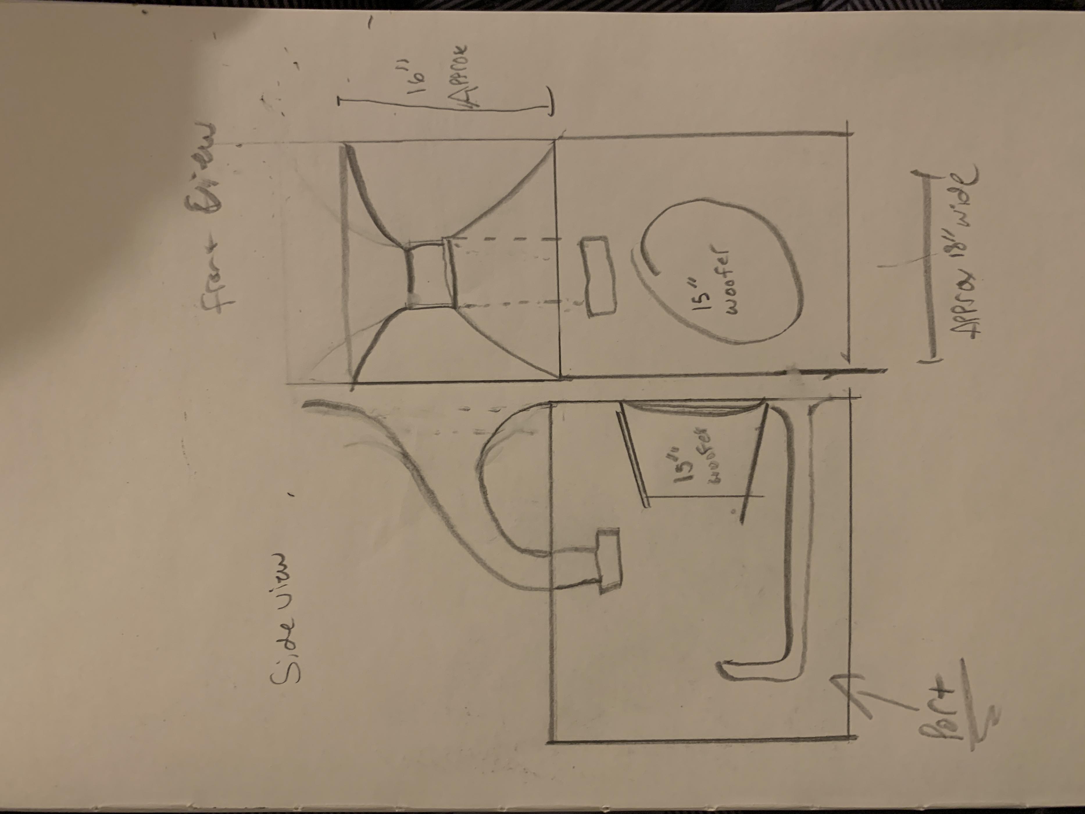

My goal is to first design a two way loudspeaker that can compete with the heresy and Cornwall. These speakers are somewhat limited by their size. I’d like to design a horn with a 90 degree bend but I’m not sure how it would affect the sound wave as it propagates through the horn.
I would like the horn to handle 400 or 500 hz to 20 kHz or thereabouts. I’ve seen some designs that can do this I’m just not sure which one to use. Here is a photo of what I’m thinking. It has a curved horn that starts in the woofer enclosure and juts out the top and bends 90 degrees. I want it to be on the larger side, and I could add a tweeter on top if necessary, but I’d like to keep it a two way.
Correct me if I’m wrong, but the throat diameter affects the high end losing right? A larger throat means it won’t be able to play as high? Is this feasible at all to design a horn that can cover this frequency range? Here is a photo of a quick drawing I made to show you what I’m thinking of.

My goal is high efficiency and decent coverage. I had klipsch la Scalas and they sounded pretty good wherever you are in the room and they “fill the room” with sound.
... a two way loudspeaker that can compete with the heresy and Cornwall…
Been a long time since i heard Cornwall, the Heresys i had sucked.
Not likely gonna happen. A really good horn will do 3 1/2 maybe 4 octaves.
ie 400>800>1600>3200 Hz
or 500>1000>2000>4000
Above that it becomes a direct radiator
Are you sure they are not waveguides.
dave
+/- 5dB wow that is not good. I like the work Joseph has done, he has been at it for many years.
One of the issues with horns above a direct radiator is the large centre-to-centre (in an ideal world, less than a quarter wavelength at the XO point). Another issue is the different launch points, only fixable with a DSP XO with time delay well set.
One can minimize the issue of mid/top horn by designing the mid horn so that you can mount the tweteer inside that horn as part of a centre divider. Still need the DSP XO.
I would not put much stock in the Klipsch specs, they are pretty much written by the marketing deptarment.
And the stock Klipsch XOs cause huge problems with impedance, which is a big issue with high output impedance amplifiers (typically SE amps, the largest population of which are SETs). I know this does not have to be the case, someone pointed me at an aftermarket XO that acheived fairly flat impedance — but with REALLY steep roll-offs which further exacerbates the phase & timing issues.
I don’t want to discourage you, but there are big problems to overcome, and you have much to learn. Keep asking questions, then you have to make some stuff, and that will take some time — likely years, not months.
You need to read everything you can get your hand’s on and ask lots of questions.
All speakers are full of lots of compromises, the one thing that systems as you propose is dynamics. The efficiency advantage, if you don’t get the XO right is that most of the small amps want to look into a flat impedance curve.
Lots of peopel seen to enjoy their systems like this. I have yet to hear a good one, i would really like to.
And that brings XO issues. Passive XOs are hard. Harder than designing a horn IMO.
