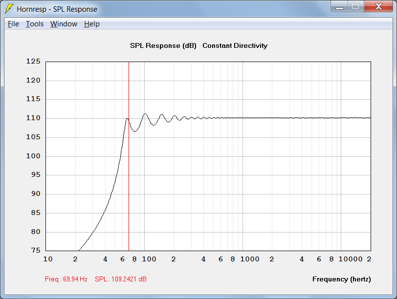

Hi HP8903B,
You were too quick for me 🙂.
I deleted my response shortly after posting it because on reflection I became concerned that the "rule of thumb" I quoted might give you a false sense of security. If you do decide to adopt the rule however, please note that the final performance cannot guaranteed and that it will depend greatly on the actual driver used and the dimensions of the horn. This is why simulation programs can be so useful.
Just for the record, in case others are interested, the "rule of thumb" I quoted for an exponential horn was:
fc = fxo / 1.25
The value of fc so calculated should be considered the maximum permissible cutoff frequency, with a lower value preferable if possible.
I have attached a screenprint showing the response of a sample 56Hz cutoff exponential horn with Eg = 0 as mentioned by Jean-Michel.
EDIT - You beat me again!
Kind regards,
David
David,
Thanks for the clarification and the graph.
Yes I understand. There are other factors involved in the actual performance.
From looking at the graph, 70Hz crossover point with 24dB slope loosely follows the horn's slope.
The horn's slope doesn't effect the filter's slope (crossover slope) much.

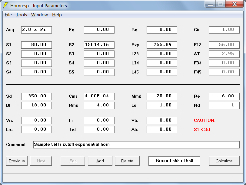

What did you enter for the drivers parameters to get that graph ?

Hi HP8903B,
Setting Eg equal to zero in Hornresp gives the driver diaphragm a constant rms velocity of 10 cm/sec. The only driver parameter value that then affects the response is Sd, and all it does is to change the absolute level, not the shape. In my example, the driver parameters were left at the default values. Note that the response shown is that of the horn only - the 70Hz crossover filter has not been applied to the response.
The input parameters I used in my example are shown in the attached screenprint.

Thank you
Could you clarify what "Cir" and "AT" are ?
I don't understand the description.
Also, what does 1 for "Cir" and "2.2" for "AT" mean ?

Hi HP8903B,
Cir = 1 means that the axisymmetric (circular) horn mouth has a circumference equal to one wavelength at the horn cutoff frequency, when the mouth area is normalised to free space conditions. If this still doesn't mean anything to you then simply remember that ideally Cir should have a value of 1 or greater, to reduce the impedance mismatch at the mouth. The horn will still work with smaller values of Cir, but the amplitude of the ripples in the response will be greater. Horn design is all about compromise 🙂.
AT = 2.2 means that the flare tangent half-angle at the horn throat is 2.2 degrees. This information is useful when wanting to exactly match a horn to a compression driver.
