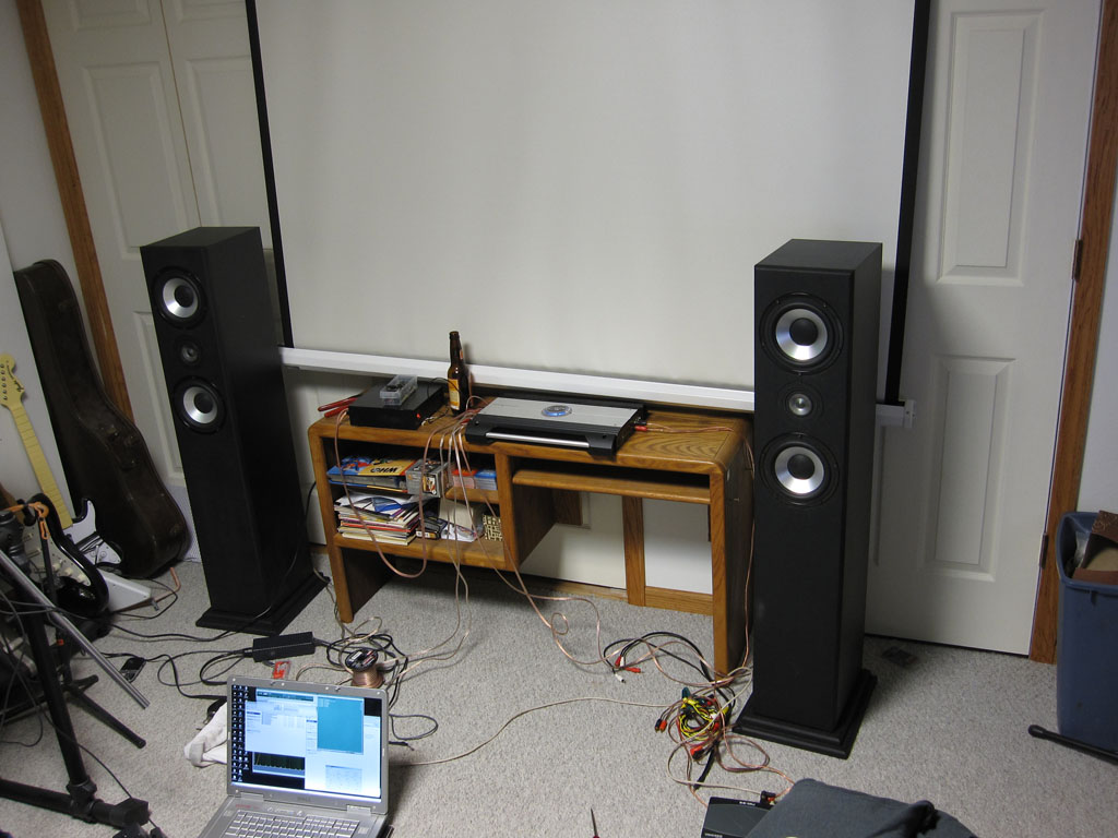

Weee! built! No crossover's yet, so just doing initial impressions with the crossover in the amp. LR4 at 400hz. I think I'm going to aim for more like 800, but they already sound pretty damned good. going to be doing some emulation with the LspCAD demo here pretty soon.
I'll probably post a thread on the whole project once I have the crossovers finalized. I'm going to be building a matching center channel for these, and some rears channels that are comprised of 2 chr70s each.
So far, these sound really great. More to come

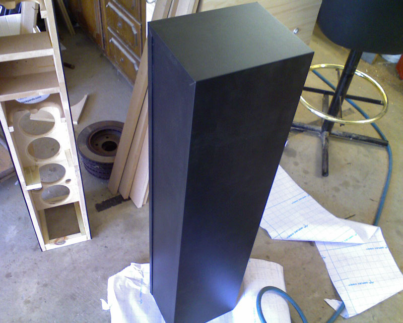

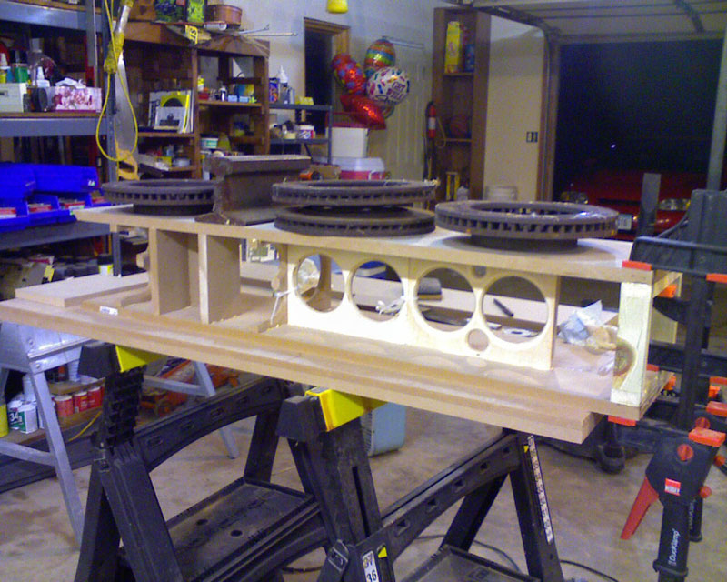

By the way, what are those little 'houses' on the left pic in #21 post? They are in which part of the whole speaker?
They are the sealed chambers for the Alpair5 mid-tweet. You can also seem them in the shot of the cabinet being glued together

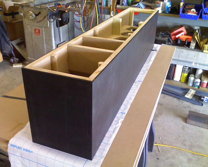

Regarding the crappy cabinet I previously posted about, I took it to a friend with a speaker building shop in his garage, and we made it usable. It looks a little bit like a patch job, but it'll do for now. In the future I may buy a MTM cabinet from PE to replace it, I would just need to install a chamber for the Fostex driver.
