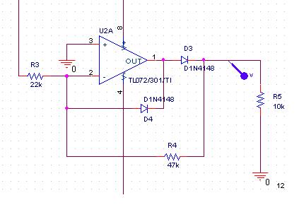

My Evil: I am sorry that I didn't check yours out in greater detail. The first schematic has some interesting things. However, I am not sure if XX1A does anything other than adding a diode forward drop on its input. That I guess is what you were trying to achieve as the voltage rise is then offset by D3.
XX1B and D4 almost formed a precision rectifier, except the diode is out of the feedback loop.
Here is what you will typically see out of a textbook and in reality.
R3/R4 and D3 follow the feedback loop for opamp U2A. an A/c source is applied on R3. During the negative cycle, current is flowing U2A's output, through D3 and then R4 to create a positive voltage on R5. The output voltage depends on just the current going through r3 and the value of R4, and has nothing to do with the the forward voltage drop of D4.
D3 is there to provide a discharge for current going through R3 during the positive cycle.
As you can tell, the output is just half wave. You can create full-wave rectification by suming the input signal with the output of this precision rectifier. But it makes no sense to do this for the purpose of VU metering.
