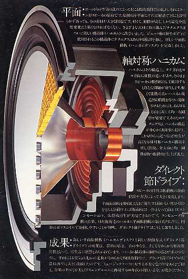

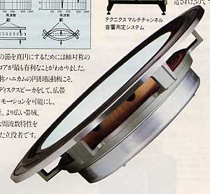

Going back to the beginning of this thread, I have a set of the wall mounting speakers (SB-50, I think, I'll have to unpack them to see). They are about 12" square and 3" thick, basically the same form factor as the Technics SL-10 turntable (the 12" square, linear tracking arm model).
The drivers are concentric: The centre is a tweeter with a slotted grille design like a B&K measuring microphone. It was used in several Technics models. The next diaphragm is a bass/midrange. It forms a ring around the tweeter, with two surrounds - one on the inside edge and one on the outside of the ring diaphragm. The voice coil is mounted directly on the back of the diaphragm and the magnet assembly is ring shaped. The outermost diaphragm is a passive radiator (ABR or "drone cone").
As has been pointed out, the flat diaphragm technology was used in more conventional cabinet styles as well, with separate bass / mid / tweeter.
The top line flat diaphragm bass drivers used the technique of mounting a large diameter voice coil directly on the diaphragm about half way between the centre and the edge, and used a large ring shaped magnet assembly. Thr cheaper bass drivers used a conventional voice coil assembly, with a short cone connecting the voice coil to the back of the diaphragm at the "half way" position. In both cases, the design was intended to apply the driving force at the midpoint of the diaphragm to reduce bending forces that would be caused by attaching a small voice coil to the centre of the diaphragm.
as in Technics SB-M1:
as in Technics SB-10:
Graaf,
That is exactly what I meant. Thank you. Note also that the image for the SB-M1 shows how attaching the voice coil about half way out from the centre, rather than at the edge (or at the middle), reduces the flexing of the diaphragm.
The driver in the "wall mount" speakers looks similar to the M1 but has a hole in the middle of the diaphragm with an inner surround, and the tweeter is mounted in the hole.

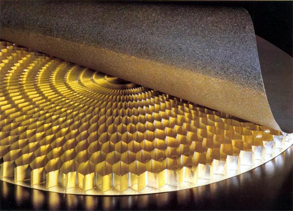

Getting back to honeycomb information
I'm in an interesting position where I don't need drivers to listen to, I need them for instrumentation; as perfect a piston as possible and the honeycombs look like they might have been the best practical approximation for a given range. Finding something I can buy, no matter how rare, is [probably] easier on the research budget than building something from scratch.
