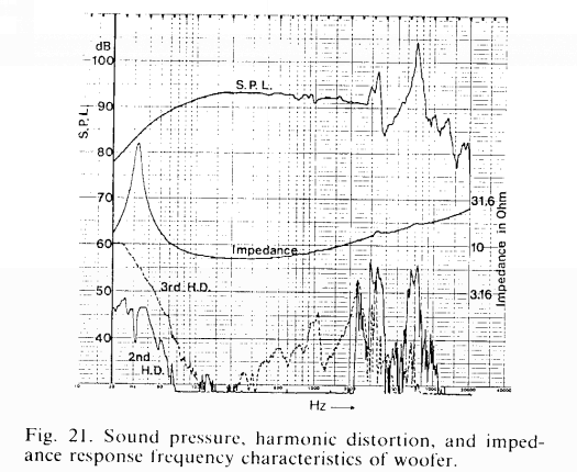

Here is a picture of the frequency response, etc, for a 10 inch woofer made in this manner. All in all, it seems to resemble the response of an aluminum cone woofer-when the response finally breaks up, it breaks up in a big way.
But the honey comb diaphragm seems to allow it to go very high before it breaks up. In this case, the 10 inch honey comb speaker goes all the way up to about 3 kHz before the first breakup-pretty good performance!
They don't list the frequency response of the four inch mid, but I would think that would be even more interesting. The cavity in a cone would affect the frequency response of a mid more than a woofer, I think, and the flat diaphragm should give a clearer source for a speaker that might go up to 3 or 4 kHz. But this is all speculation on my part.
But I would like to hear those mids.

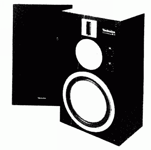

Finally, here is a picture of the Technics SB-10 loudspeaker. I believe they made other SB models as well. The surround for the 4 inch mid doesn't come out in the picture, but it is constructed just like the woofer.
