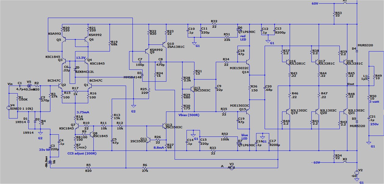

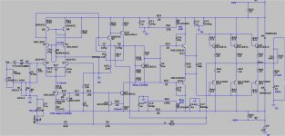

Honey Badger - oscillation and bad THD performance thanks to luxman cascode config
You won't be able to achieve lower THD at higher frequencies if you have to increase the capacitive compensation of the VAS stage. I had to compensate the Lichtstark amp with 22pf to stop the 22mhz 30v p-p oscillation. the open loop gain is essentially the same at 20hz to 20khz resulting in THD numbers of 0.005% or less. Crossover distortion is the biggest component.
