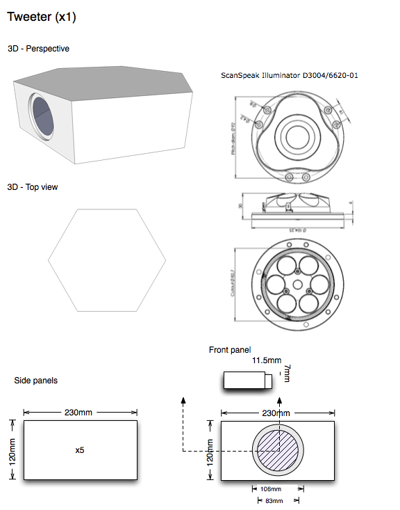

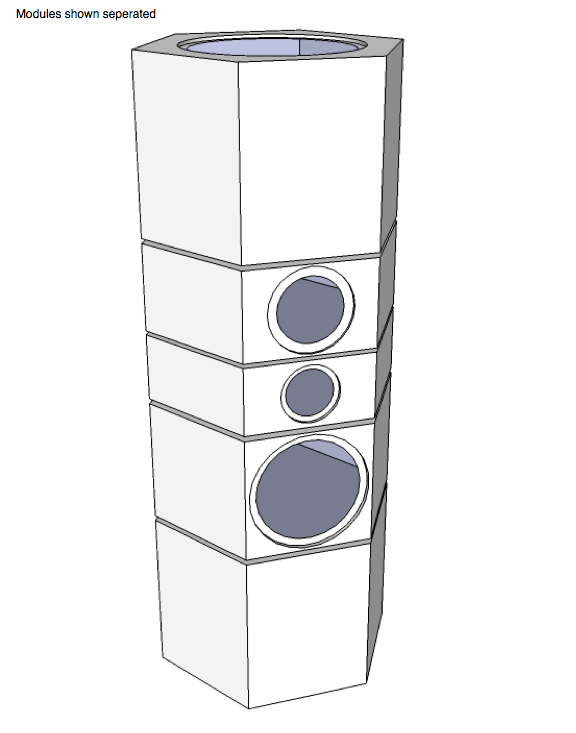

Hello,
Before I go and buy MDF and drill in it, I'd like some honest objective/subjective criticism on this design just to make sure. Might even try glass for this; while the monster passed the WAF test it didn't exactly excel in it.
It's a 4 way with in the shape of a uniform hexagonal prism (I think that's what they're called). Attached are the plans in full details. This monster will be fully active (amps are working; yay. Crossover not so much). If I remember grade school the formula for calculating a hexagonal prism is V = 3ash. Bracing is not included in the plans but if glass is used then the less the better.
In my design, 'a' and 's' are constants at a = 231, s = 230.

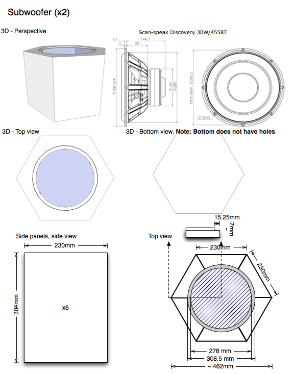

Subwoofer
Volume = 1.71115664 cubic feet
(There are 2 subs; this is more to balance the design)
Both subs are Scan-speak Discovery 30W/4558T low-pass at about 80Hz

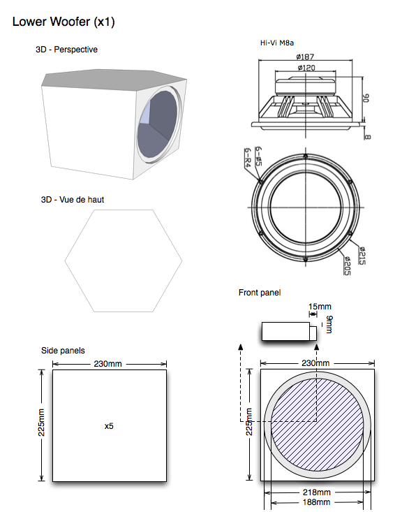

Lower Woofer
Volume = 1.26648106 cubic feet
Is a Hi-Vi M8a. I just happen to have one.
From 80Hz to ~850Hz

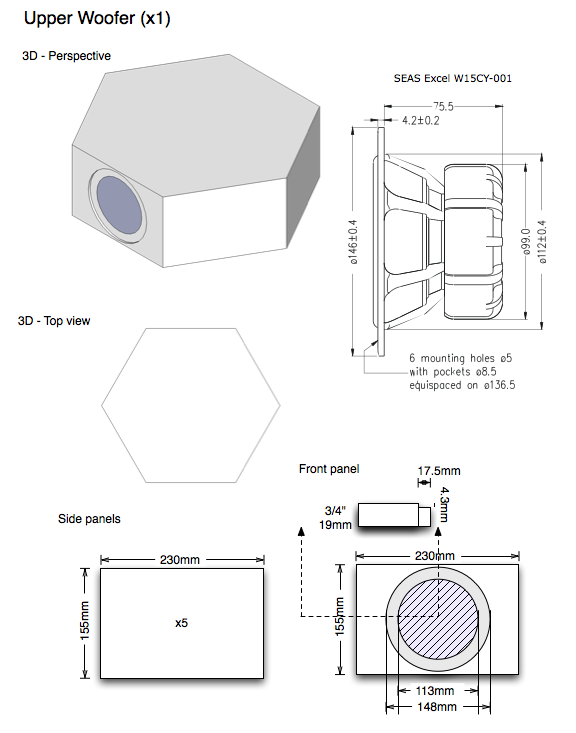

Upper Woofer
Volume = 0.872464733 cubic feet
Is a SEAS Excel W15CY-001.
850Hz to about 5kHz
Tweeter
Volume = 0.675456567 cubic feet
5kHz to infinity, and beyond !
Many thanks in advance. Construction is not expected to start very soon as the budget is a bit tight for hobbies this time of year. If this does not turn out nice at least I'll learn from it.

I see some problems here indeed. The internal shape of your boxes is almost circular - its close to the worst possible shape when regarding internal standing waves. Should be avoided! Only a sphere would be worse than this.
Also as others have noted, 5 kHz is way too high for the 5" Excel magnesium. I suggest crossing it over well below 2 kHz for optimum results, or choose a (paper) midrange better suited for a high XO point.
And then - why a 5" and then an 8"? Why not simplify a bit, and run two 5" instead? Two 5" has the same cone area and output capacity as one 8". Running the midwoofers down to 80 Hz also seems a bit too low, I suggest 150-200 Hz.
Even with XO at 150-200 Hz, a passive XO network is going to be difficult to design, so either way an active XO is recommended.
