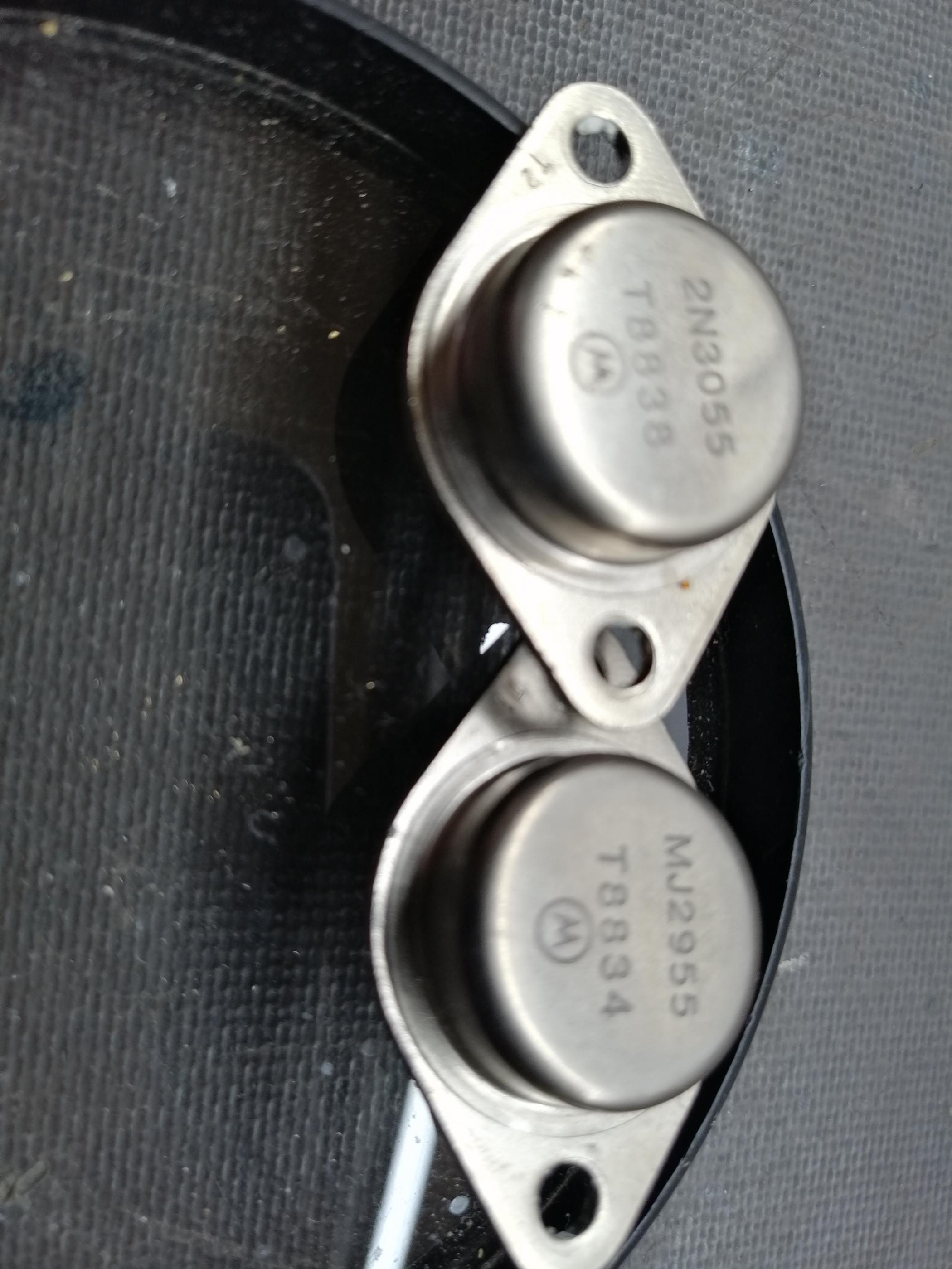

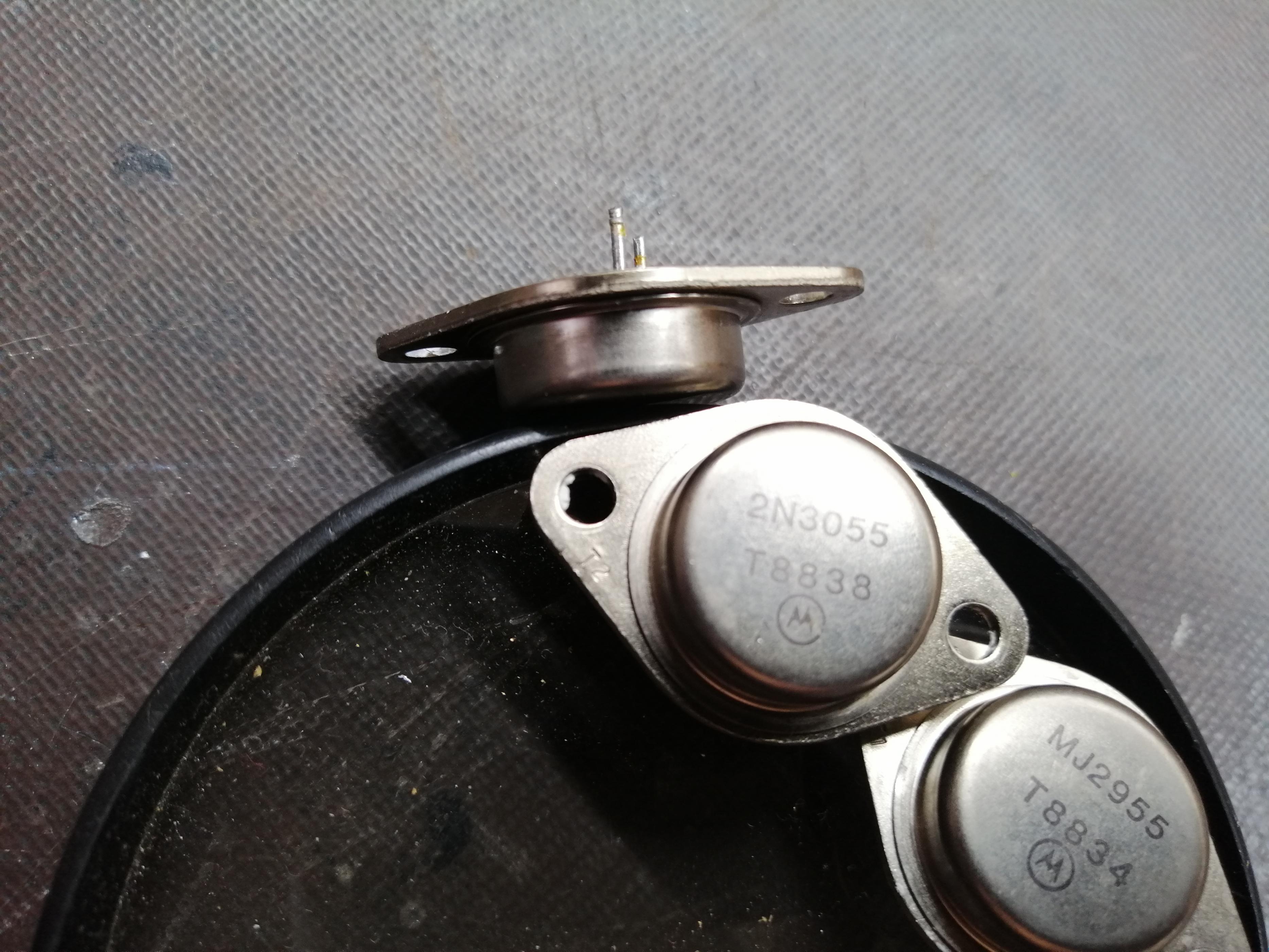

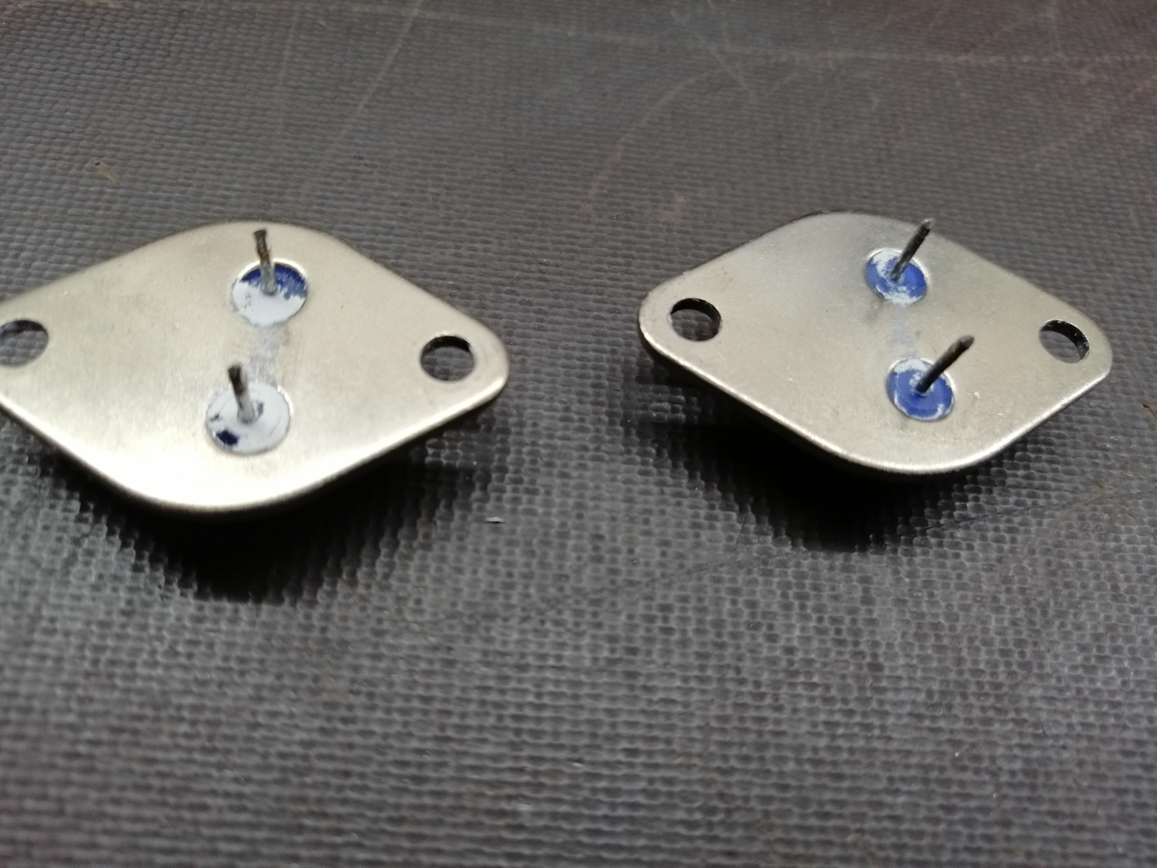

I need 2 pairs of hometaxial 2n3055/ mj2955 transistors to fix a Nad 3020 series 20 amp.
I gave got these and if they are the correct one's then I would not have to add base and emitter resistors as when I use modern transistors. The thing is that I do not know if these are🙂 the correct trannies, I know that they are old , they come from a ring generator that was used in manual board exchanges. Any help appreciated.

I wouldn’t be too sure. There never was any such thing as a hometaxial 2955. The single diffused processes were NPN only. I think by 1988 all Motorola made was either epi-base and it’s variants, and triple diffused for switching. Even RCA may have dropped them by then. Latest RCA’s I had were 1984. With near identical date codes, and not labeled 2N3055A (or H) I would suspect you’ve got epi NPNs. The PNPs always would have been, regardless of who made them. As long as ONE in the pair had the right internal thermal feedback it tended to stay stable.
They look genuine Motorola devices (I say "look" guardedly. Some fakes can be quite hard to spot).
Motorola never made a hometaxial device AFAIK. They had processes giving good SOA with epi base. The NPN's, are I am sure, epi devices. And they are a better complement to the MJ2955 which is epi too.
I don't have the NAD3020 circuit to hand, but I suspect it will have emitter resistors. It is not a good idea to omit emitter resistors because of thermal run-away.
You may not need base resistors, but if they are in the original I would leave them there too.

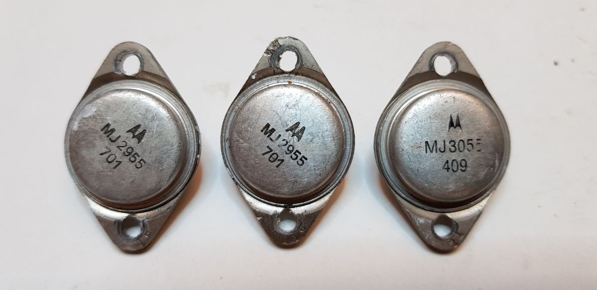

In my stashes I found these:
These for sure are Motorola originals. I know that 'cause I bought them for an amplifier pjoject as a pupil in the 1970ies, when those we know as fakers today were still securely locked behind the iron curtain.
Look at the differences between them and those shown in post #1: My originals have aluminium caps and reinforced mounting flanges at the holes, same with other old Motorola pulls (MJ802, MJ3001...)
Unless Motorola has changed their TO-3 case design, I dare to claim that the pics in post #1 show counterfeits.
Yes, I have several of those old aluminium TO-3 Motorola devices. They changed their cases before ON Semi split off, but whether back to 88 I'm not sure. I've certainly got Motorola steel MJ15003/4 from 1996.
But the date coding might be wrong in post #1: Moto put the assembly plant location on the case too.
From 84 to 88, Motorola used a steel case with a shallow domed top hat similar to the aluminum. In 89 (maybe late 88) they switched to the flat-topped one in use by ON today. My 8804 2N6030’s have the domes. My 8912 2N6308’s are flat top. During the time they used the domed top hat, they switched the glass to metal seals for the pins from small to large diameter. My earliest 84’s (2N6609) have the small diameter seals like the aluminum cases have. Everything I have that predates those are aluminum.
