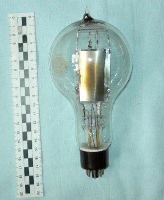

I was here more than one year ago🙂
Now I make better tubes. For example, it's power triode:
The parameters:
diameter 90 mm
height 18 cm
tungsten cathode
filament voltage ca Vf=11V
filament supply If=1,85A
life time (to break cathode) ca 7200h
gain factor K=ca.5
transconductance S=0,8 mA/V
power dissipation P=12W
Characteristics during If=1,8A:

topkick time
NICE .
i found it through google while doing research .
that is a VERY nicely made tube .
a shame nobody had intrest in this at the time .
i would like to know how you made this one .
EDIT forgive my topkick i just was so excited not to find a threat about snake oil and WE300B's but some proper discussion .
NICE .

If I made one of these the vacuum would leak like bucket full of holes..LOL
One of the 7 wonders of the world how to get wire through glass with a perfect seal.
Regards
M. Gregg
Dumet wire.
It's a special alloy designed for feeding through glass.
Thermal coefficeint closley matches that of the glass used for the tube/lamp, whatever.
copper adhers to glass well so the outer layer is copper.

the wire your talking about is dumet wire .
for the construction of vacuum tubes you need a lot of materials .
i'd love to go in dept about it .
and the seals aint so hard . you just need
* dumet wire for the seal itself
* NI48 FE52 wire for the support rods .
weld em to make a seal
glass . tungsten . nickel sheet/strip metal . a bounch of rare earth metals . forgot ofcourse mica ,
the machines are a completely differend story tho.
my guess is it would cost 50k+ to make the equiptment for 1 type of tube . and that also depends if you outsource or homebrew equiptment
most difficult part would be a decent grid winder / and or a stem maker .
semi automatic bulb maker would save you SO much production time

I told that I prepared better tubes. I found it in my webpage:
lampa T10 PWL
Unfortunatelly, there is not english version now.
About film: I'm looking for it in my computer. But remember that it's "big" file.
But now You can see some my aparature:
http://tubedevices.com/alek/pwl/aparatura/aparatura.htm
I have 5 vacuum units:
-with rotary pump and oil diffusion pump. The final vacuum is below 10E-6 Tr. It's for pumping my
vacuum tubes.
-with rotary pump and turbomolecular pump. The final vacuum is ca. 10E-6 Tr. In this unit is quadrupole mass spectrometer for testing residual gases in electron tubes etc. It's used rather for my experiments for new types of cathodes.
-with rotary pump and my own glass oil diffusion pump. I have it for fill neon or argon, hydrogen (etc.) tubes (nixies etc.). The ultimate pressure below 10E-4 Torr.
-with rotary pump for fill geiger counter tubes. The ultimate pressure ca. 10E-2 Torr.
-with rotary pump and oil diffusion pump. It's vacuum furnace for degassing details of tubes. The ultimate pressure below 2x10E-5 Torr.
About wires: for vacuum tight connectors metal-glass you need different wires. For example, for soda glass or lead glass you need wires FeNi or FeNiCo with copper shield. Im my country some people call it "FeNiKuMa", but I don't know why.
For molybdenum glass or kovar glass you need molybdenum wires.
For duran glass it should be tungsten wire.
