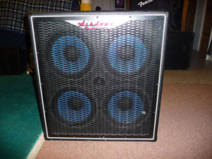

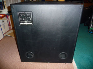

I have looked also at this design, the Ashdown 4x10 Bass Cab (600 watt).
Please notice both the bullet tweeter in the middle of the cab,
and also the PORTS on the back!
It looks like those ports could be estimated,
and might be acceptable for these smaller 10" speakers.
Do you think porting is a good idea in this case,
if I go with the smaller 10" speakers?
Secondly, how deep do you think those ports are?
Finally, why did they port their cab, if a closed cab would be better overall?
Is this just a cheap effect to make the cabinet sound louder?

That Ashdown 4x10 uses drivers with very specific engineering characteristics. Drivers of the same size can differ substantially in these characteristics and therefore require different enclosure design specifics; sealed or ported, cab volume, tuning frequency if ported, among others. Copying the Ashdown cabs (same cab and port dimensions), but using different 10 inch drivers will result in sound that differs from the original, quite possibly resulting in poor sound quality. The eminence 10 inch drivers I suggested work best in sealed cabinets. The major issue with ported 4x10 cabs is the need to load the drivers down to the lowest frequency they will used for: in this case, low B. Many ported cabs are tuned higher.
Your requirement to reproduce the fundamental for notes on the B string will met by very few drivers (regardless of their nominal diameter), especially in a pre-existing cabinet.
If you return to that shop ask for the model number of the 10 inch drivers he offered you.

Like I said most ported musical speaker boxes are for power handling,
not extension, and should be tuned to or slightly above the lowest note.
With twin ports tuned to low E, you can block one to tune for low B.
rgds, sreten.
rgds, sreten.
