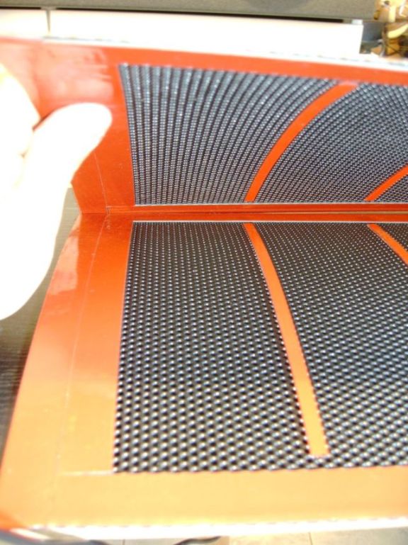

I´d opt for a hybrid design where the ESL-panel is supported by an dynamic bass (8-12inches) up till 150-250Hz.
The reason therefore is, that You can use a panel with app. 1mm d/s-spacing which will give You high efficiency and eases the need for pricey high quality trannies. You can get away with a pair of cheap series connected 9V/230V (lucky Germany 😀 ) standard toroids to give You an really good working trannie which steps up by a factor of 1:50.
Use perforated metal sheets of 1mm thickness and 3-5mm holes. For insulation paint (spray) the stators with an PU-laquer several times until the paint-thickness reaches 0.3-0.5mm. As spacers You may use the excellent double sticky foam tapes from 3M, or You cut thin PVC or Lexan-stripes and glue it with double sided carpet-tape or special glue.
To contact the diaphragm You can cut Aluminium foil for household purposes into narrow strips.
For diaphragm coating I prefer liquids that can be painted or sprayed onto the film. Imo You get a more consistent and even coating and You don´t stress the film by heavy rubbing action (as with grafite). I use a clear waterbased compound mainly consisting of a childfriendly hobby glue (very cheap, flexible and easy to use).
The HV-supply can be easily and cheaply built from a cascade.
When installing the membrane use high mechanical tension. This will give You a high resonance frequency.
The benefits are:
- high efficiency
- high SPLmax
- You can use the fs together with an simple passive high pass filter (just one C!) to give You the desired frequency response (no heavy equalization of the Fs will be needed).
jauu
Calvin
comparison
this is a comparison between my DIY-Panel (very similar to ML-Sequel) and an ML Prodigy-Panel.
Both were driven by an Amplimo 1:75 Trannie without and with filtering. Measurememts were taken in the nearfiled of the panels with 2.83V. SPL is recalculated to 1m distance.
As can be seen, the Prodigy panel uses a 12µm membrane that can be stretched harder than my 3.5µm film, giving the Prodigy a higher fs around 250Hz versus 160Hz. The thinner film on my Panel allows for an extended response at the upper end of the frequency range. Both panels can be trimmed with an damped 12dB filter to a very linear falling response -no need for fs equalization! Efficiency of both panels is quite high and can be adjusted by the Trannies factor to lower or even higher levels. I got nearly identical frequency responses (apart from efficiency) by using simple toroids 230/9V.

PU means PolyUrethane. Availabilty of those laquers is good, even though I prefer to purchase the stuff from a prof-store and not the DIY-market. PolyUrethane hasthe desirable features of relatively low surface- and volume-resistivity paired with an acceptable high dielectric constant. If You can get a Nylon-based coating (think Rohm&Haas offers such stuff) opt for this.
I won´t offer the recipe of my diaphragm coating in public, but there are a lot of recipes and liquids around that work well.
A lot of acrylic and epoxy glues work well. The electrostatic circuit is a worthy knowledge pool.
You´re right. I left out the resistor in series to the polarizing voltage. It is in Fact a constant charge design with a high valued resistive coating ion the diaphragm.
