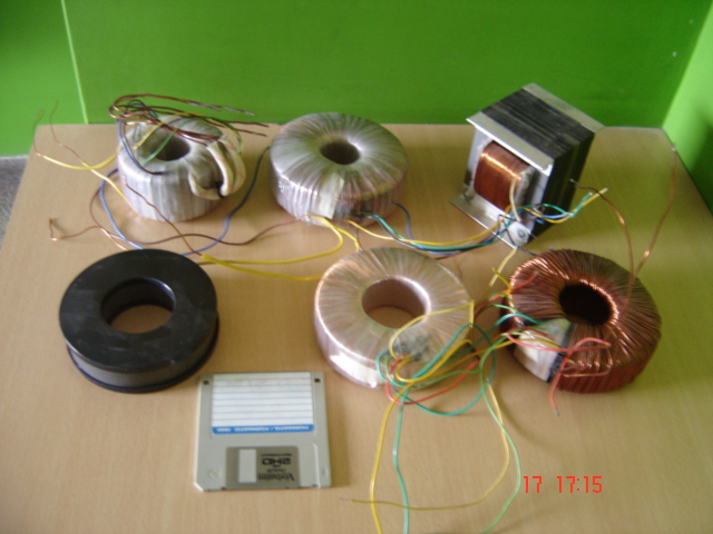

This is an old thread I made, but actually I want to add a photo of the transformers in question, although they aren't finished.
From left to right and from up to down: a heater toroidal transformer, with a secondary for the EL34 output stage, an isolated 6.3V for the driver tubes whose heater is at higher potential than ground, and other for grounded driver tubes; the +B transformer with the 3DG4 heater, the 12Hy 300 mA self designed and constructed, and 3 stages of the output toroidal UL transformers, but they are high frequency failed, so I´ll try another way of winding them.
Diskette is for size comparation only.
No, the cores are rescued from commercial lightning, 320W for dichroic lamps.
Surprisingly they are designed for 17KGauss!

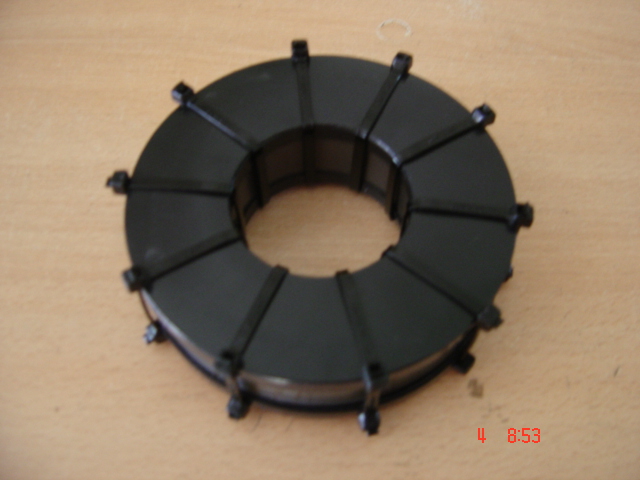

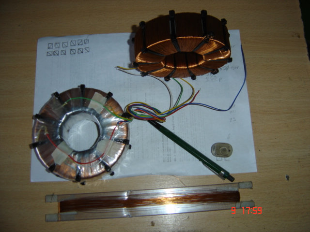

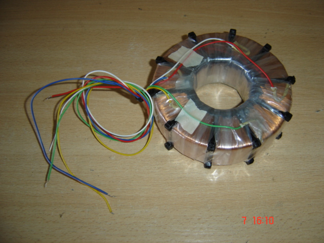

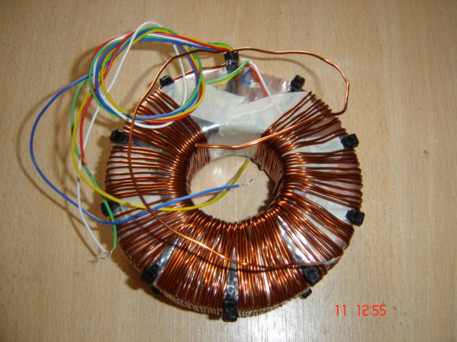

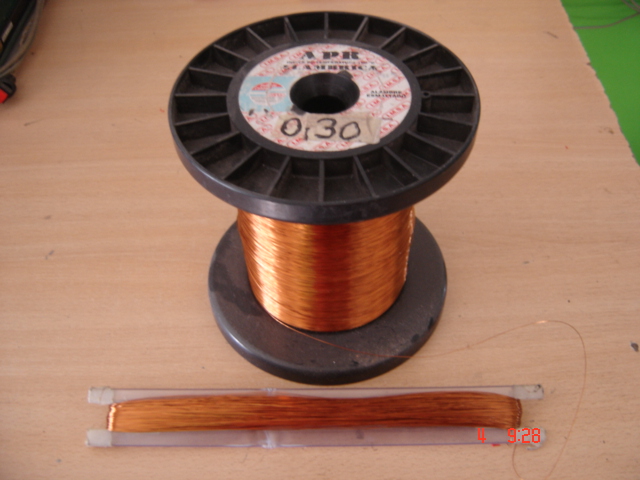

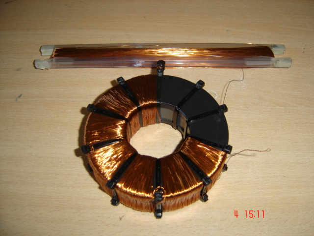

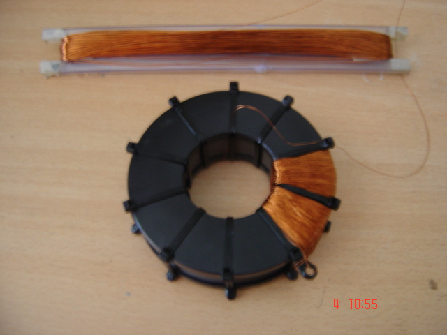

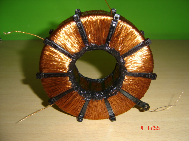

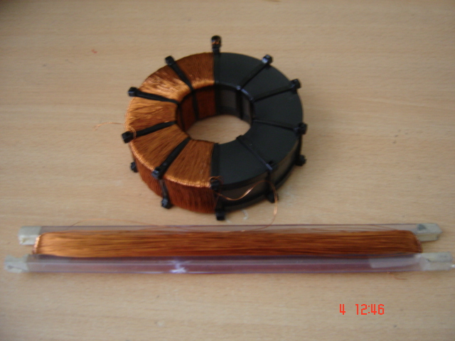

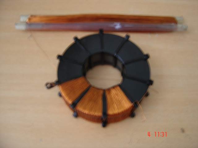

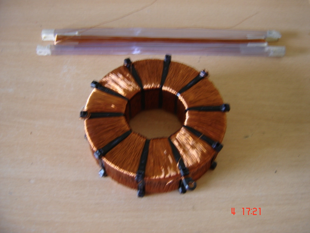

Transformers rework I.
I had reworked my output toroidal transformers this last 2 weeks, during vacations. It appears that my idea of section the core and winding there the primary has given good results. At least, the resonant frequency has moved from the original 8KH to almost 26KHz as I could measure in preliminary tests.
I had taken some photos of my job, and they are here.

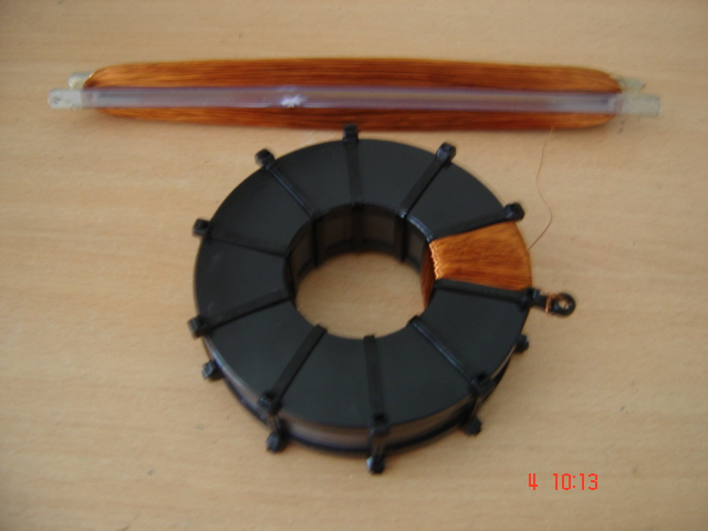

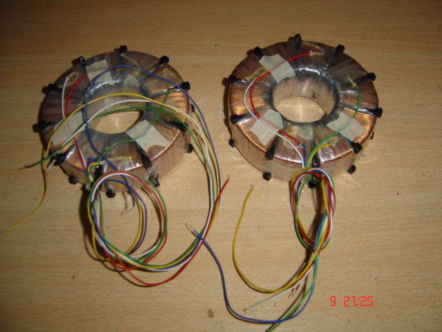

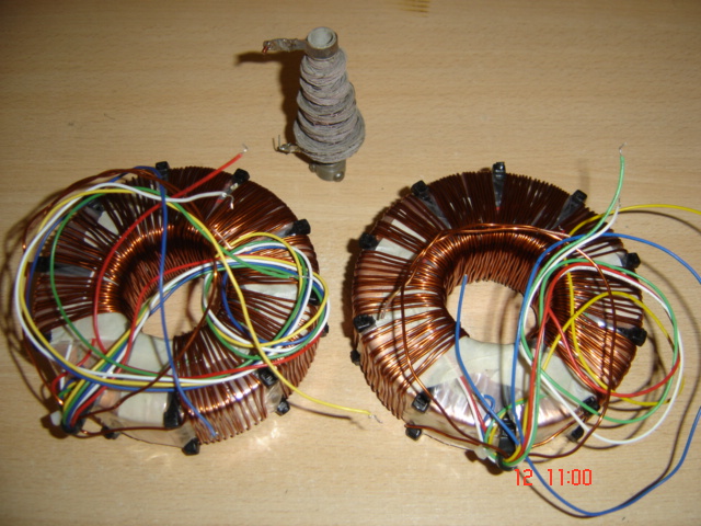

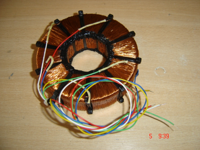

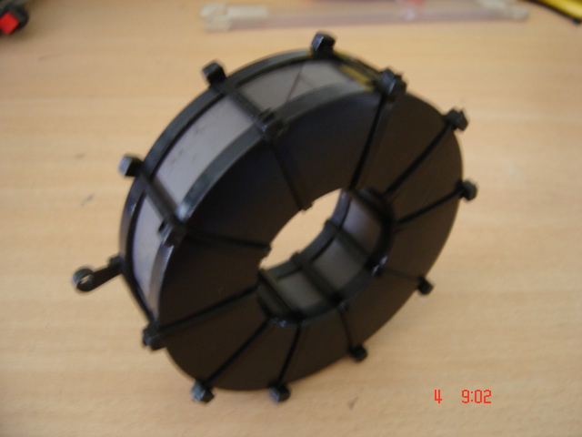

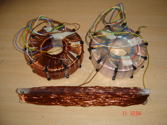

Transformers rework II.
I expressly want to say that the section the core is an own idea based on the old power RF choke in the photos, and that I didn't disassemble nor reverse engineered none commercial or standard transformer If the idea was already used is merely coincidence.
Your idea is brilliant, regardless if someone did before. 🙂
BTW. Very nice transformers, a lot of work. 😉
Yes, about 3 days working about 8-9 hours a day: 1 day per primary winding (3000 turns plus screen and +B taps without cutting the wire, and counting turn by turn mentally, and help only by the "digital counter" in the photo of the pen an the paper sheet), and 1 plus day to wind both secondaries, 110 turns of 1.2mm diameter copper wire. Finally, a tenths of minutes to solder output cables, put the isolating tape between primary and secondary, etc. But I did it by pleasure only. Work it good or bad, the try were interesting.
Thank you Popilin by the suggestions given in the telephone dialog.
Nothing to thank, for that are friends, right? 😉
Thank you.In fer day's when the thermometer goes down, I'll try them.Nice work.
Shoog
