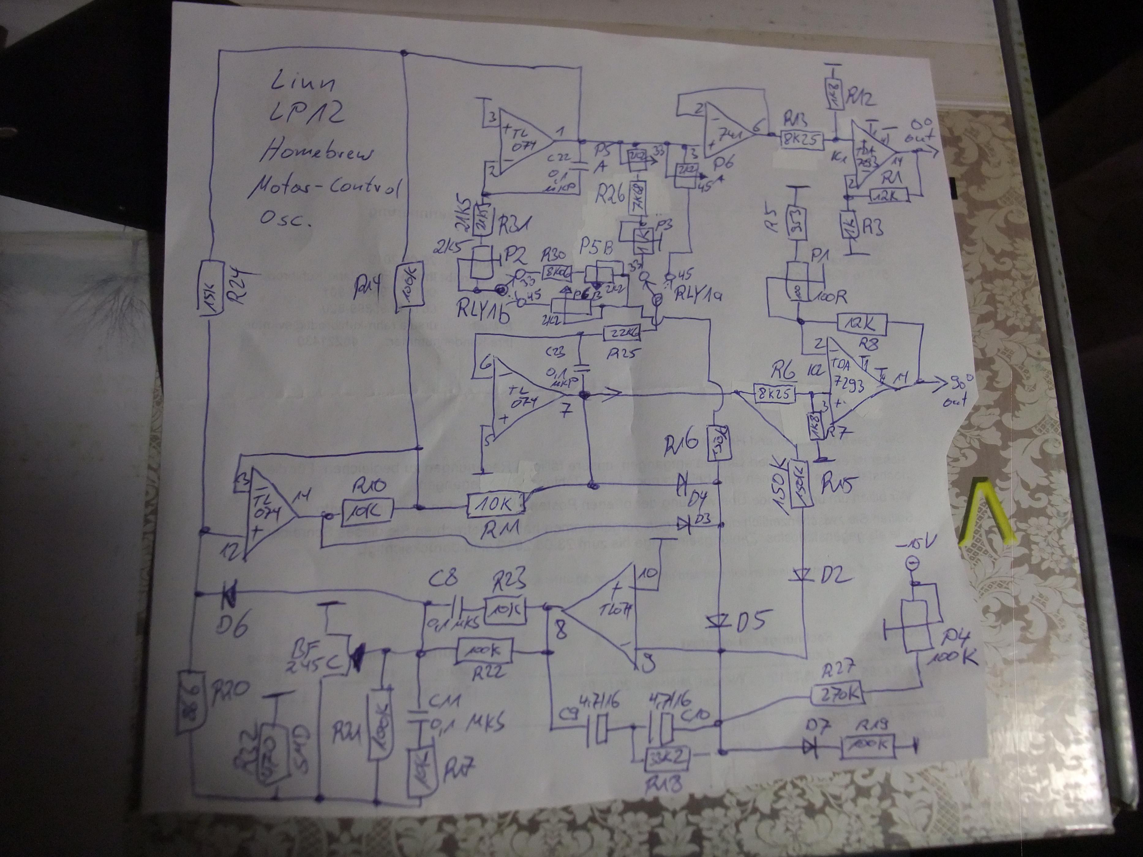

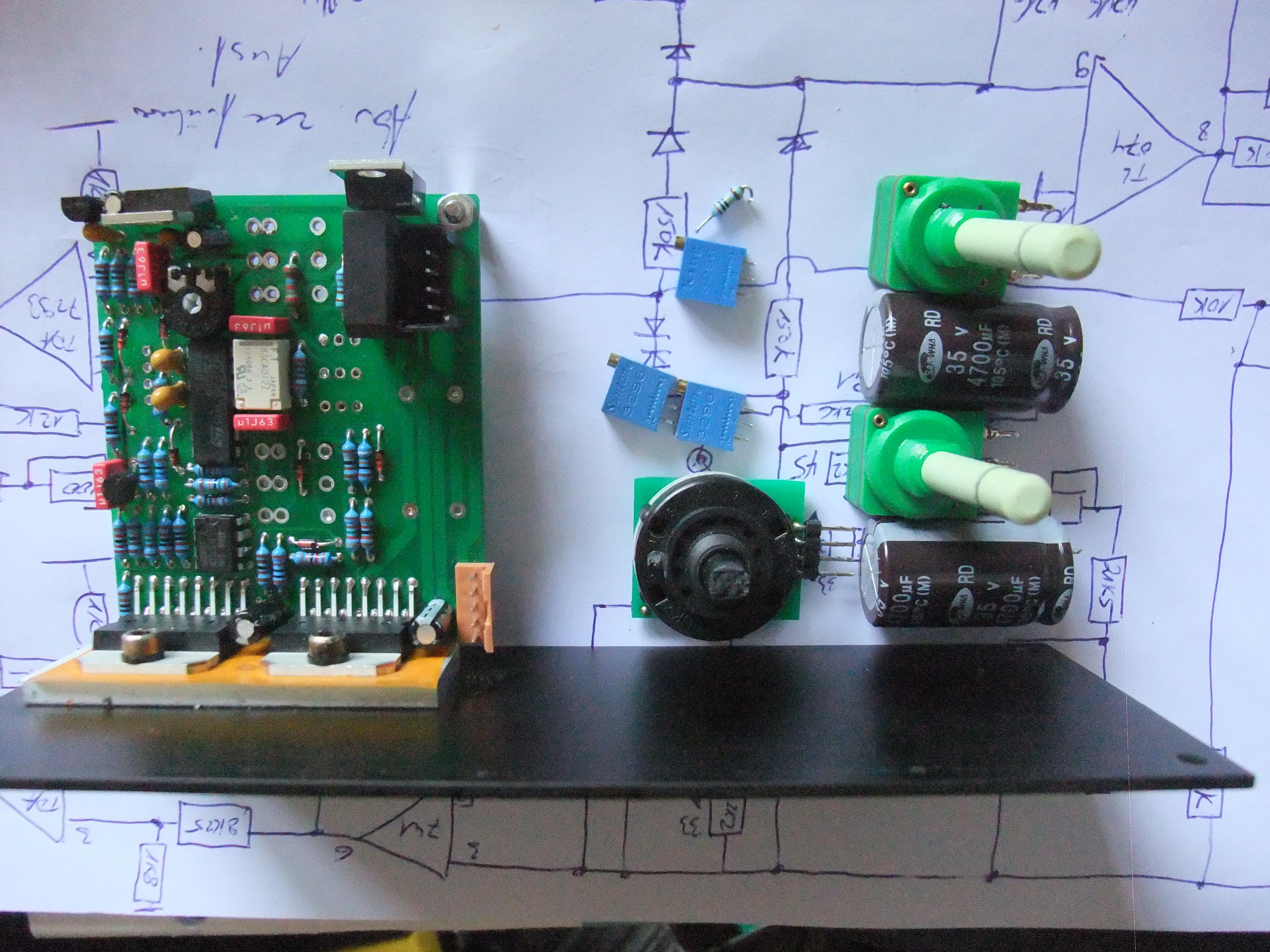

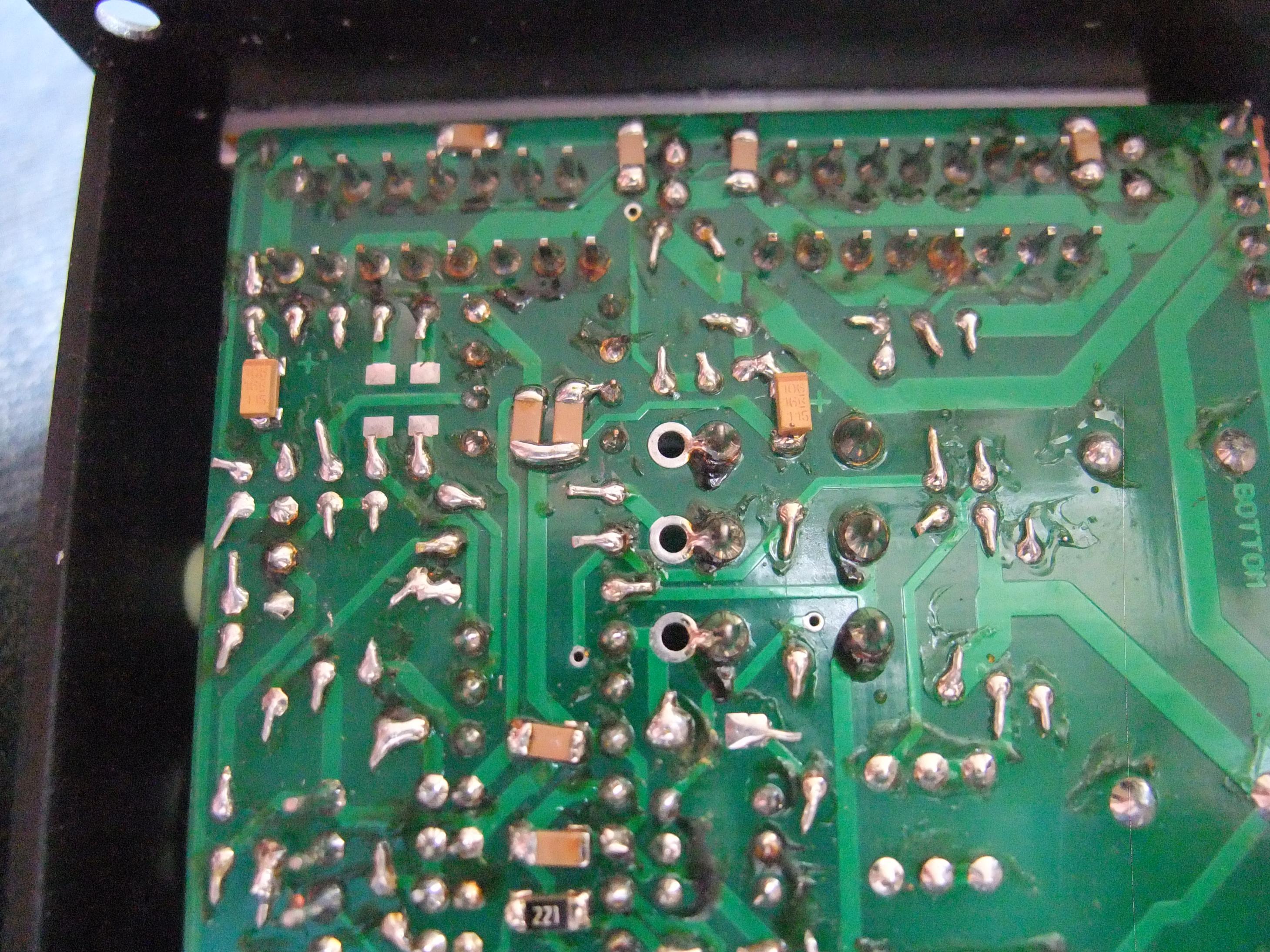

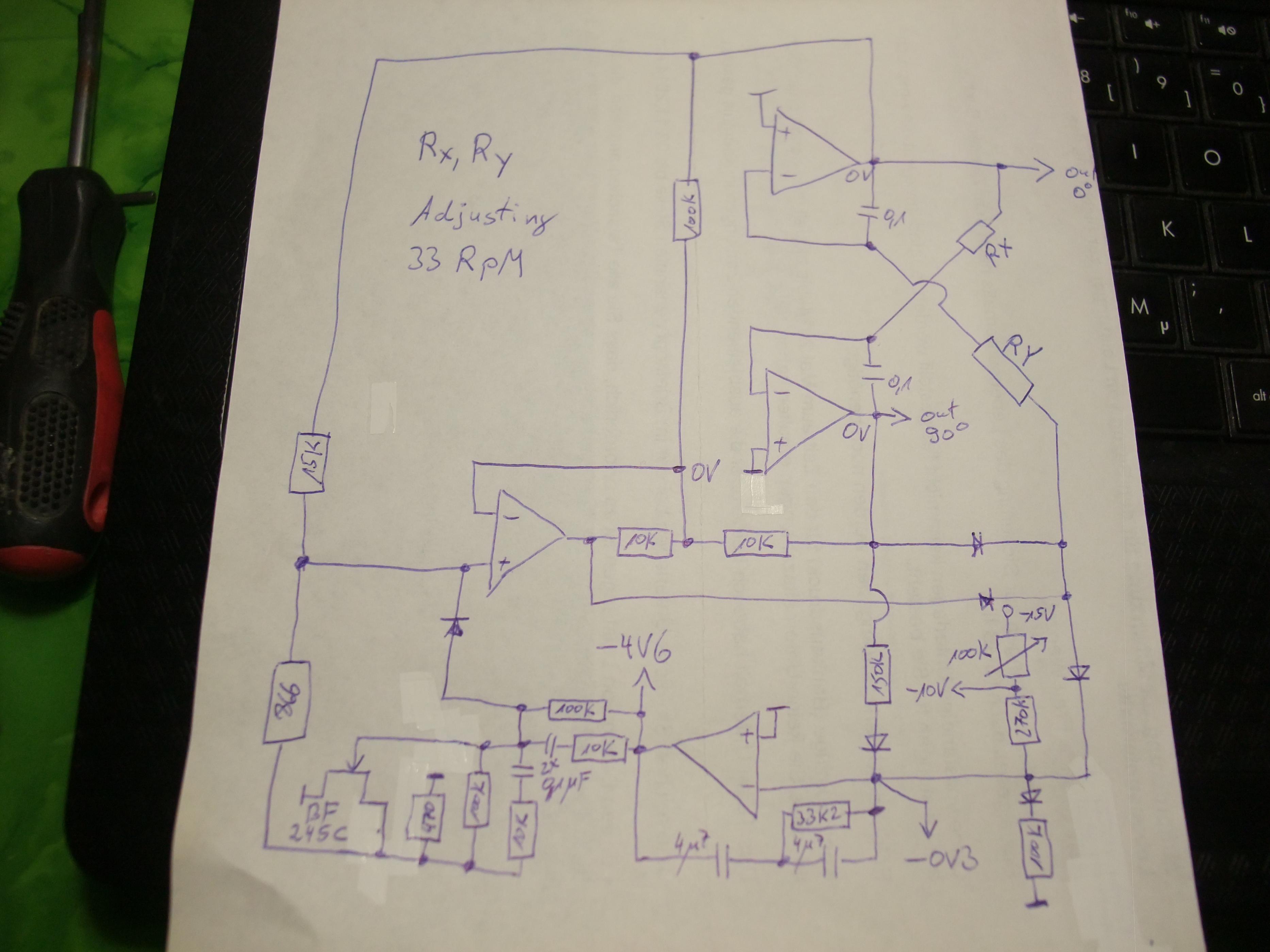

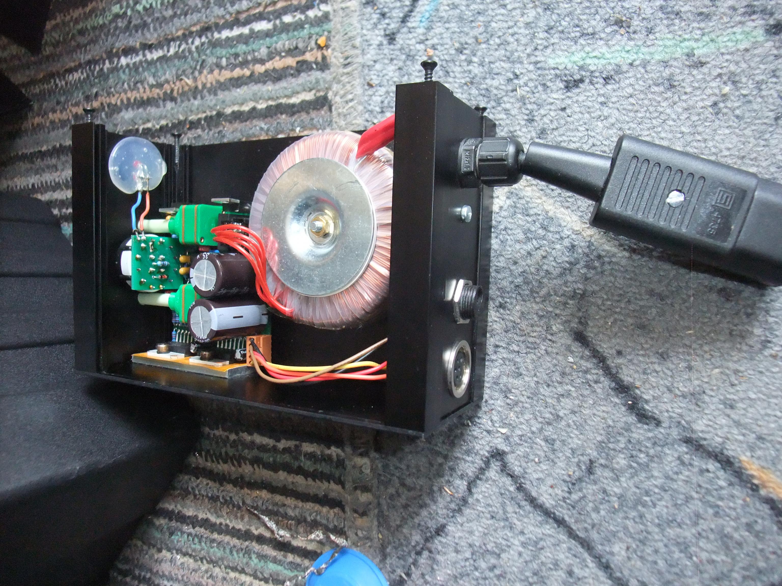

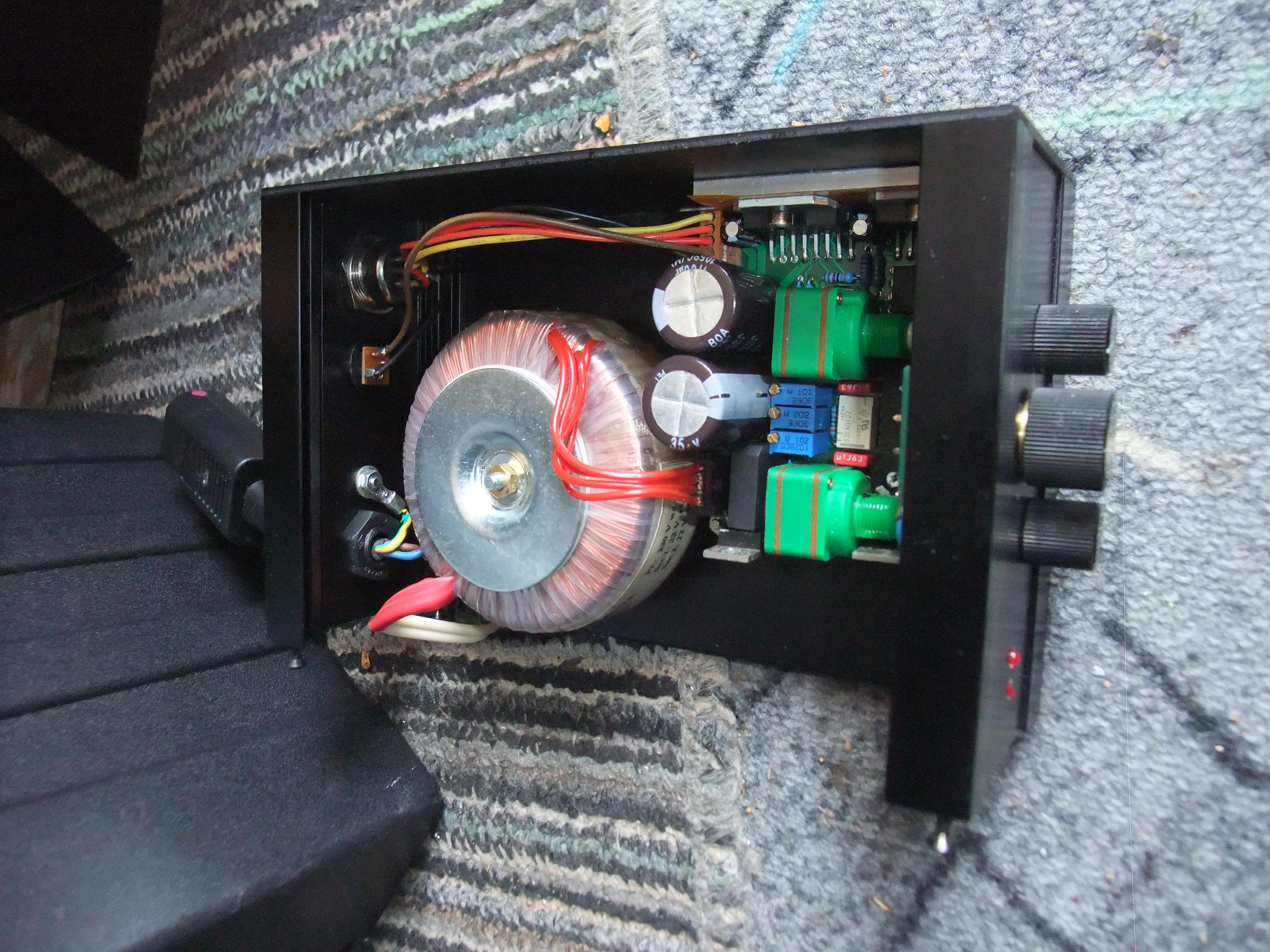

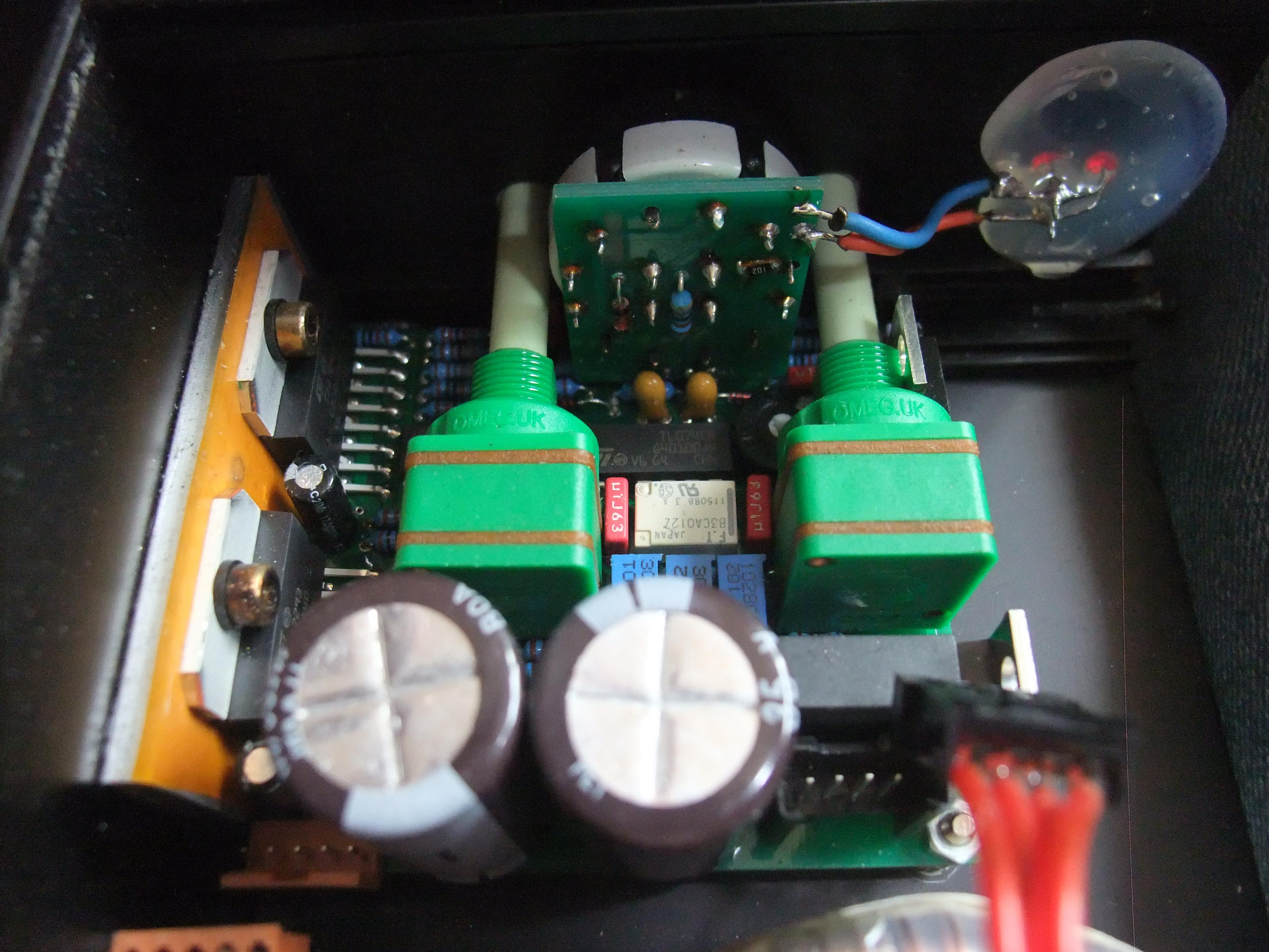

From a friend I got for repair a diy motor control for Linn's LP-12.
Compared to the X-tal versions with divider from Linn model "Valhalla" and "Lingo" is here a sine wave generator in use - similar to Linn's AXIS motor control - go to
http://www.turntablepsu.com/images/Axis Schematic.pdf

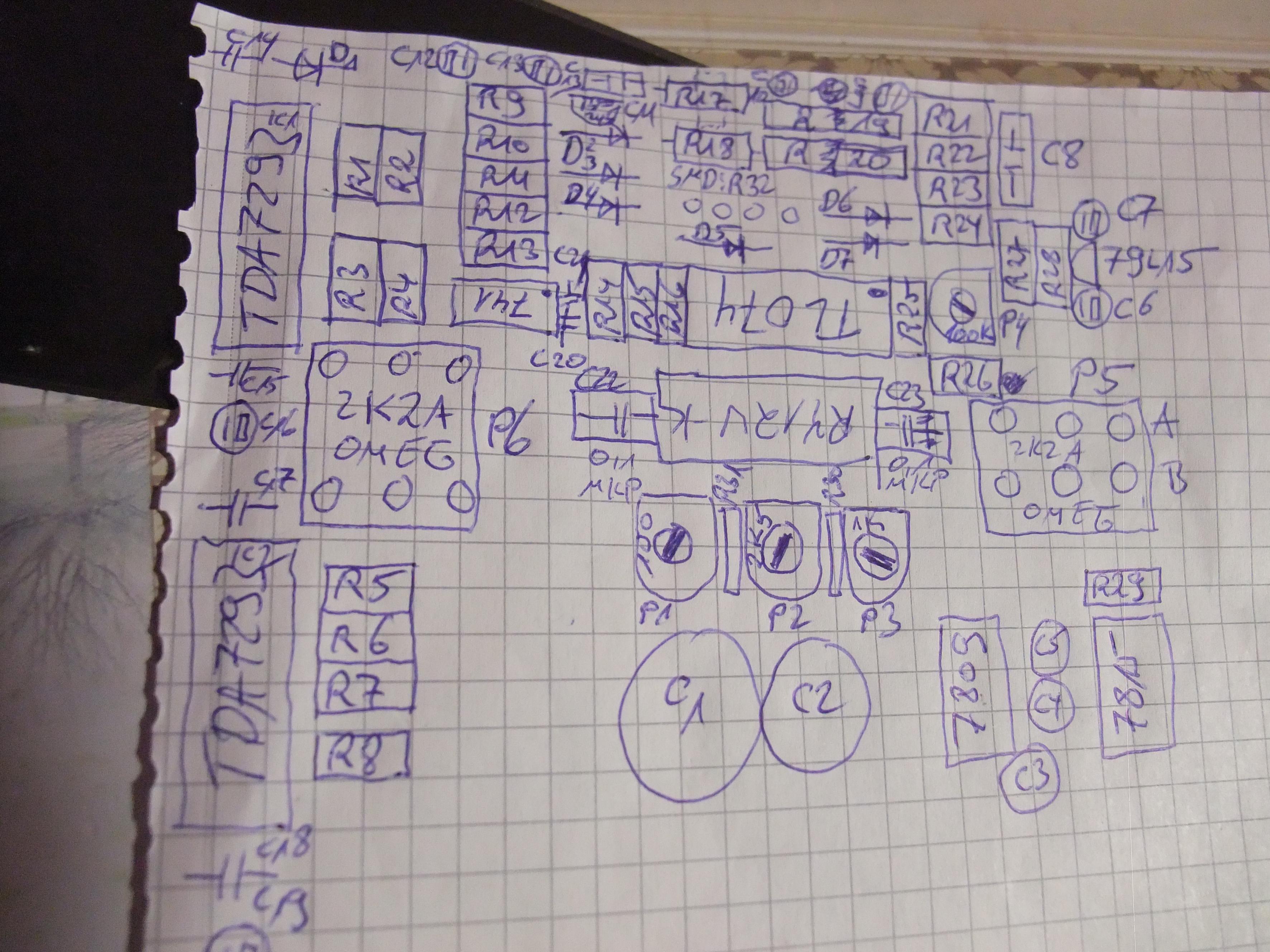

In the attachment you will find the schematics, which I have drawn out.
Who can give a description, how the circuit of the sine wave generator works or can give an advice, whether this circuit was based on an existing commercial product.
Thank you very much therefore.

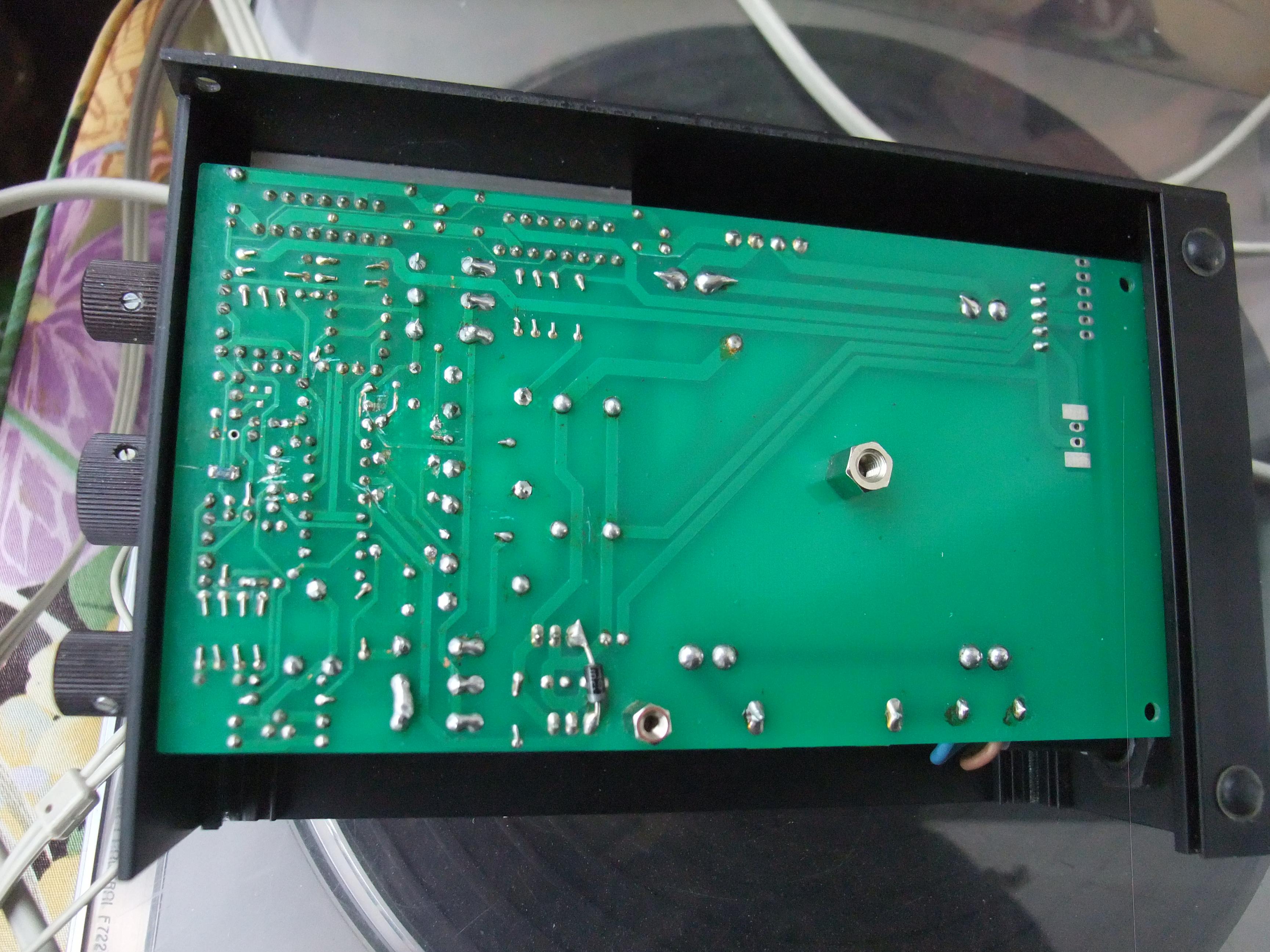

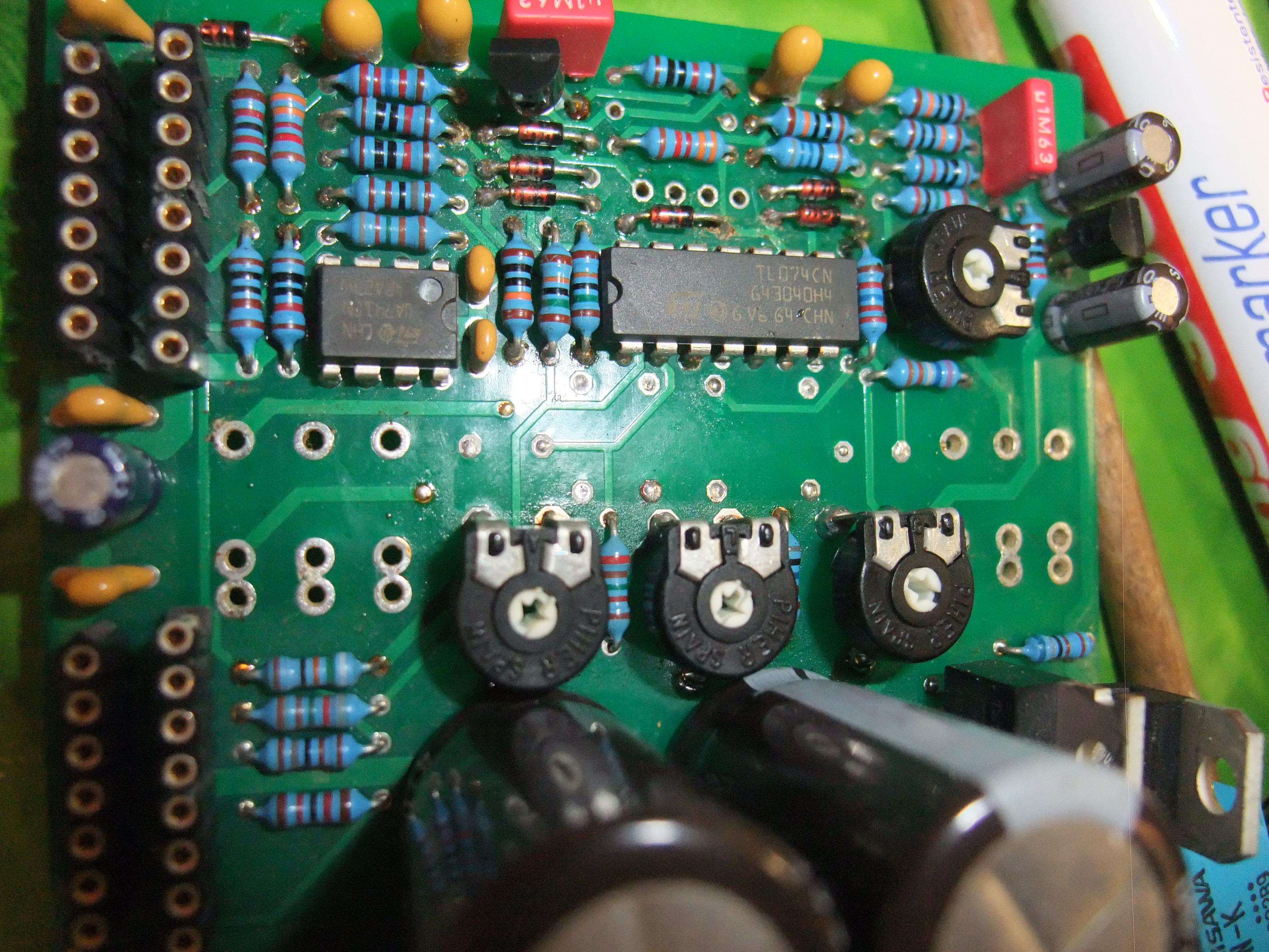

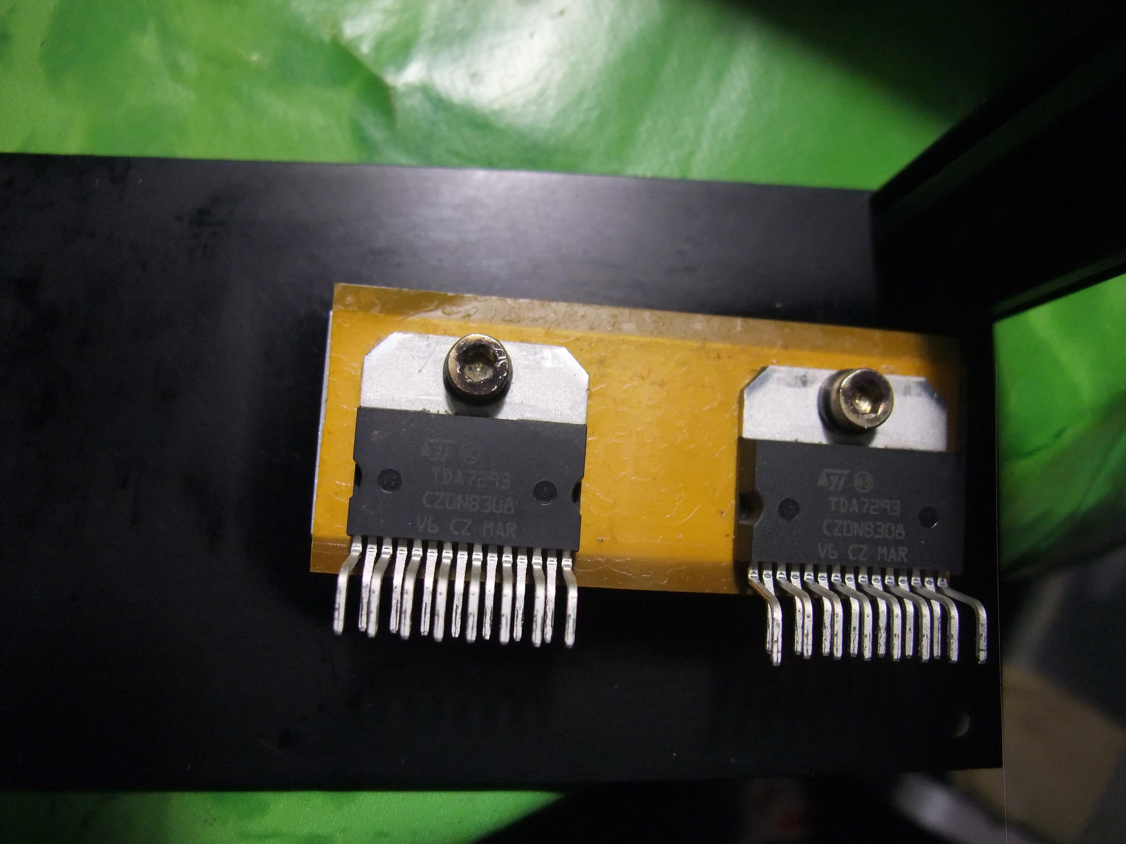

P.S.: The reason for not correct working condition you will find in the fifth image.
Go to post #16 for news and new schematic, which I have drawn out.

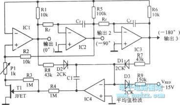

It's hard to tell from your hand drawn schematic, but the original Axis controller was essentially a state variable filter with 2 back to back integrators and feedback to produce oscillations and a 0° and 90° output. In order to be stable and limit the output to a sinewave, the feedback network is either fixed (cheap and cheerful way of doing it) or uses an AGC circuit (better control of Q and output level). The RC time constant formed by the feedback cap in the integrator and the input resistor determine the frequency.
A good description of the circuit can be found Here; page 4 of the PDF breaks down the description of a state variable filter used as an oscillator.
Thank you for your information.

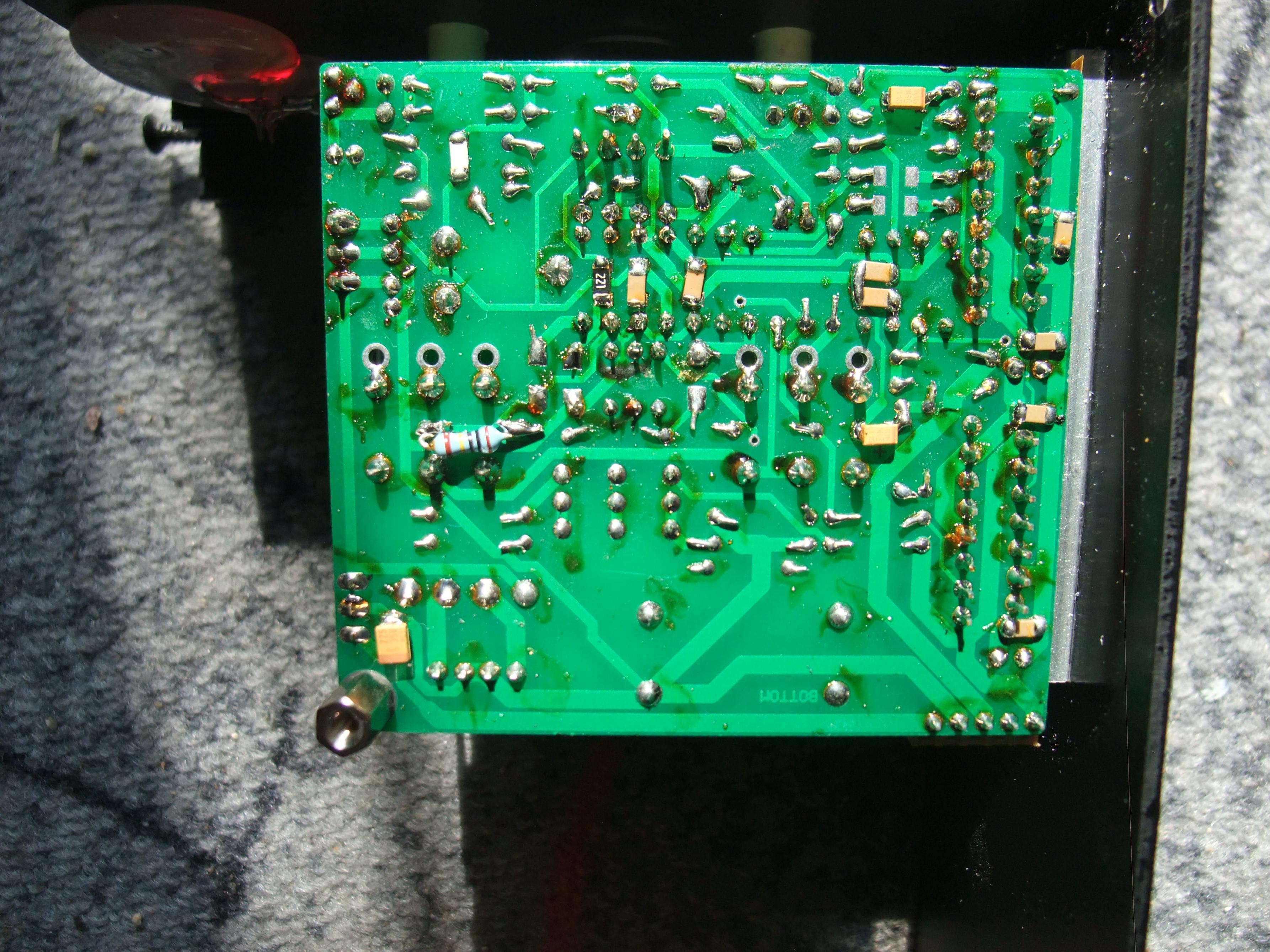

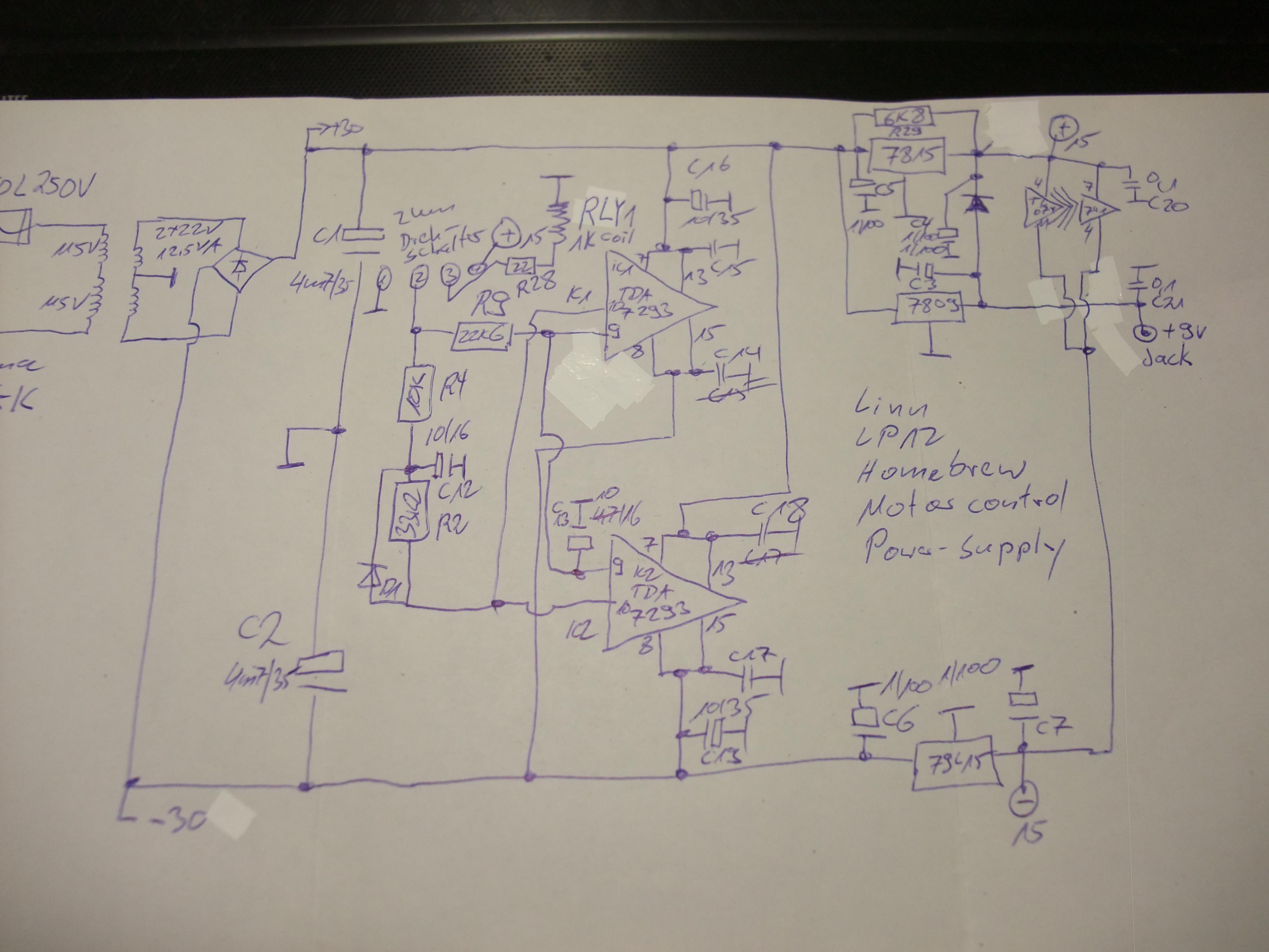

In the attachment you will find a simplified schematic (oscillator only without output gain stages so as without variable resistor networks for two speeds and without power supply.

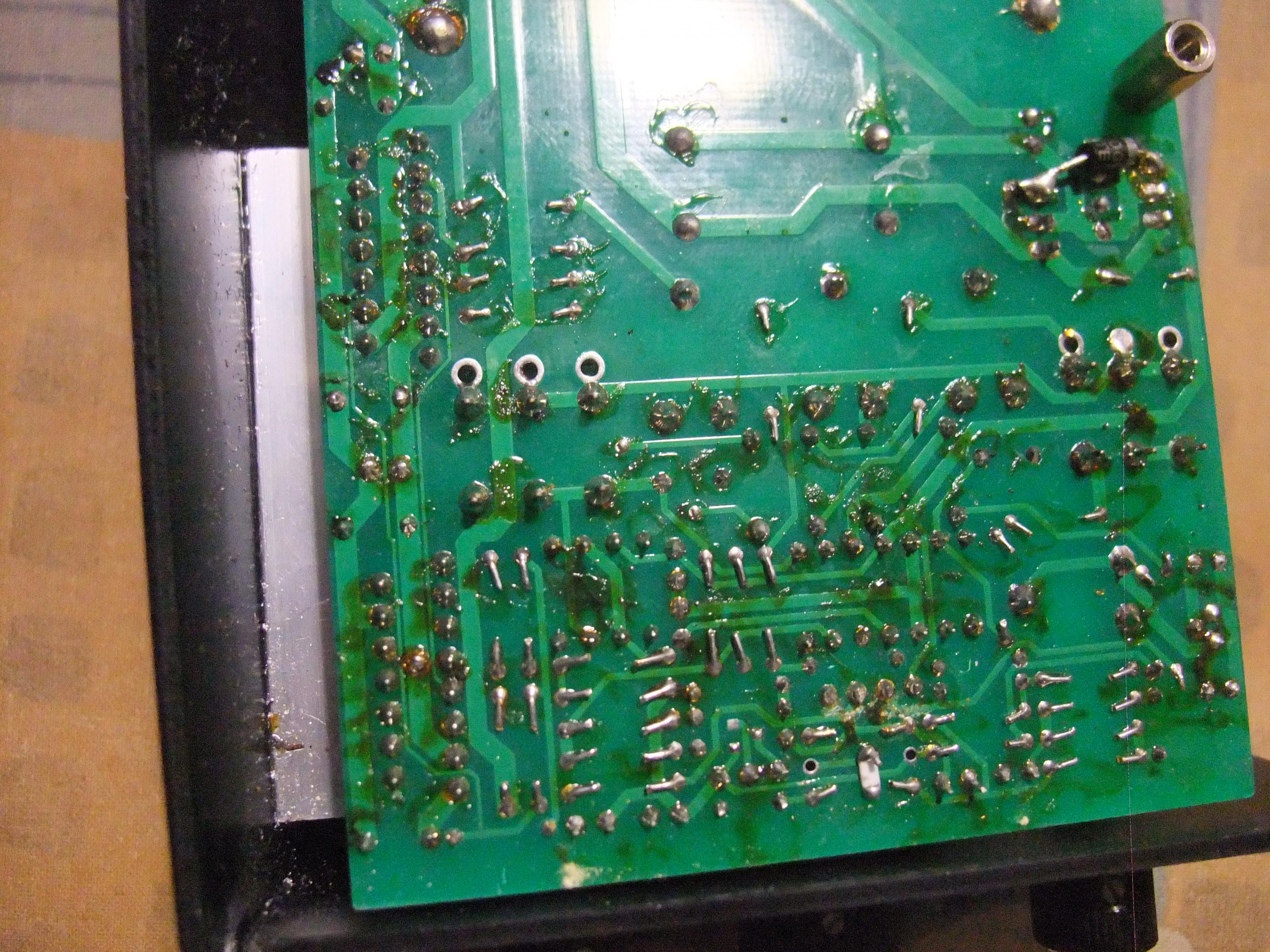

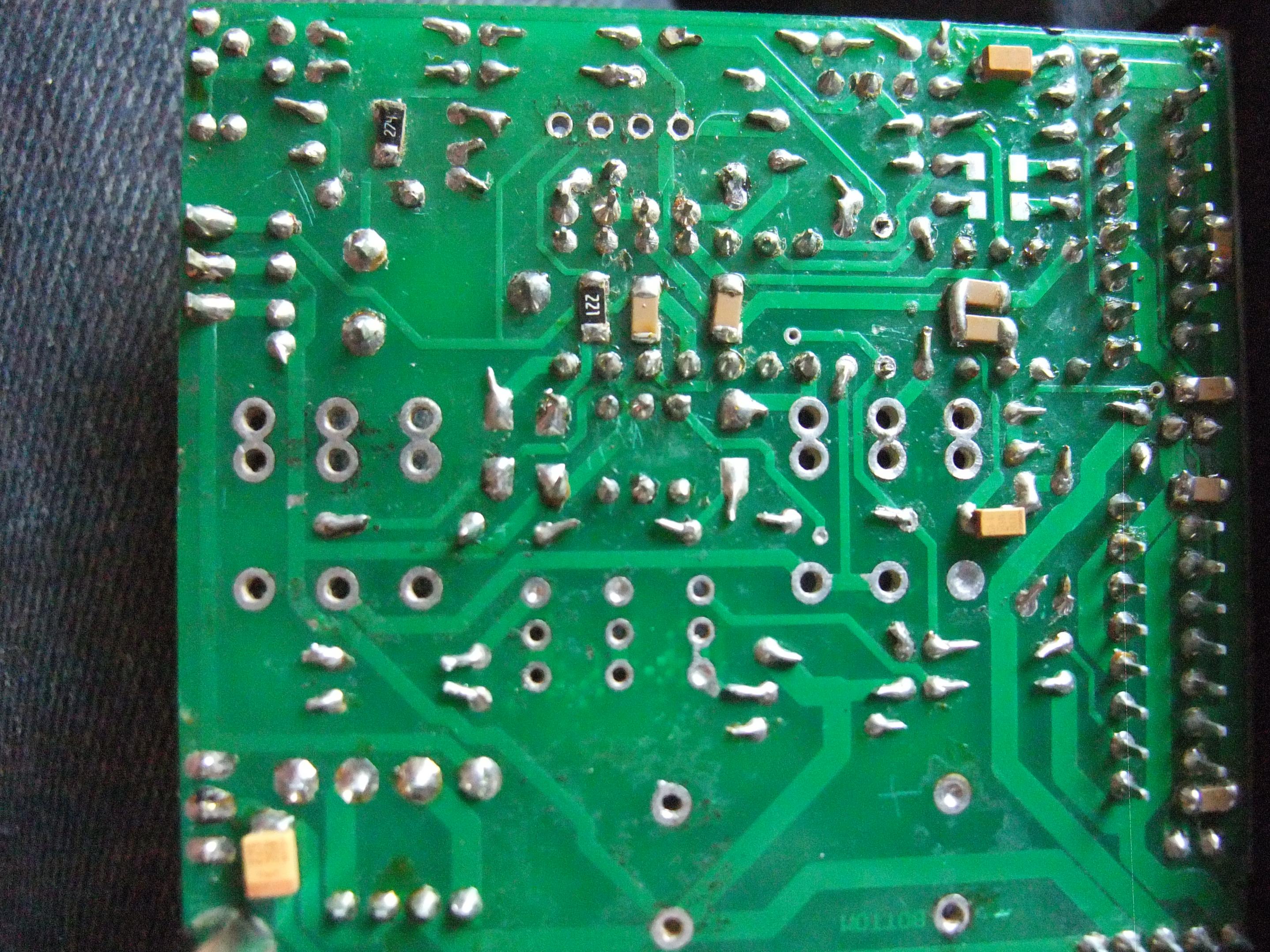

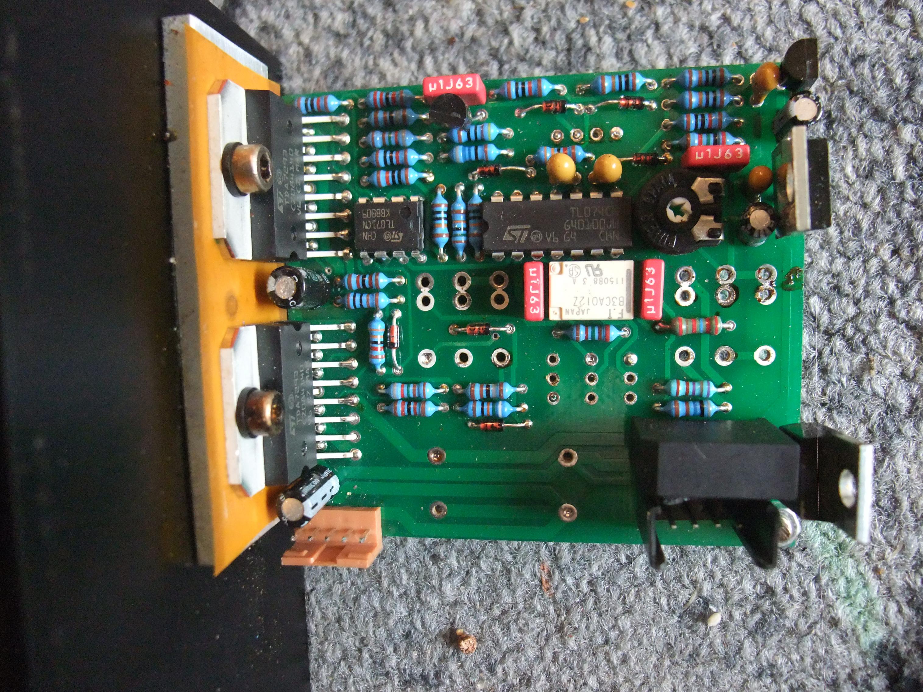

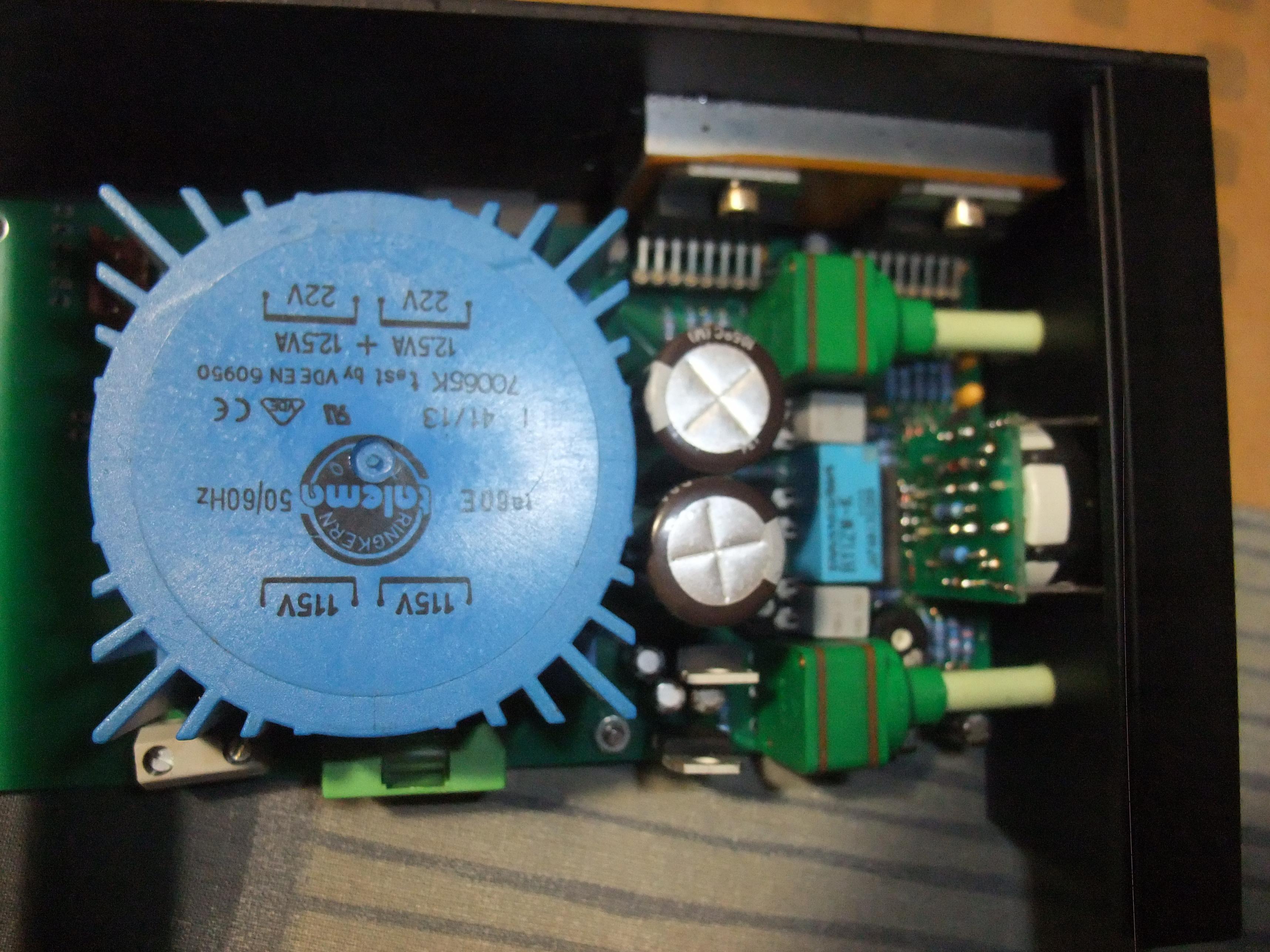

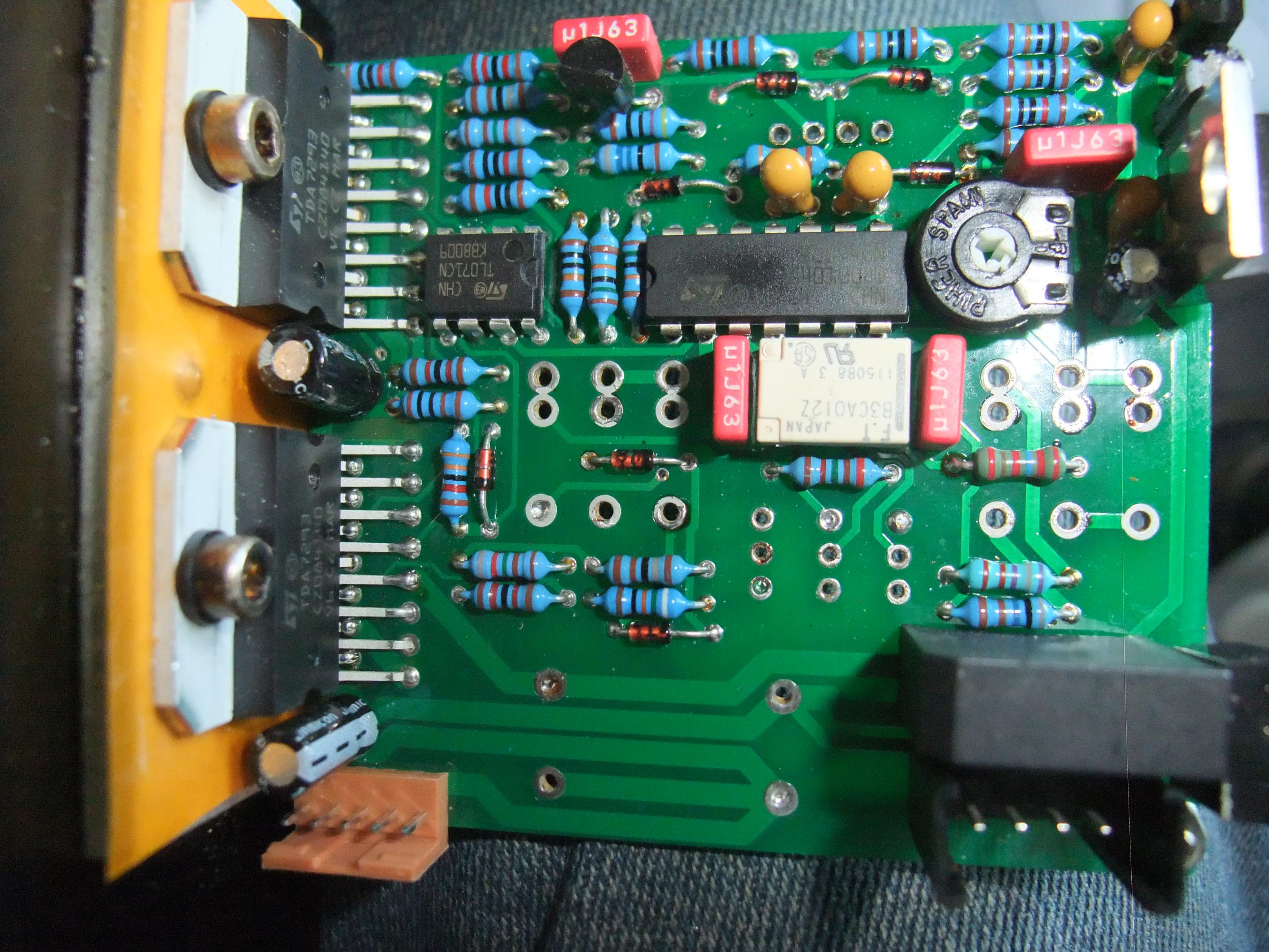

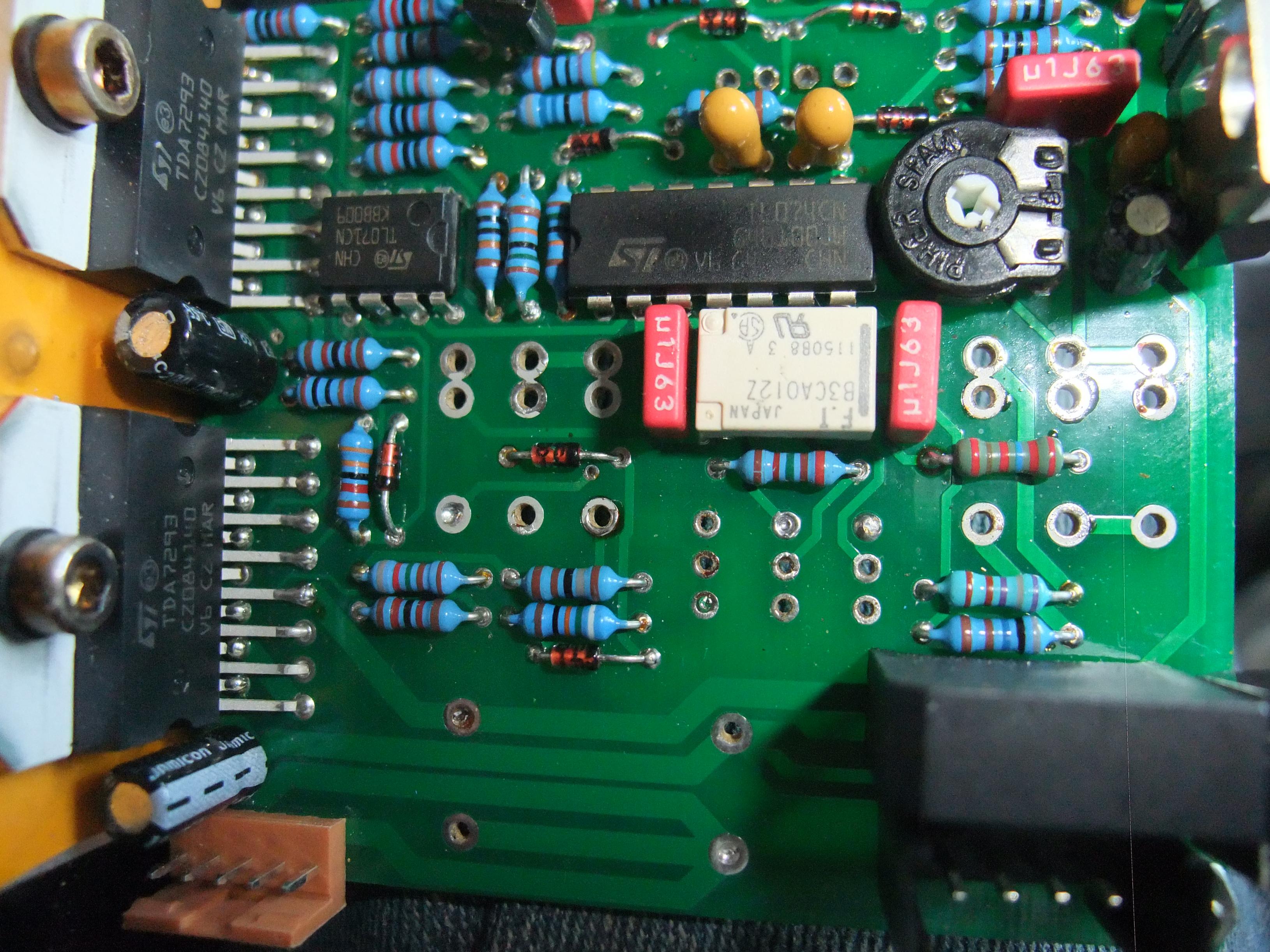

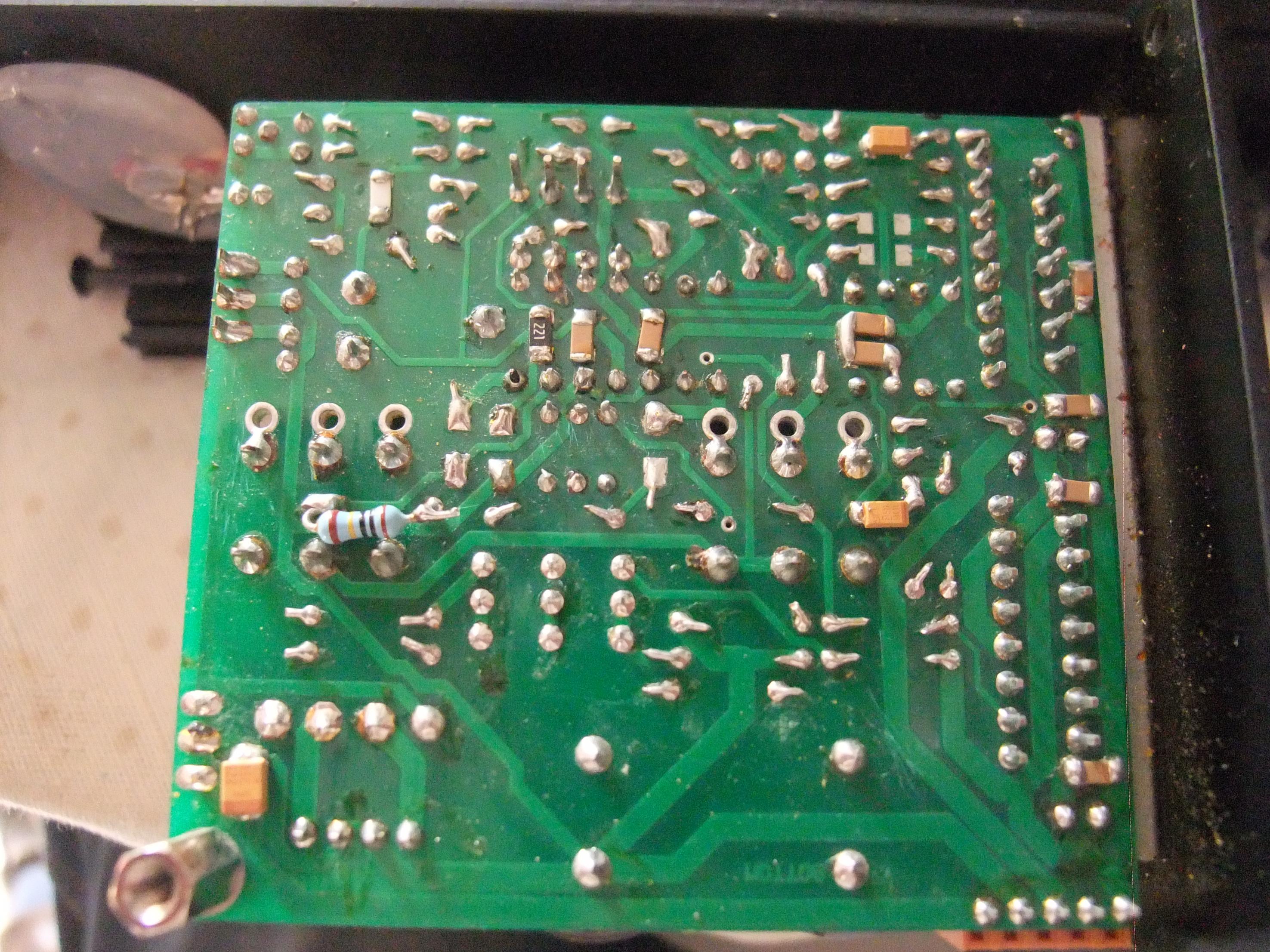

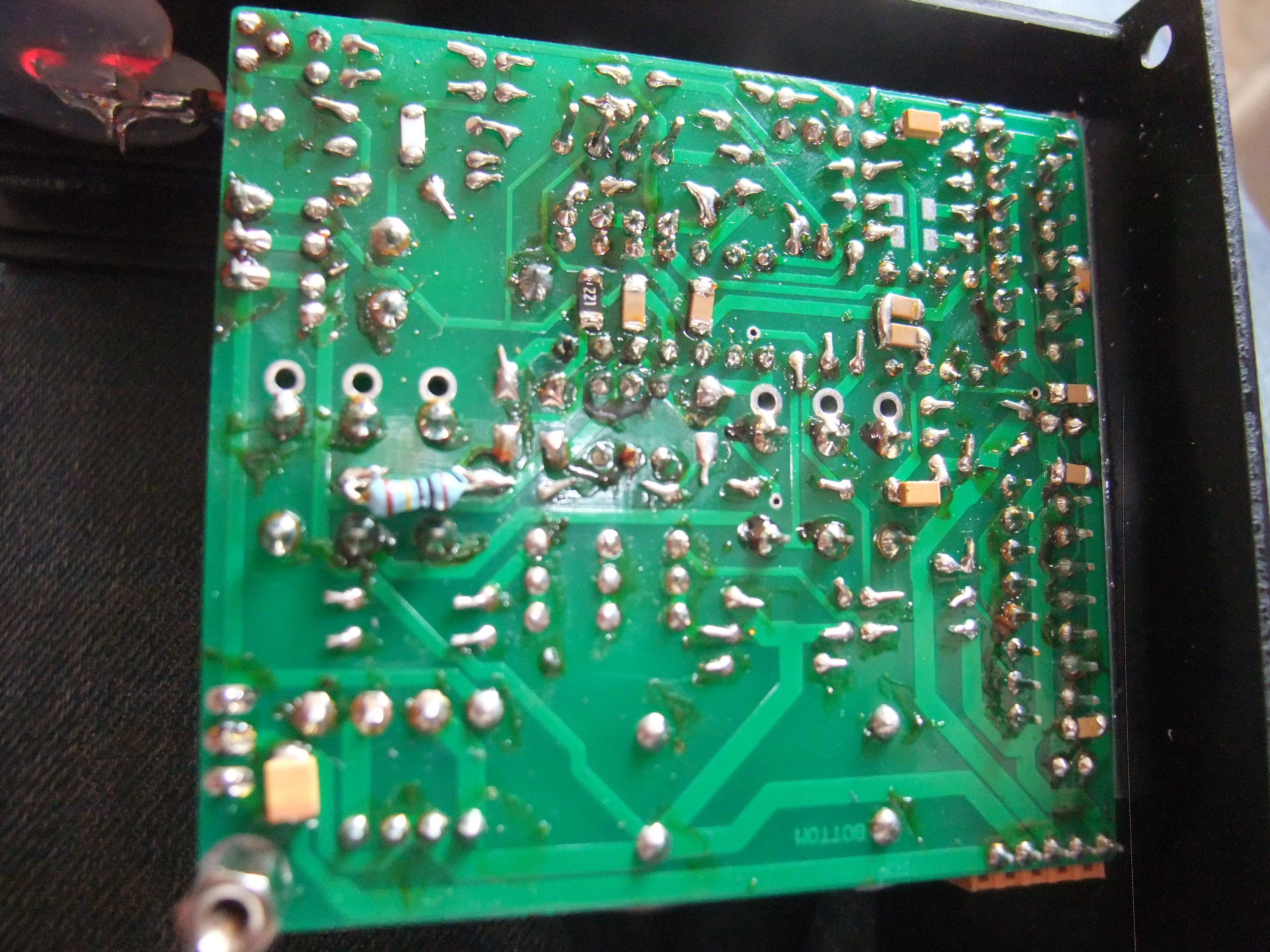

After cleaning and and re-soldering of various solder joints on solder site the motor control works now fine without any temporarily occurred unwanted effects (tested only with a single motor as to see under
Plattenspieler Motor (Rega, Linn), Hifi-Klassiker - HIFI-FORUM - first image).
the second and third image from my attachment shows the PCB after my service.
I will report concerning the results by listening test in the next weeks.

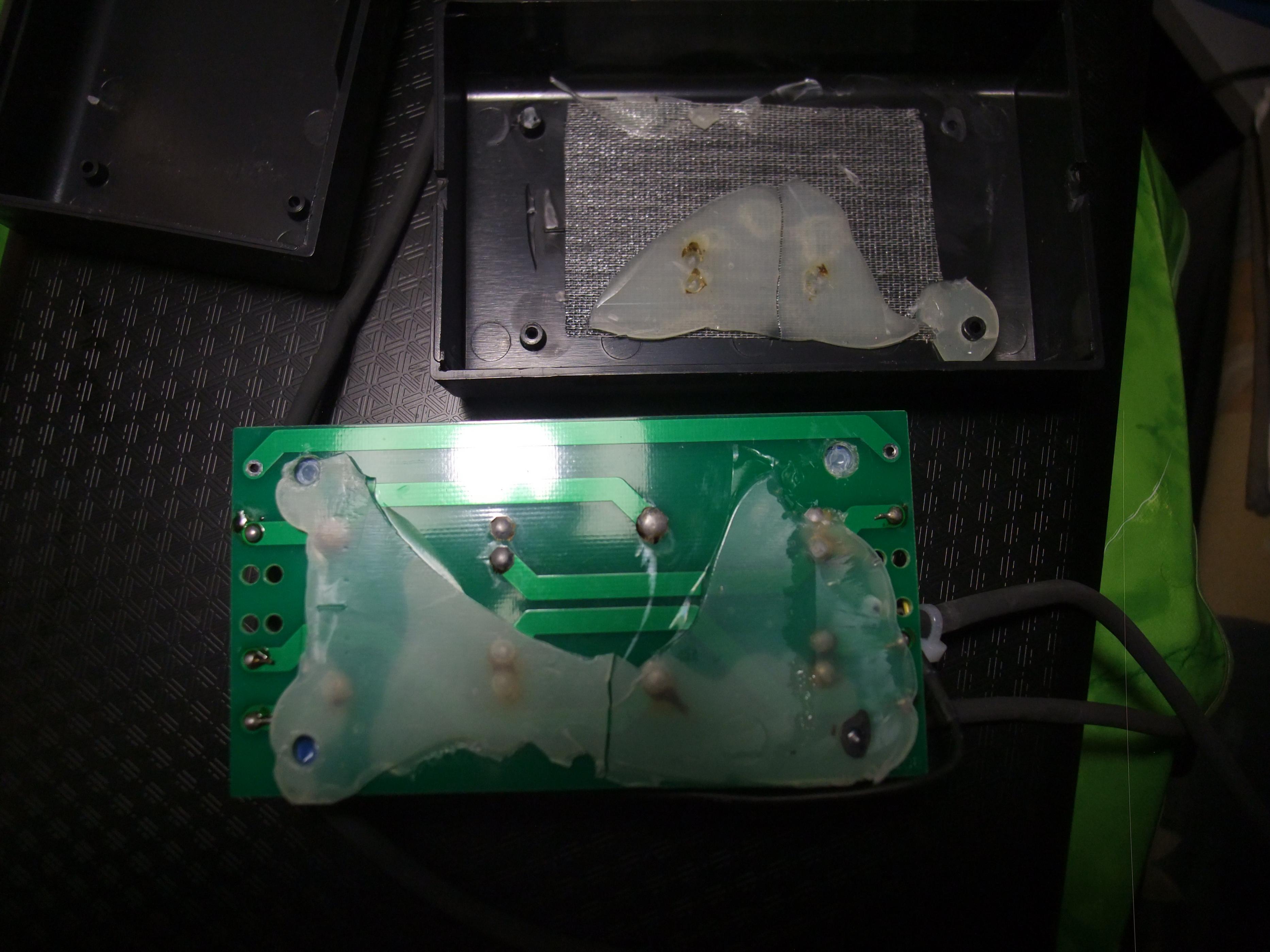

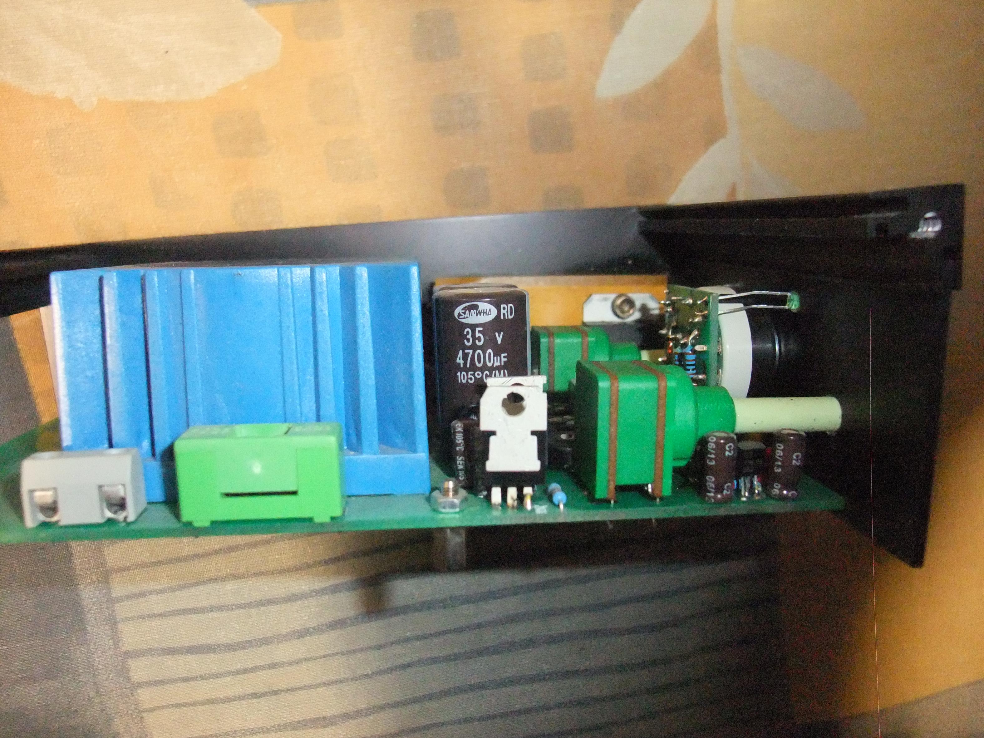

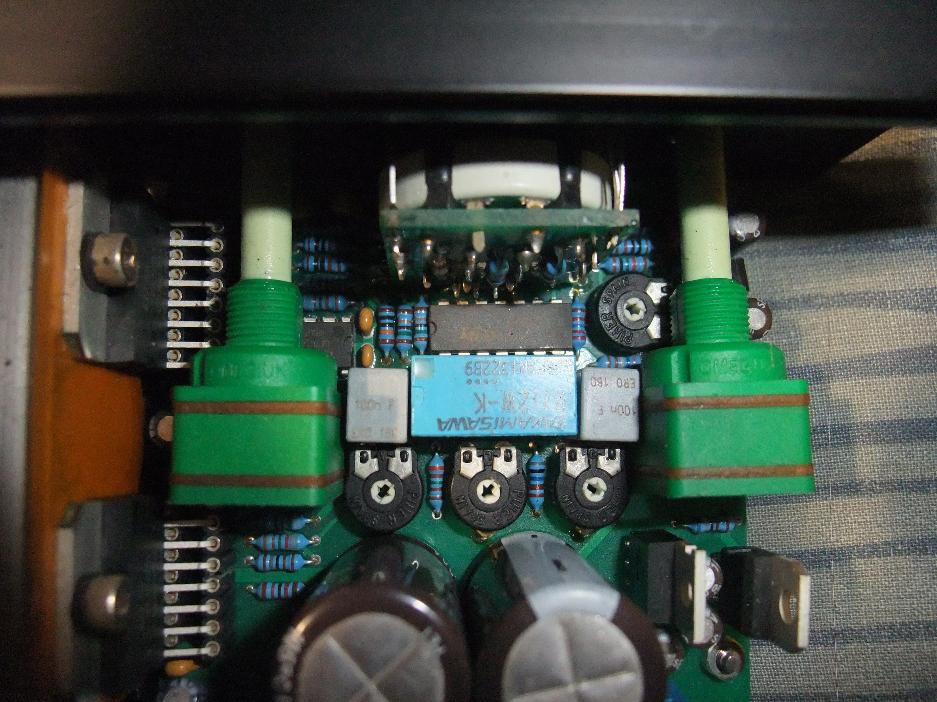

P.S.: One of both LED's (fourth image) is drawn in the wrong direction.

State variable oscillators are pretty tricky for stabilizing their amplitude without clipping the sine wave etc.
Here you can find some Theory:
http://ww1.microchip.com/downloads/en/Appnotes/00866a.pdf
Some elaborate designs to cope with stabilization while maintaining low distortion can be found in Linear technology's AN-67 Sine oscillator or in Hameg's HM8037 sine generator service manual.
https://www.google.com/url?sa=t&rct...037-serv.pdf&usg=AOvVaw2QSw8VuOY78pWGmFxlTJLx
With a little tuning of this circuit -120dB THD can be squeezed out of a HM8037.

The classic way to stabilize such oscillators is a small light bulb, as a kind of PTC for reducing gain with amplitude.
I think the BF245 has this function in your circuit (votage controlled resistor for AGC).

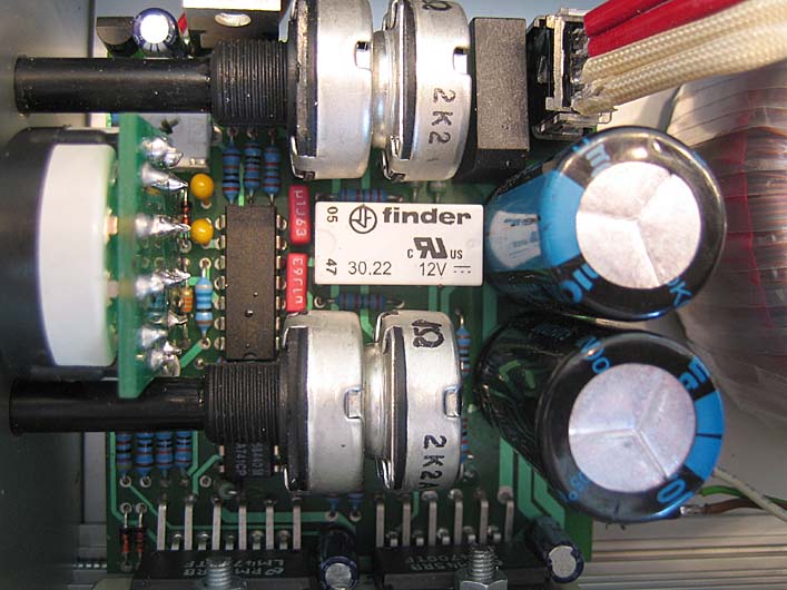

Dr. Fuß (Music Components) Genuine Device
the difference should be clearly visible. Other transformer, other PCB, other monolithic power amp IC (LM4700 instead TDA7293) and probably other schematic.

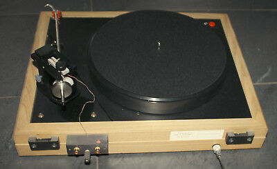

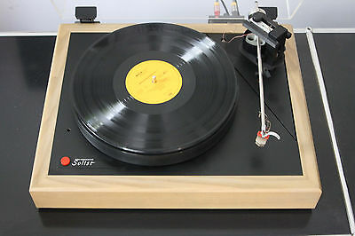

The turntable wasn't a Linn LP12 but the model "SOLIST" from the no longer exist German company "Audiokonstruktion" - go to the attached images (the same model but an other device on the images).
The used arm was a SME-V and the cartridge a three months old ART-9 from Audio Technica.
The differences in sonic quality between the Lingo and the homebrew version were largely the same as in the listening test mentioned before with LP-12.
It is very astonishing that the audible differences between the homebrew version and Linn's Axis motor control were surprisingly small (the music representation went more in breadth and a bit too little in depth) and between the LINGO and Linn's Axis motor control were very clearly to the disadvantage of the LINGO, which sounded more dynamic at first glance, but ultimately conveyed the tendency towards hardness and spatial representation appeared flat.

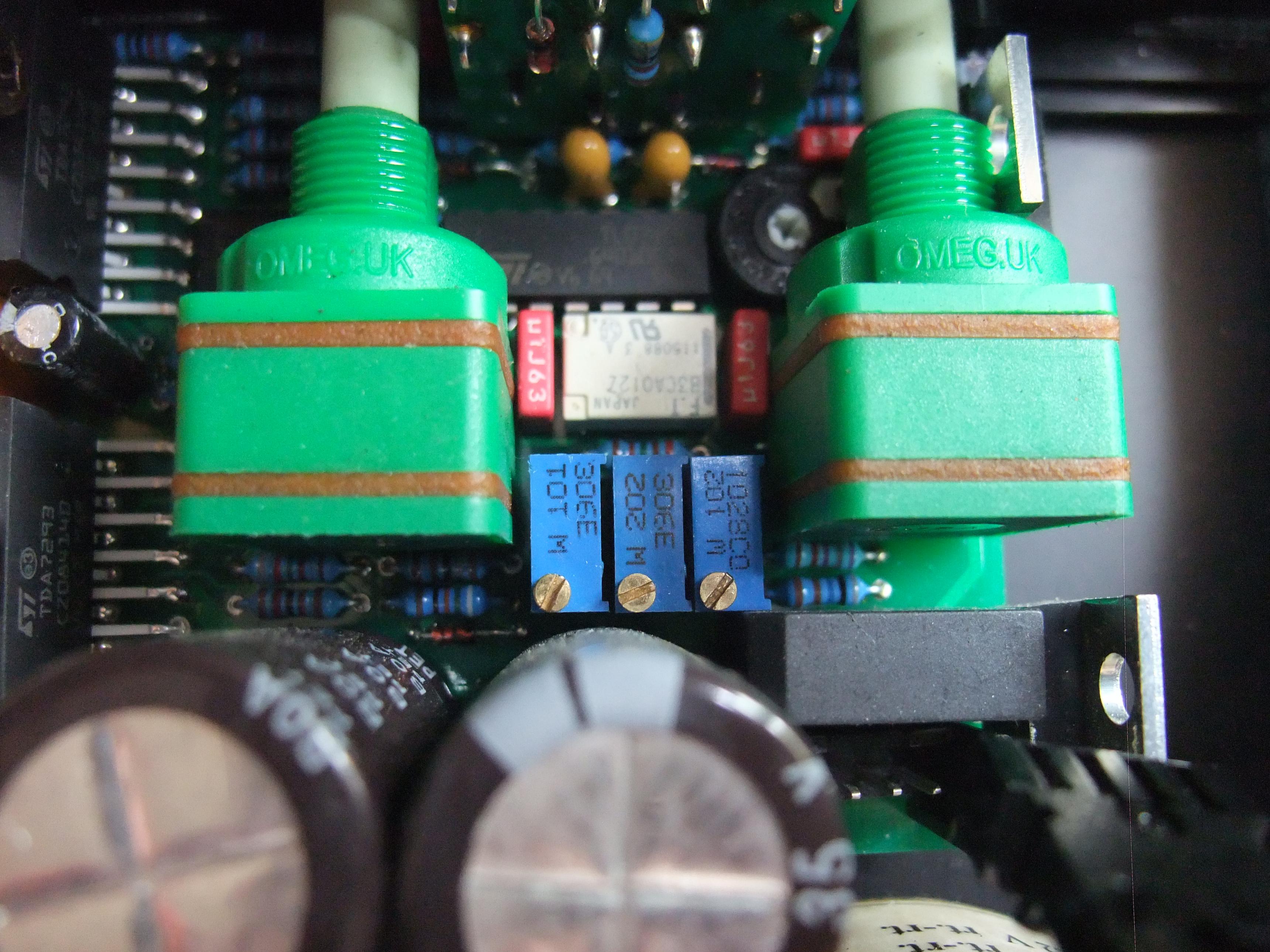

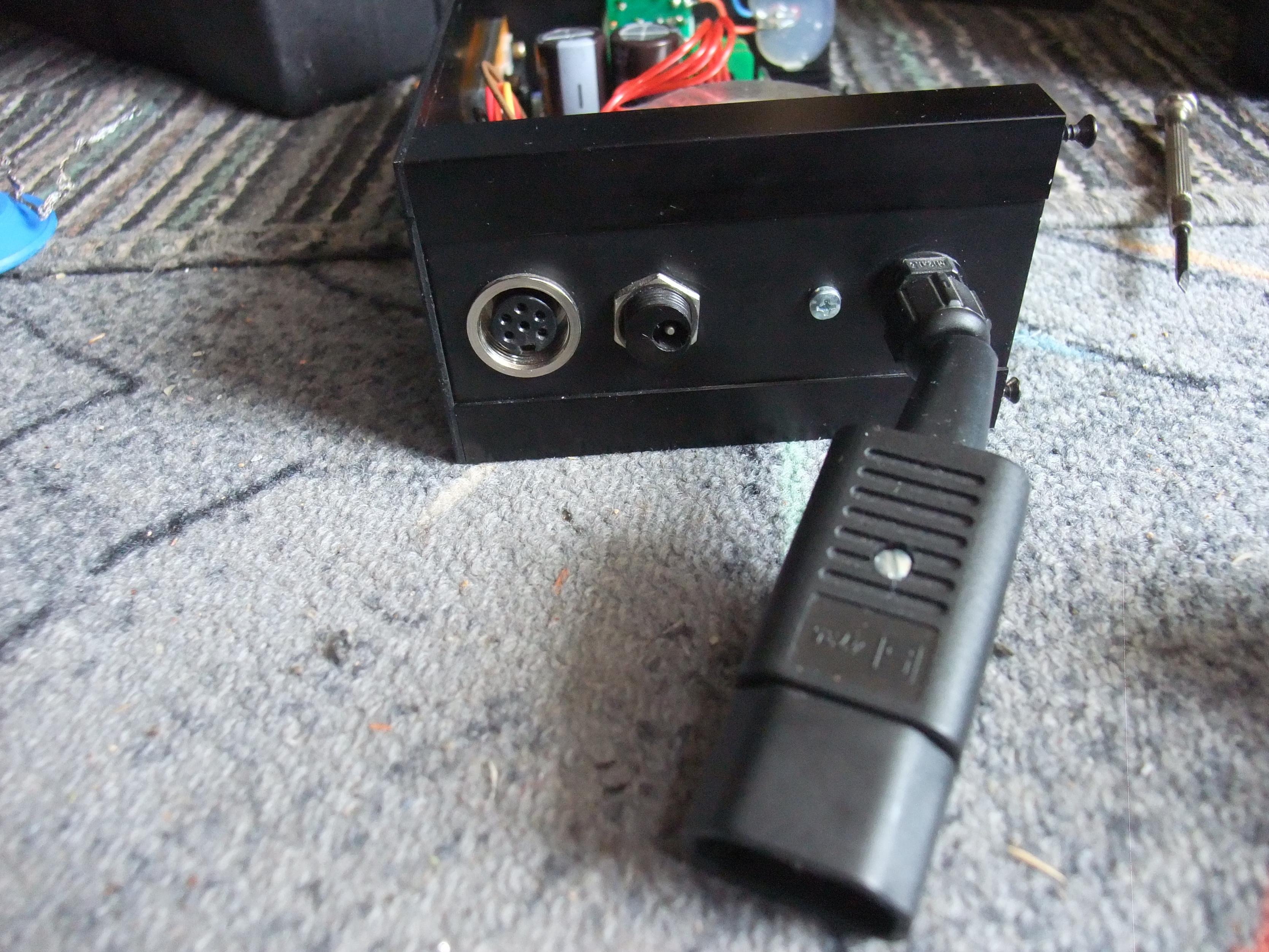

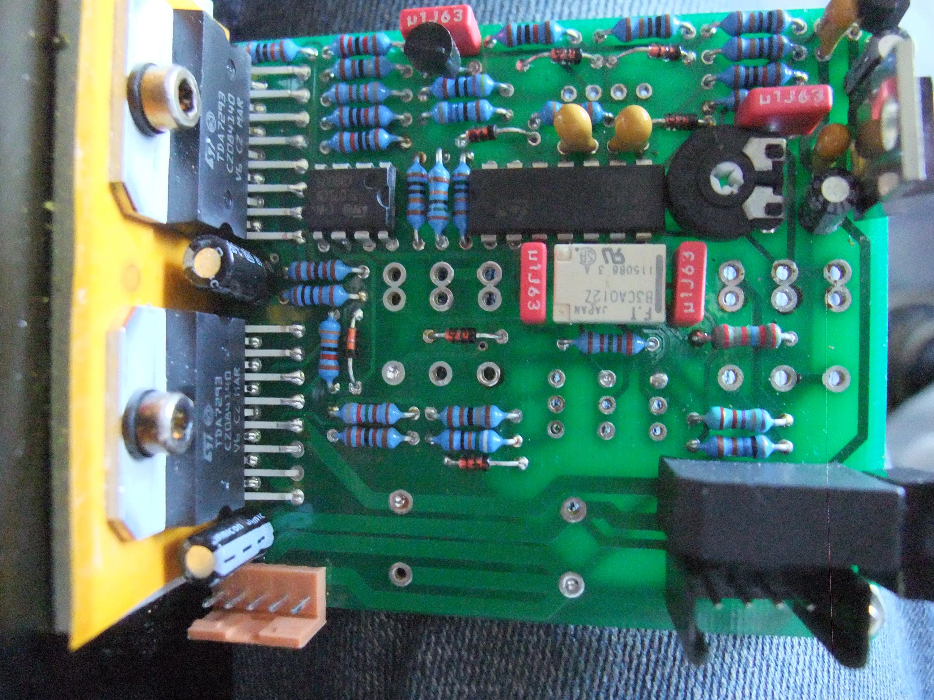

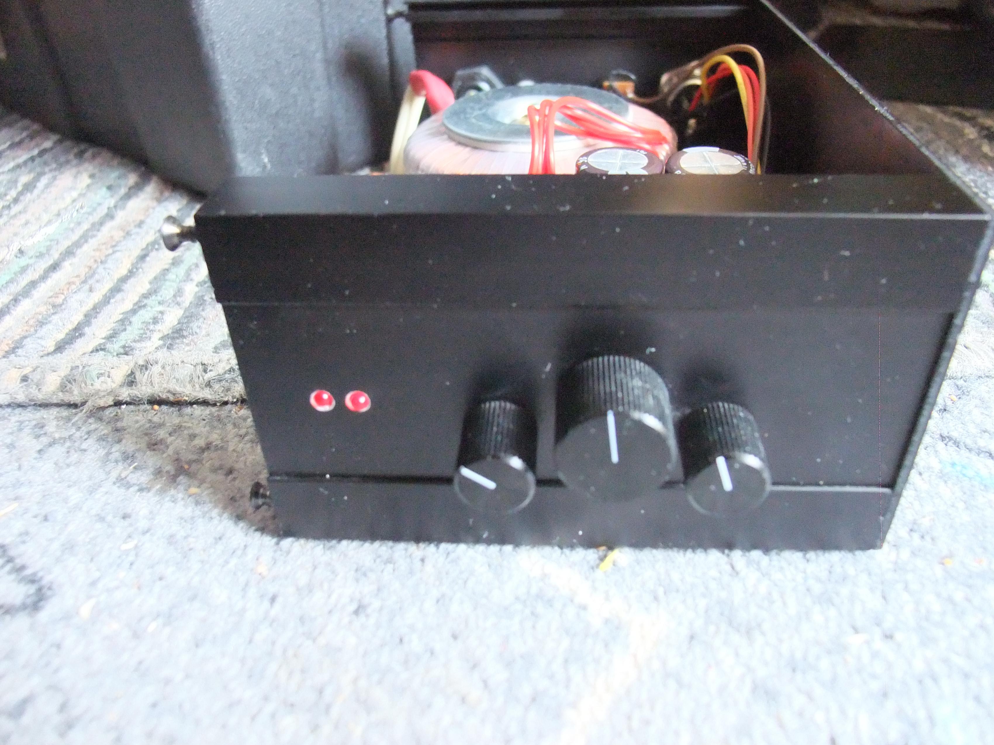

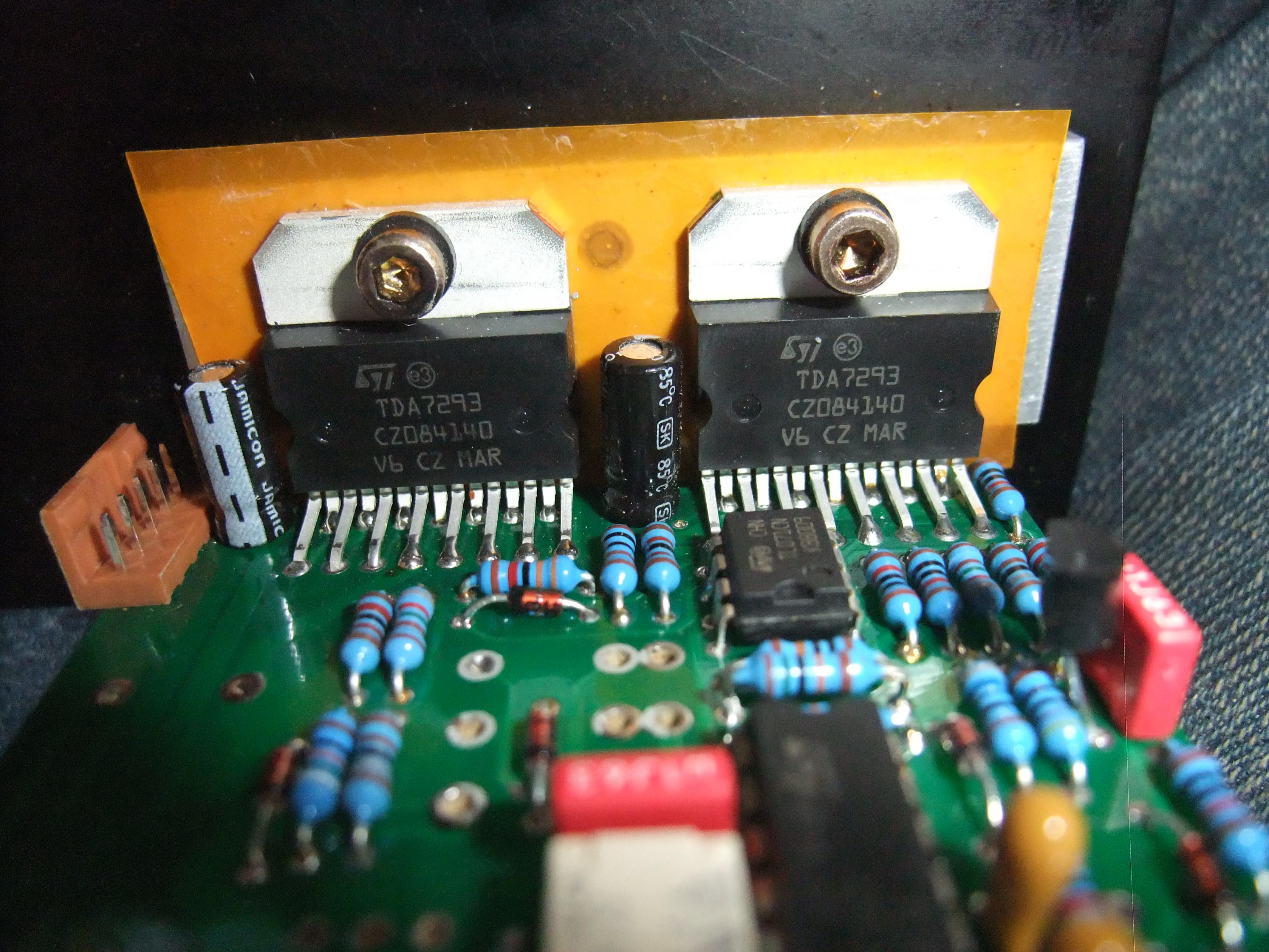

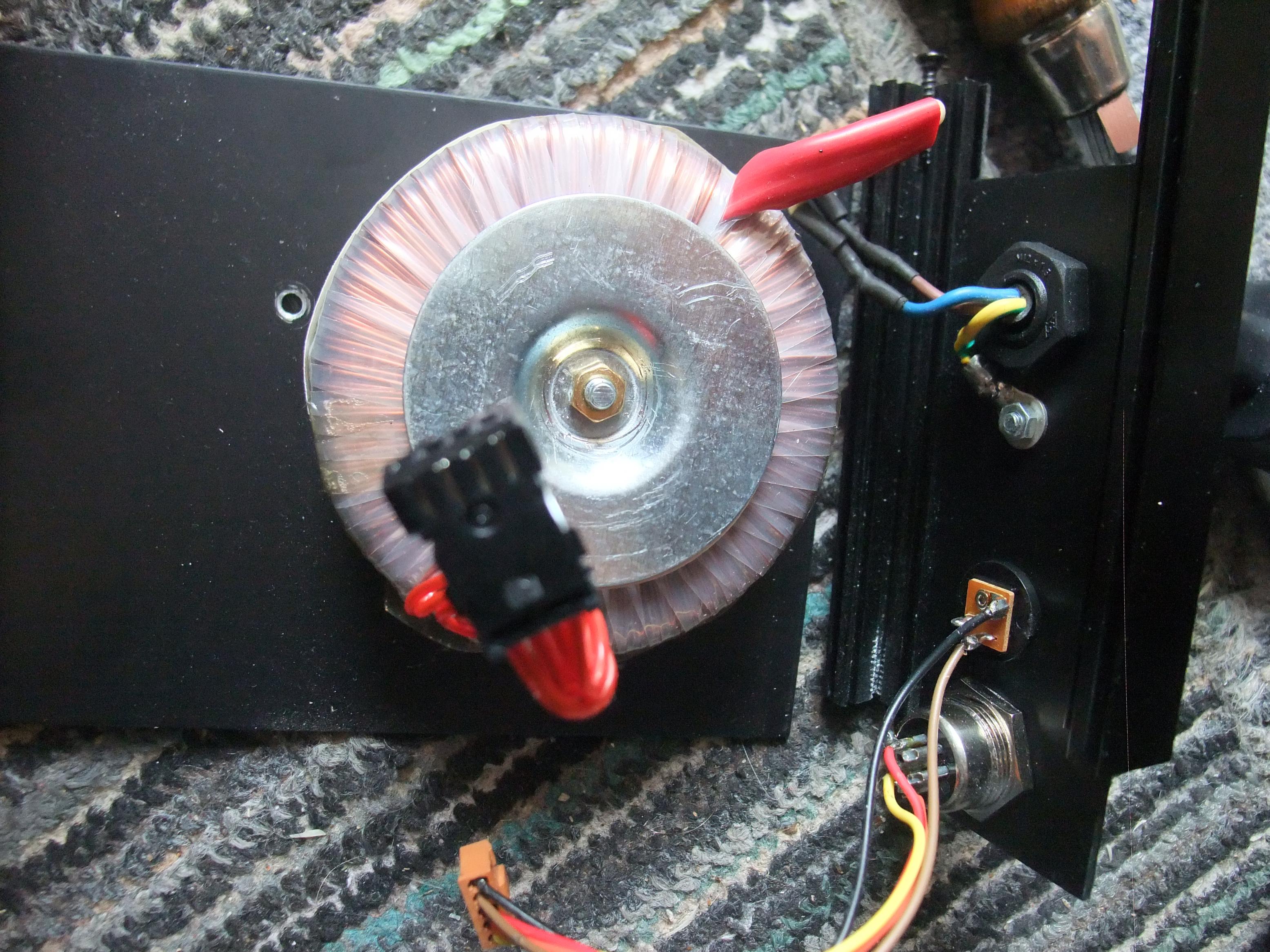

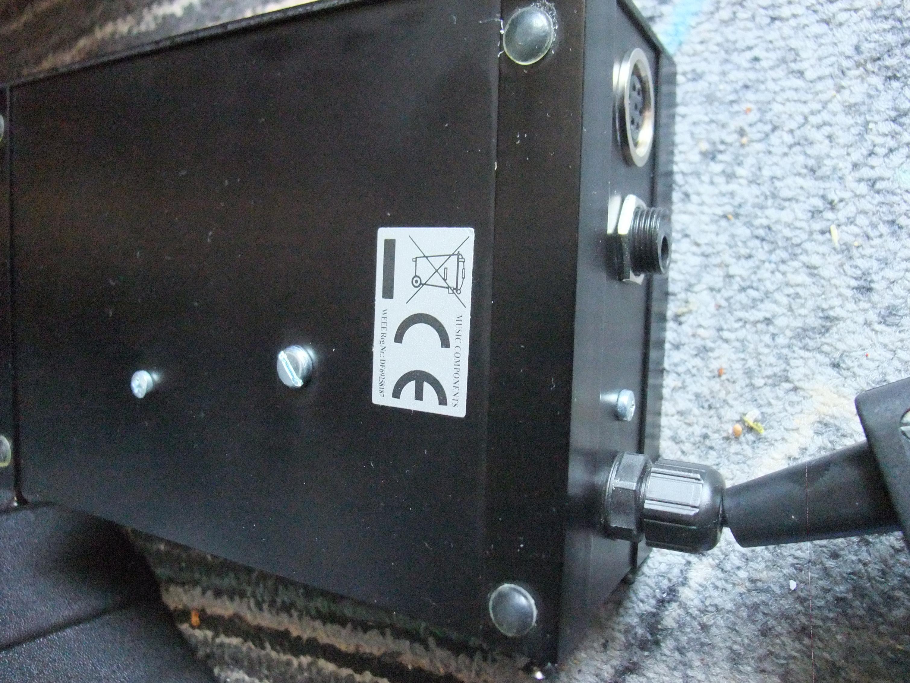

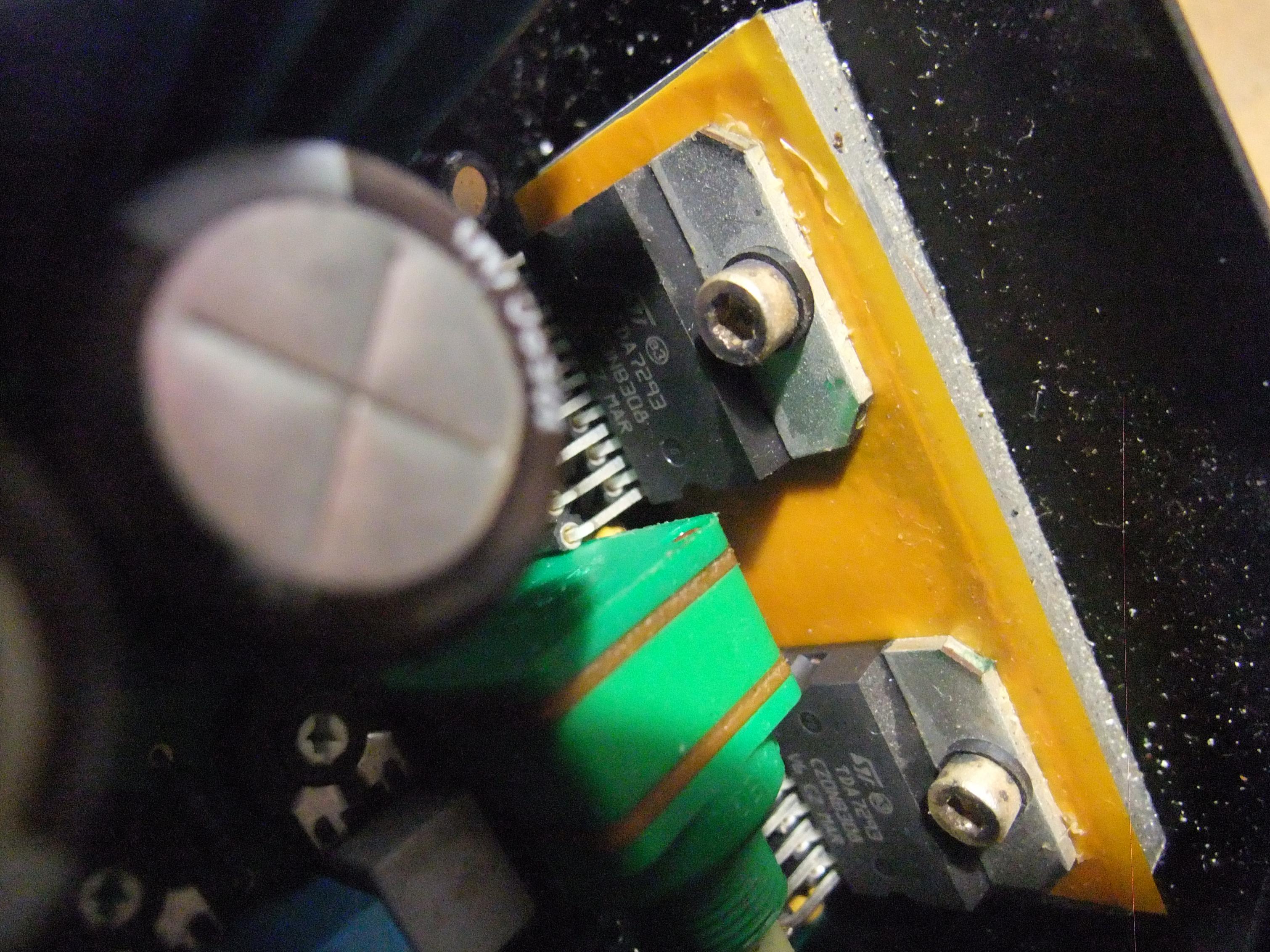

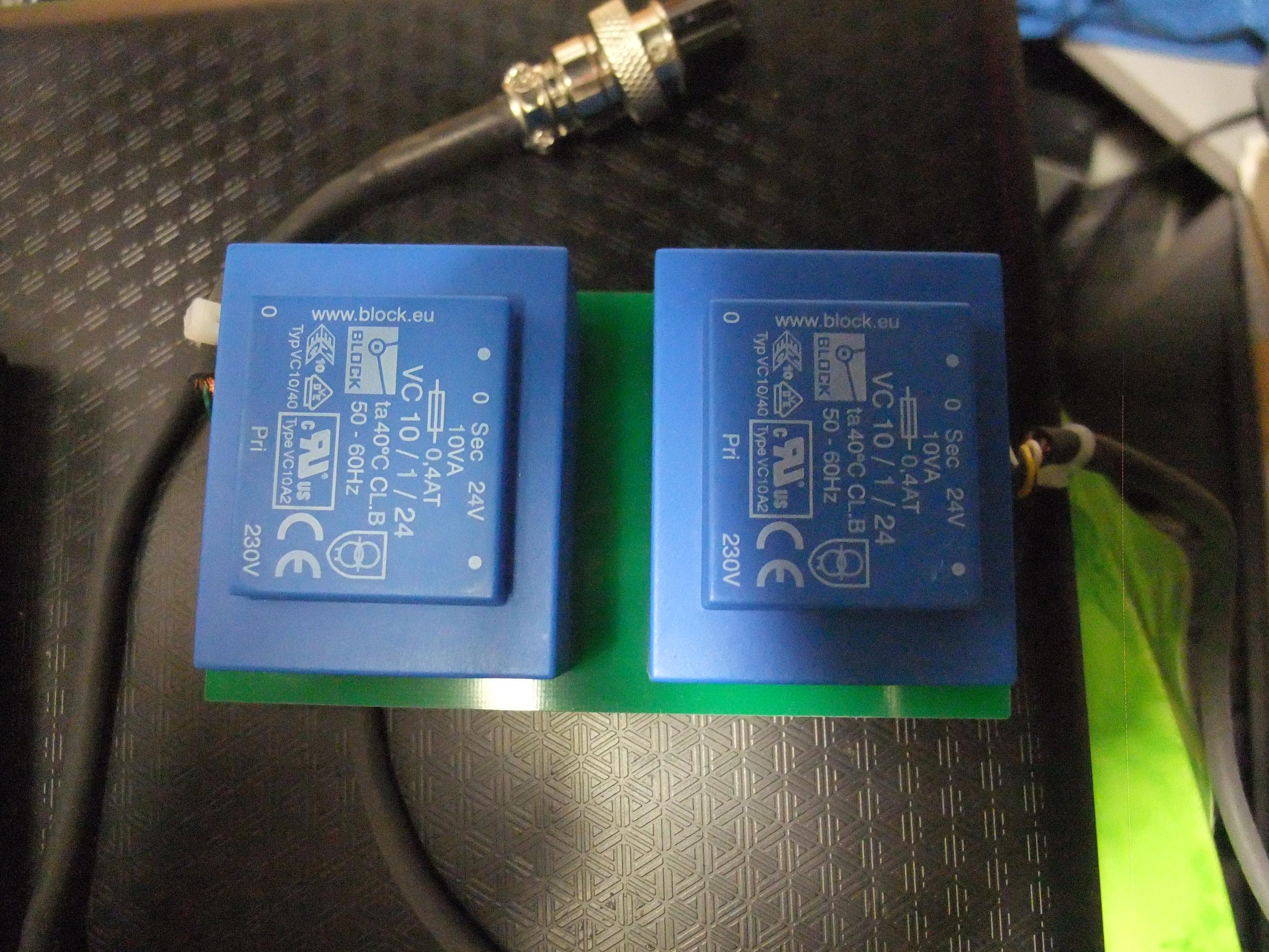

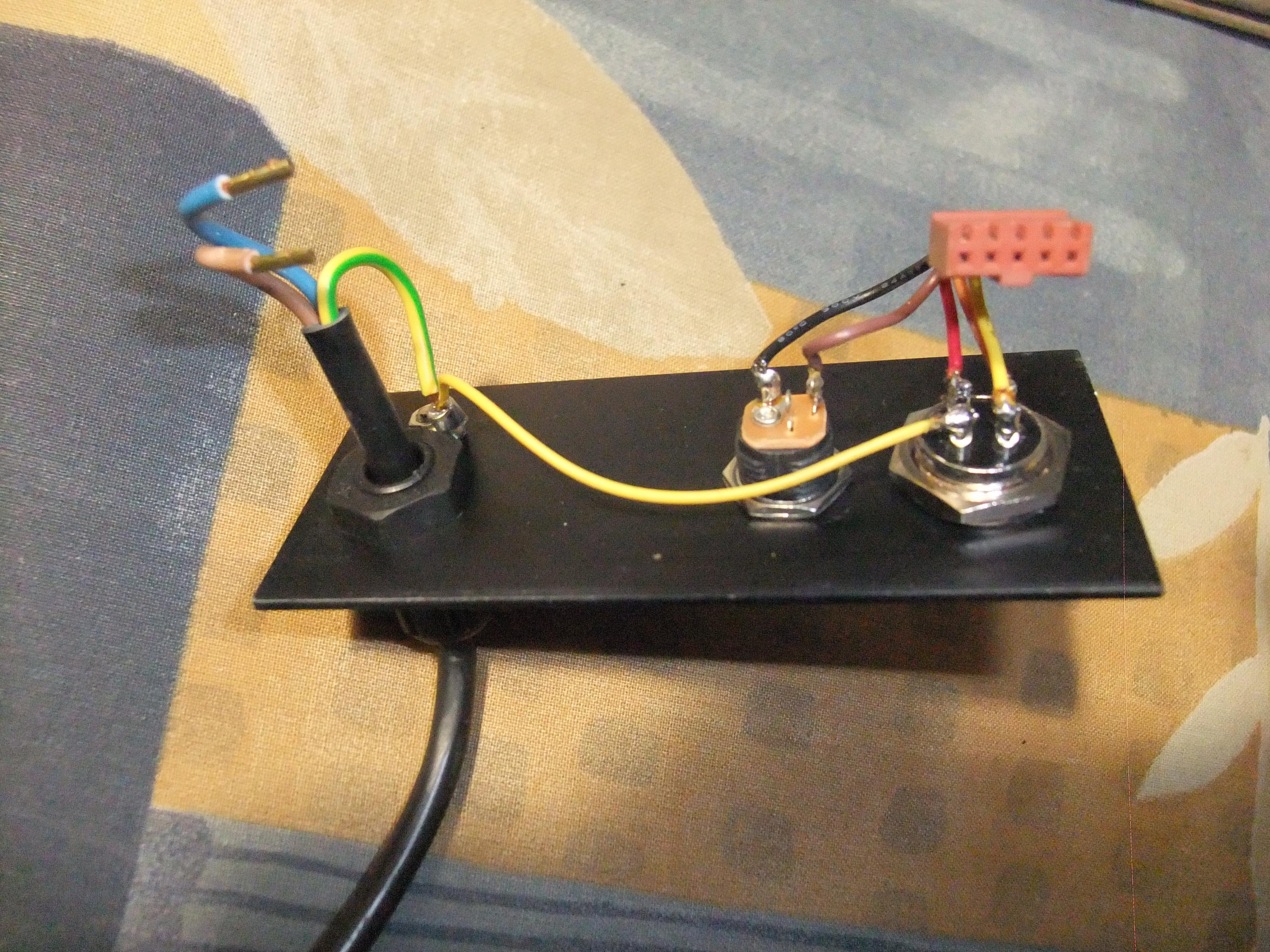

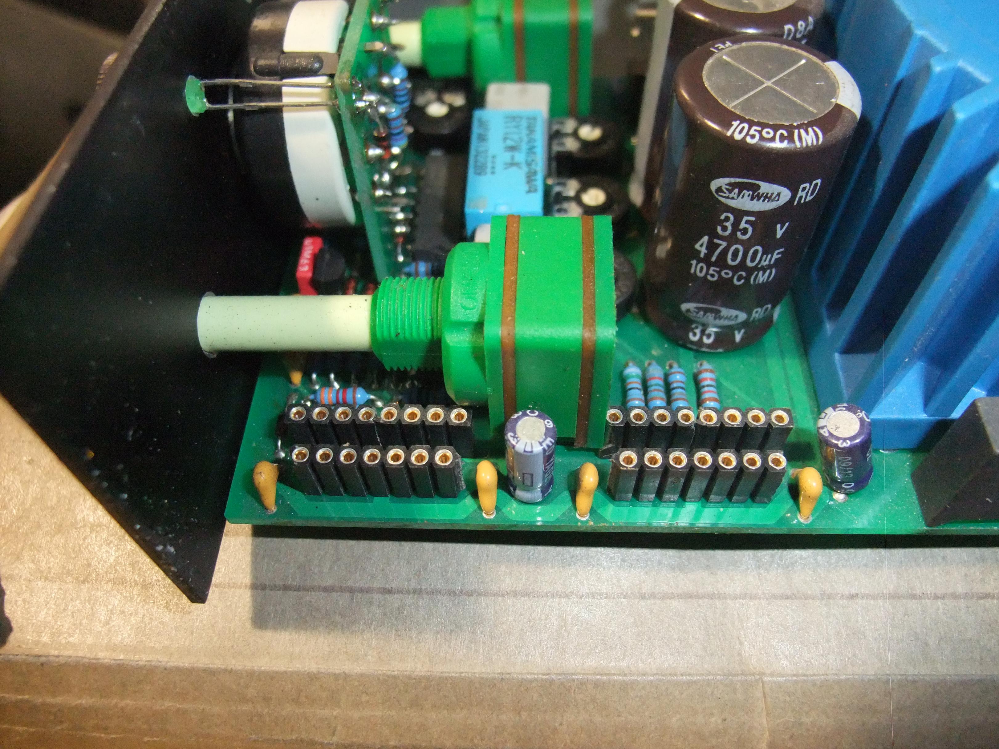

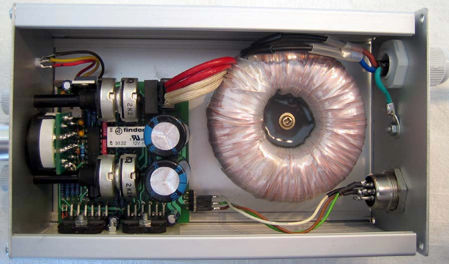

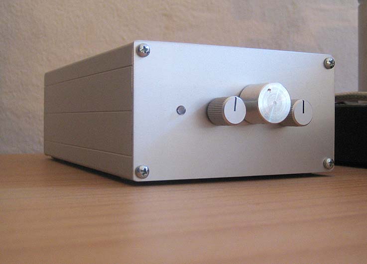

Again I got for repair a diy motor control for Linn's LP-12 looks similar but not identical to those version described in post #1

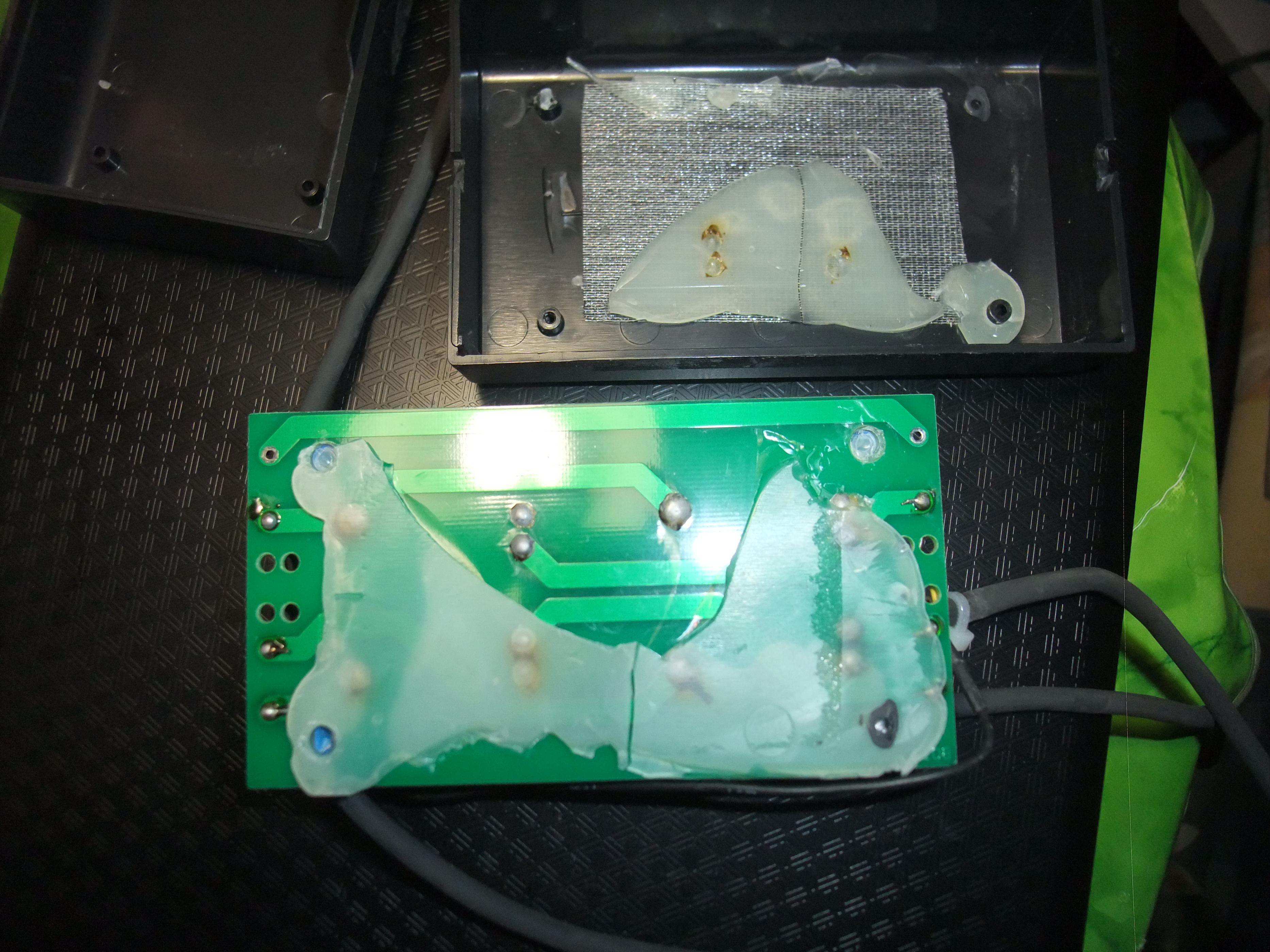

now the images of PCB before and after service.

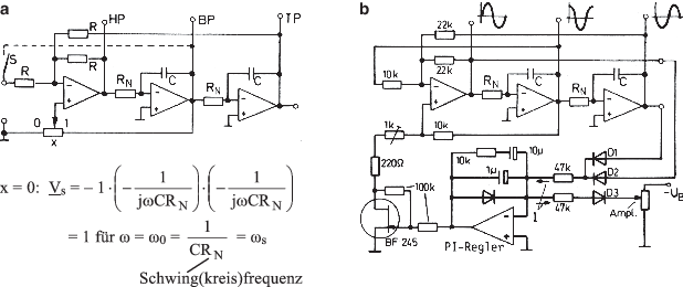

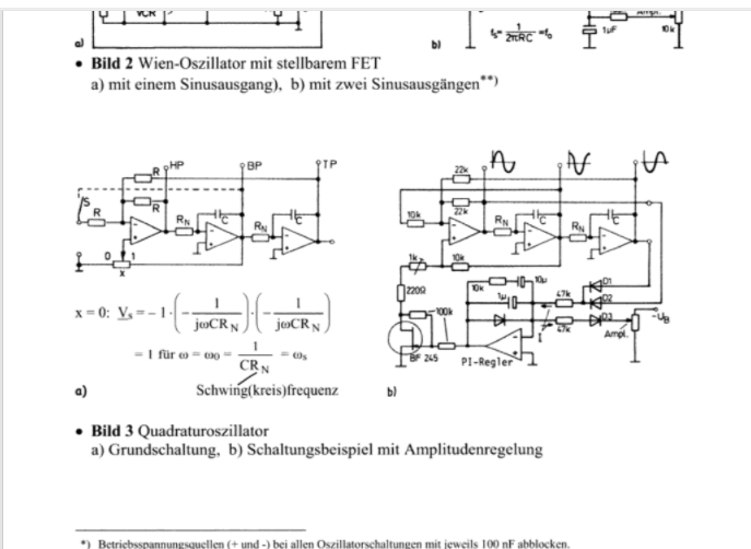

both hand drawn schematic from post #1 and post #3 (simplified schematic) contain too many mistakes.
Furthermore, the arrangement of the parts in my drawing makes it nearly impossible to understand the theory of operation according a SVF based sine wave oscillator.
By chance I have found the corresponding descriptions on the web - go to the book
Elemente der angewandten Elektronik: Kompendium fur Ausbildung und Beruf (Viewegs Fachbucher der Technik) von Erwin Bohmer
on pages 208 and209 unter
Elemente der angewandten Elektronik: Kompendium fur Ausbildung und Beruf - Erwin Bohmer, Dietmar Ehrhardt, Wolfgang Oberschelp - Google Books
and the attached files (the PDF shows my new drawing of the motor control device from my previous two posts).

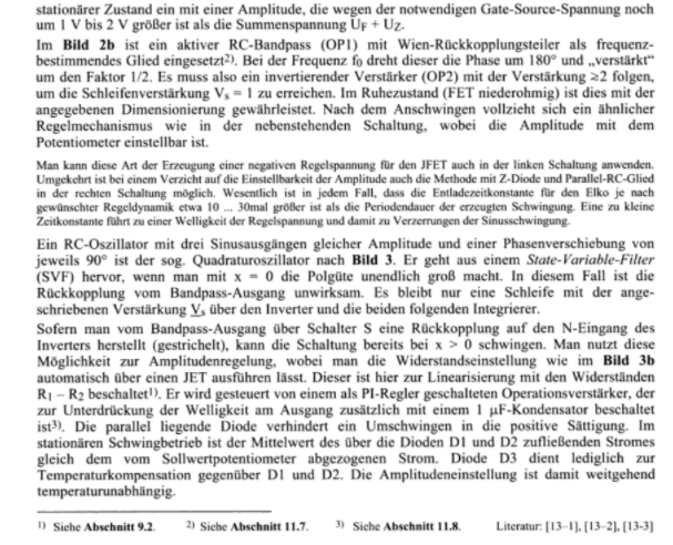

I have it translate in the english language:
1) German:
Ein RC-Oszillator mit drei Sinusausgängen gleicher Amplitude und einer Phasenverschiebung von jeweils 90° ist der sog. Quadraturoszillator nach Bild 3. Er geht aus einem State Variable Filter (SVF) hervor, wenn man mit X = 0 die Polgüte unendlich groß macht.
In diesem Fall ist die Rückkoppelung vom Bandpass-Ausgang unwirksam Es bleibt nur eine Schleife mit der angeschriebenen Verstärkung Vs über den Inverter und die beiden folgenden Integrierer.
Sofern man vom Bandpass-Ausgang über den Schalter "S" eine Rückkoppelung auf den "N" Eingang des Inverters herstellt (gestrichelt in fig. a) kann die Schaltung bereits bei X > 0 schwingen.
Man nutzt diese Möglichkeit der Amplitudenregelung, wobei man die Widerstandseinstellung wie in fig. b automatisch über einen J-FET ausführen läßt. Dieser ist hier mit den Widerständen R1 und R2 beschaltet.
Er wird gesteuert von einem als PI Regler beschalteten Operationsverstärker, der zur Unterdrückung der Welligkeit am Ausgang zusätzlich mit einem 1µF Kondensator beschaltet ist.
Die parallel liegende Diode verhindert ein Umschwingen in die positive Sättigung.
Im stationären Schwingbetrieb ist der Mittelwert des über die Dioden D1 und D2 zufließenden Stromes gleich dem vom Sollwertpotentiometer abgezogenem Strom.
Diode D3 dient lediglich zur Temperaturkompensation von D1 und D2. Daher ist die Amplitudeneinstellung weitgehend temperaturunabhängig.
2) English:
A RC sine wave oscillator with three outputs of the same amplitude and a phase shift of each 90° is the so-called quadrature oscillator as shown in fig. 3 (attached image 3+4). It is basically a state variable filter (SVF) when the pole quality is infinity with X = 0.
In this case the feedback from the bandpass output is not present. Only one loop remains with the indicated gain Vs via the inverter and the two following integrators.
If a feedback is established from the band pass output via switch "S" to the "N" input of the inverter (dashed line in fig. a, attached image 3+4), the circuit can already oscillate at X > 0.
This option of amplitude control is used, with the resistance setting as shown in fig. b can be carried out automatically via a J-FET. This J-FET is additional equipped here with the resistors R1 and R2. It is controlled by an operational amplifier worked as a PI controller, which is additionally wired with a 1µF capacitor to avoid the ripple at the output.
The parallel diode prevents shifting into positive saturation. In steady-state oscillating operation, the average value of the current flow through both diodes D1 and D2 is equal to the current drawn from the setpoint potentiometer.
Diode D3 is only used for temperature compensation of D1 and D2. The amplitude setting is therefore largely independent of temperature.
I don't understand the marked terms both in English and German exactly.
The main question in the moment is in this case, how is to adjust Tr 4 - go to the attached PDF of my drawing. Because this part is defective resp. faulty, I don't know the original position.
1) German:
2) English:
