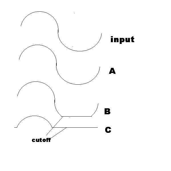

the 3 basic classes of amplifiers are as follows:
Class A:
the amplifier device (transistor, tube, etc...) is within it's conduction range for all 360 degrees of the input wave form. this applies to preamp circuits, power amp circuits, and even RF linear amplifiers. used a lot in audio
Class B:
the amplifier device is within it's conduction range for less than 360 degrees, but more than 180 degrees of the input waveform. this applies to positive and negative halves of most audio power amps, and to fuzz boxes (the device is driven between saturation and cutoff). used a lot in audio
Class C:
the amplifier device is within it's conduction range for less than 180 degrees of the input waveform. this is usually only applied to RF power amplifiers, with a resonant circuit "reconstructing" the rest of the sine wave. sometimes also used for generating short pulses from a sine wave source. HARDLY ANY USE IN AUDIO
shown below are input and output waveforms for A, B, and C class amps.
