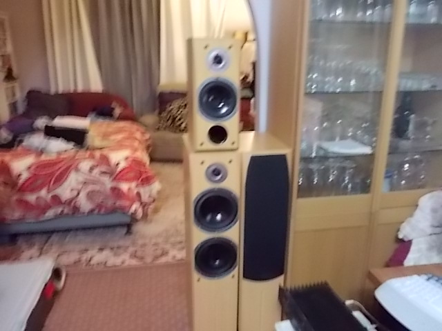

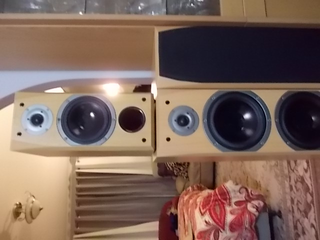

Last week I got one of those eBay emails telling me about a Sansui listing and I put in a bid thinking I was bidding on a dual 6 inch woofer speaker
I won the auction with an $89- bid and on picking them up they are actually a dual 8 inch woofer\
Usually cheaper speakers are made with 4R woofers in series to get a nominal 8R impedance but these have 2 * 16R drivers in parallel
Bass in the bigger boxes is better as I would expect but the upper midrange is a little muddy compared to the smaller speakers even tho the bigger speakers have better grade of components.
I am seriously considering using the bigger boxes for the bass and a pair of the 6 inch boxes as the dedicated midrange and moving the better tweeter to a pair of the smaller boxes with the 5inch drivers [ cheap 20mm tweeter]
Thoughts?
At the cheapest I can just use a decent coil and use them as a .5 set of woofers
Maybe even 2 coils each with different values to really boost the lower bass?
Big boxes are 1100 tall / 225 wide and 380 deep
16mm chipboard but 25mm front baffle and reasonable bracing

Things must be busy in the workshop this W/E
I expected a few posts telling me to make a proven design or similar.
This is only for Home Theatre so I am prepared to settle for a lot less than near perfection
Not much time or money to spend on these as we still haven't finished our major renovation on the bedroom/ensuite and kitchen so near enough will have to be good enough
Book values XO at around 300 with a second order electrical or throw all caution the to winds and simply use a cap in series on the midrange and one coil on the paired woofers?
My initial thoughts were to use a second on the mid box and a two part first order on the woofers but component values on 16R drivers are quite high

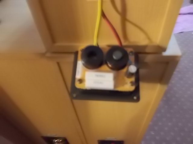

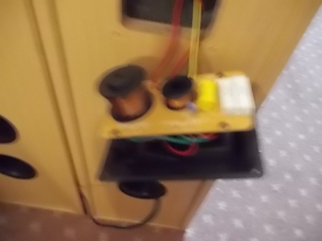

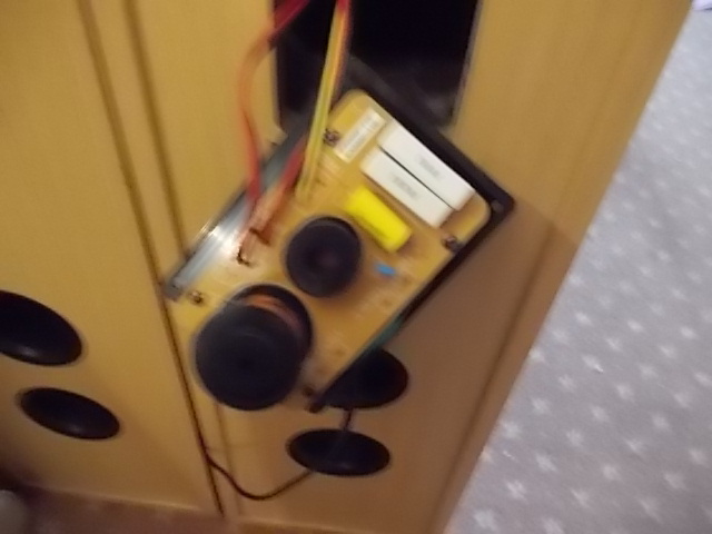

I've just pulled all the XO's out of the boxes and checked them
XO for the 25mm tweeter is the same in all boxes [ which makes sense as it is the same tweeter] 3.3uF in series and a 0.31 coil shunted to ground
Attenuation network is 1R5 in series and 15R in parallel
The big difference between boxes is the capacitor quality MET 250V in the bigger boxes and an electrolytic 100V in the others
DCR in the series coil is on the high side at 0.83R tho and that could be robbing a dB or two
Re is 5.6R on the 6 inch but if possible I'll go lower than 500 / 300Hz preferred with a first order on the woofers
33uF in series and 4mH shunt?

Works OK with the solution you suggested
not Hi-Fi but good enough for movies
Second order cleaned up the vocals really quite well but the bass unit is still a little too much mid coming through with just the 5.6 coil in series
Some stuffing in the tops should help as well
I'm wondering if volume filling the bass boxes would have any real effect on the bass tuning?
Playing with various cap values and resistors while I listen to music
47uF seems to work
